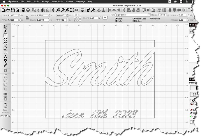

How can I make this design with a different name and date?
You may want to begin by explaining the problem you’re experiencing.
Do you mean something like this?
Having the text join the rectangle shape is done using our ‘Boolean’ tools, which you can read about below:
The video linked there is also worth review. :slight_smile:
