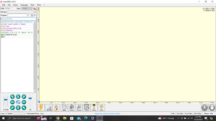

Please try to get the LaserGRBL screenshot please. Does the laser home every time $H is initiated?
Ok. I’ll work on it tomorrow and try to post it. You can respond whenever you get a chance. Thank you…

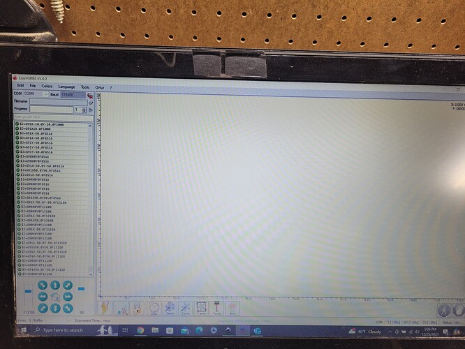

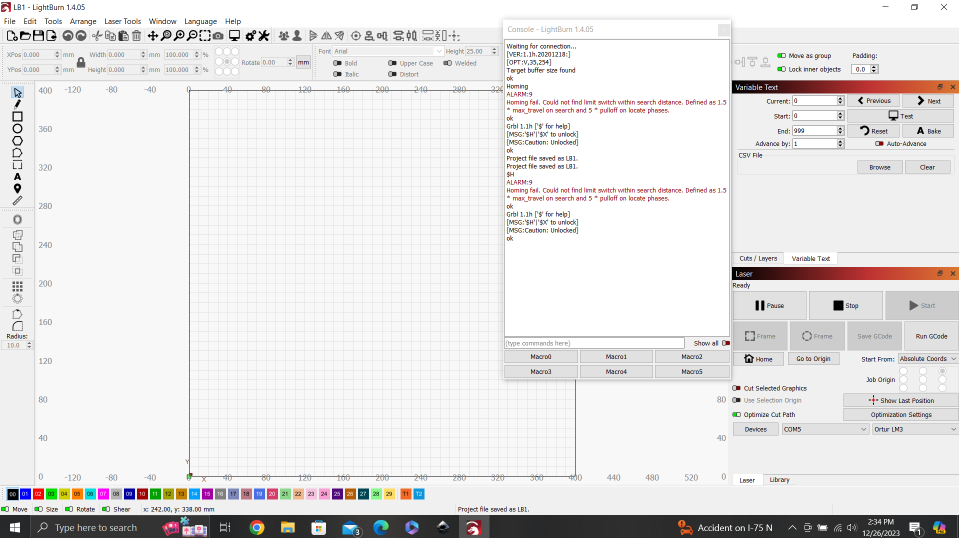

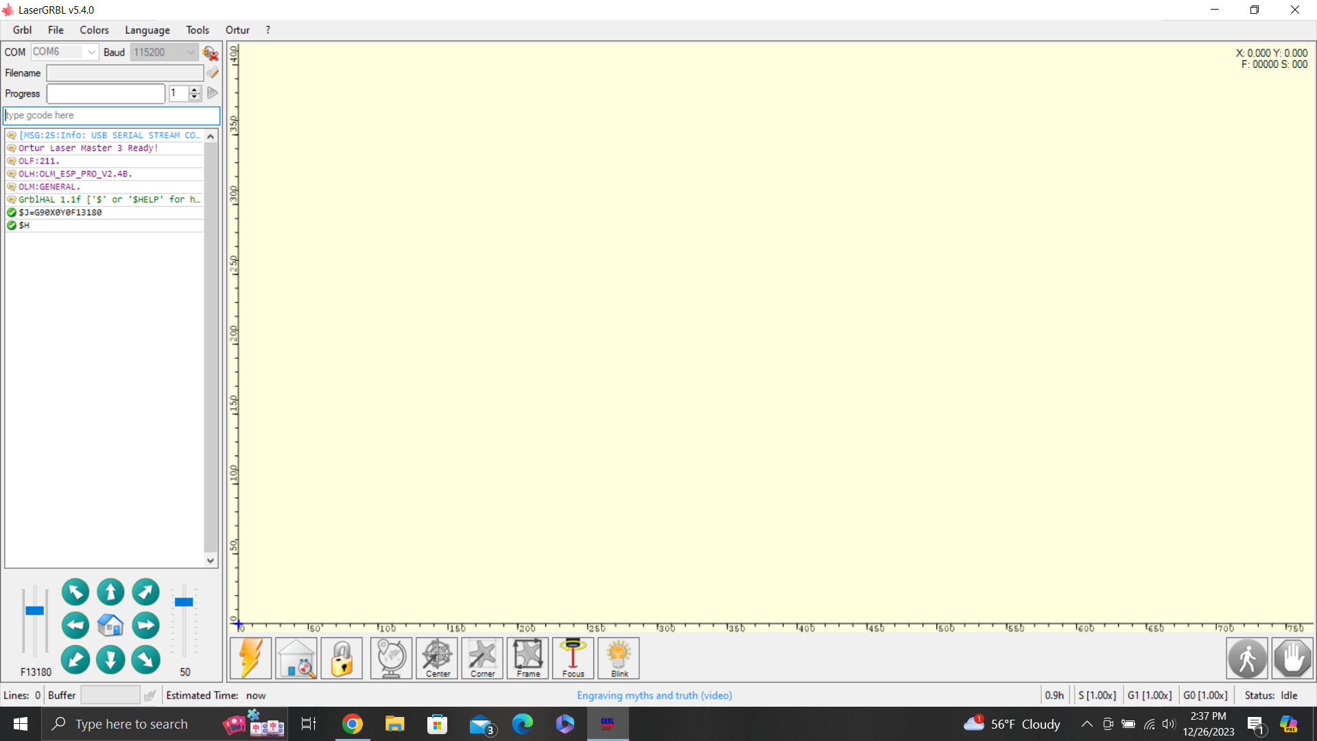

Ok. Sorry for the delay, Christmas and all. im sending a few attachments. They are screenshots of LB upon login and then laserGRBL on login.
Are you absolutely certain you’re connecting to the same machine for both of these?
It looks like to me you’re connecting to one machine in LaserGRBL (COM6) and another in LightBurn (COM5). The welcome messages are different for each machine. One is running grblHAL 1.1f (the OLM3) and the other is GRBL 1.1h (unknown).
Do you have another laser connected to the computer?
If so, that would explain all the fuss. Try switching to COM6 in LightBurn.

In Laser window, explicitly select COM6.
HOLY CRAP, I’m kicking myself. Unplugged the cnc and plugged the laser into that com port and lightburn is working as it should, perfectly. Have no idea how the com ports got crossed but that was the whole problem. Thank you, thank you, thank you… i really appreciate you hanging with me through this.
