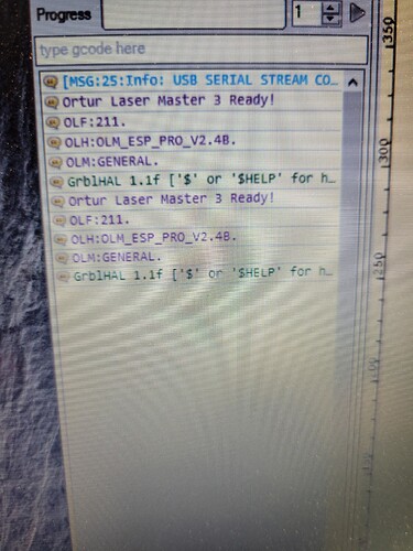

My consol window is showing a bunch of information. I’ll upload a screen shot when i get to my shop in the morning. I do remember getting an error 5 or 9 (got either, or at different times), saying it can’t home. I have the ortur lm3 which doesn’t have them, so i untoggled the home on start up switch. Didn’t help though. Seems like it toggles it back in a soon as i get out of the window.

The 3rd snap is from laserGRBL

Can you run these commands in Console and return all output. Please copy and paste the text.
$H
Are you absolutely certain that homing is working in LaserGRBL?
Can you run this command in LaserGRBL and return output?
$H
