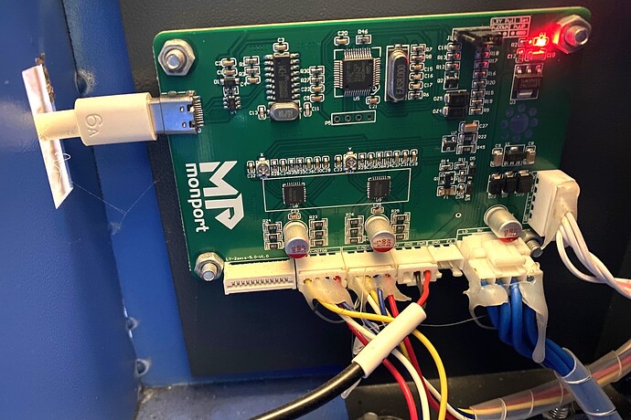

K40s can have a variety of controllers in them. A photo of your controller might help determine the type or you can use the ‘Find my Laser’ button in LightBurn to help identify it.
Thank you for replying. Lightburn picks up the K40 as GBRL. I have selected home as top left in Lightburn and because of hitting the endstops on startup I have disabled ‘home on startup’ because if it does hit the endstops then I cannot communicate with the engraver - it seems to think data is streaming.
I have found something new. My laser engraver is reversed! It starts top right and engraves right to left mirroring the image. For clarity the words are like you are looking from the back, all the letters face left but are the correct way up.
My motherboard is this one.

Does anyone know where I can download the configuration file for the Monport controller board - I think it would be quicker now to re-flash the Arduino with a clean install.
