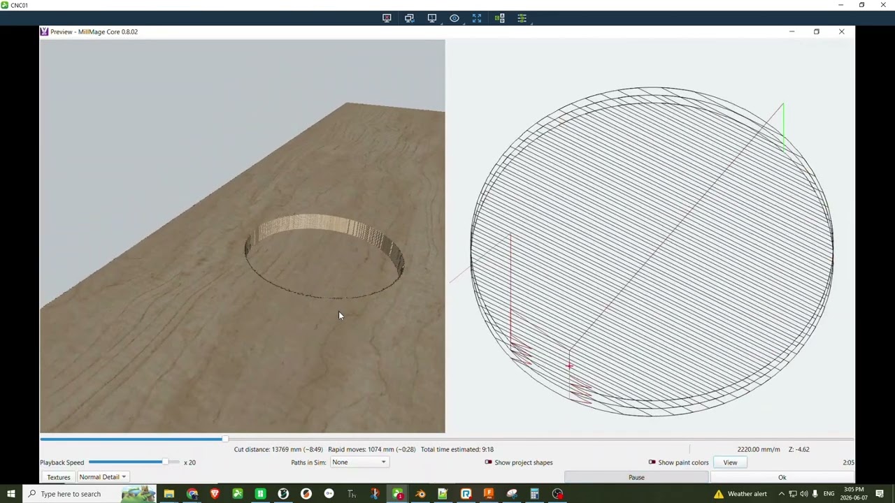

I am not sure if this if the first time I have done this or just the first time I noticed this but when creating a pocketing toolpath that has two shapes even if grouped will be treated as two independent operations inside one toolpath.
Is this expected? Its not what I have seen in other CAM tools so I was surprised.
So the Circle and the rectangle are grouped or ungroup it does not matter but if I assign them to the same pocket operation it will mill out the circle and then the rectangle. This adds alot fo extra time to the operation.

It is like Lightburn it “laser” the intersection 2 times.
Yes, because you have defined 2 paths, a circle and a rectangle. To get a single path, you can use a Boolean Join.

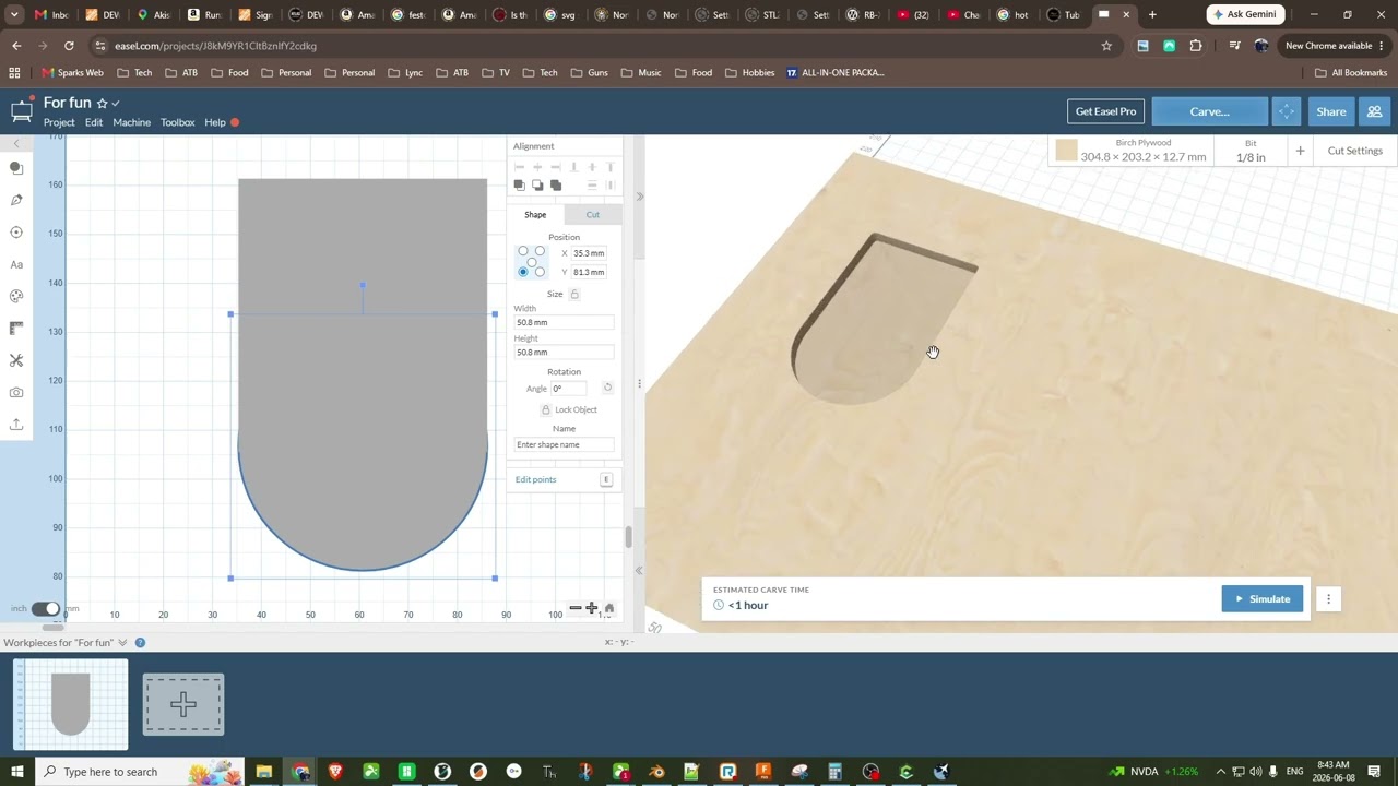

I used both Carbide Create 6 and Easel to test this behavior as well as had a friend with Vectric test it and all had the same result. With multiple overlapping shapes and a single toolpath the objects despite being separate in the design when it comes to CAM they are treated as a single object and the path is generated as if it was a single object.
