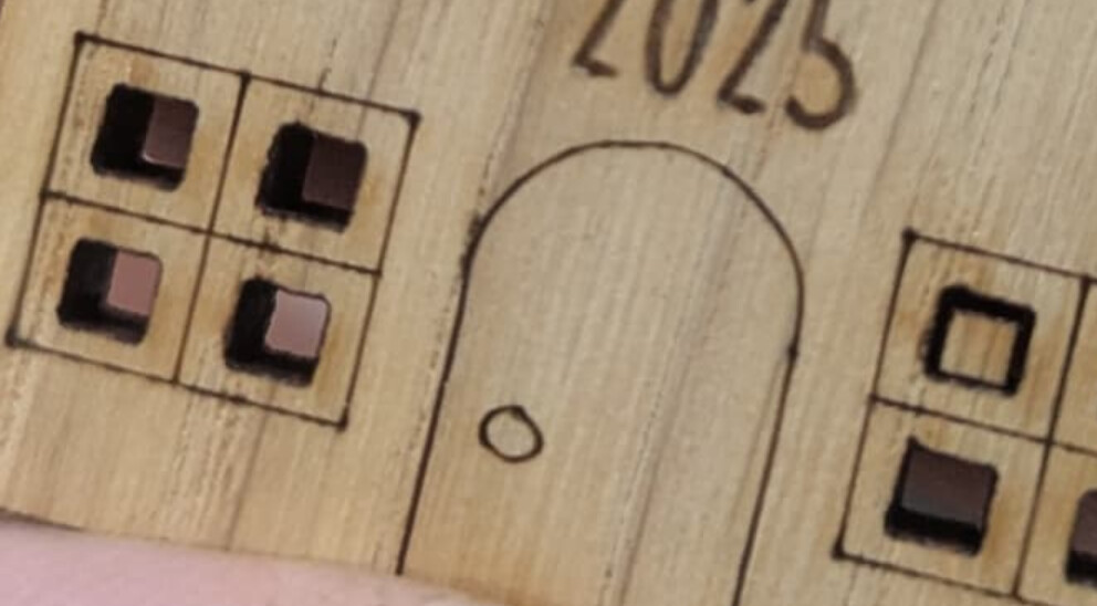

We have a 50w flux beambox pro laser with an issue after replacing the tube, psu and focus lens and doing re alignment I am having an issue where the engraving isnt super sharp like my other lasers at 500dpi.
Small text is blurry like it is out of focus.
The alignment looks perfect to me, have been laser engraving for about 5 years so I don’t think it is a basic issue.

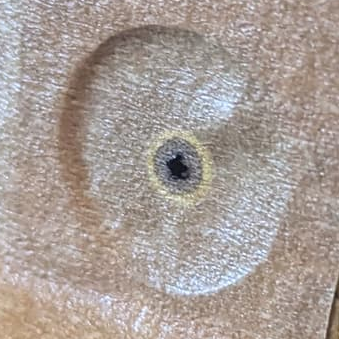

There’s no way to adjust the overscan but to me the dot size seems big at the nozzle exit?
It is about 4mm and circular before it enters mirror 3 and is fairly central.

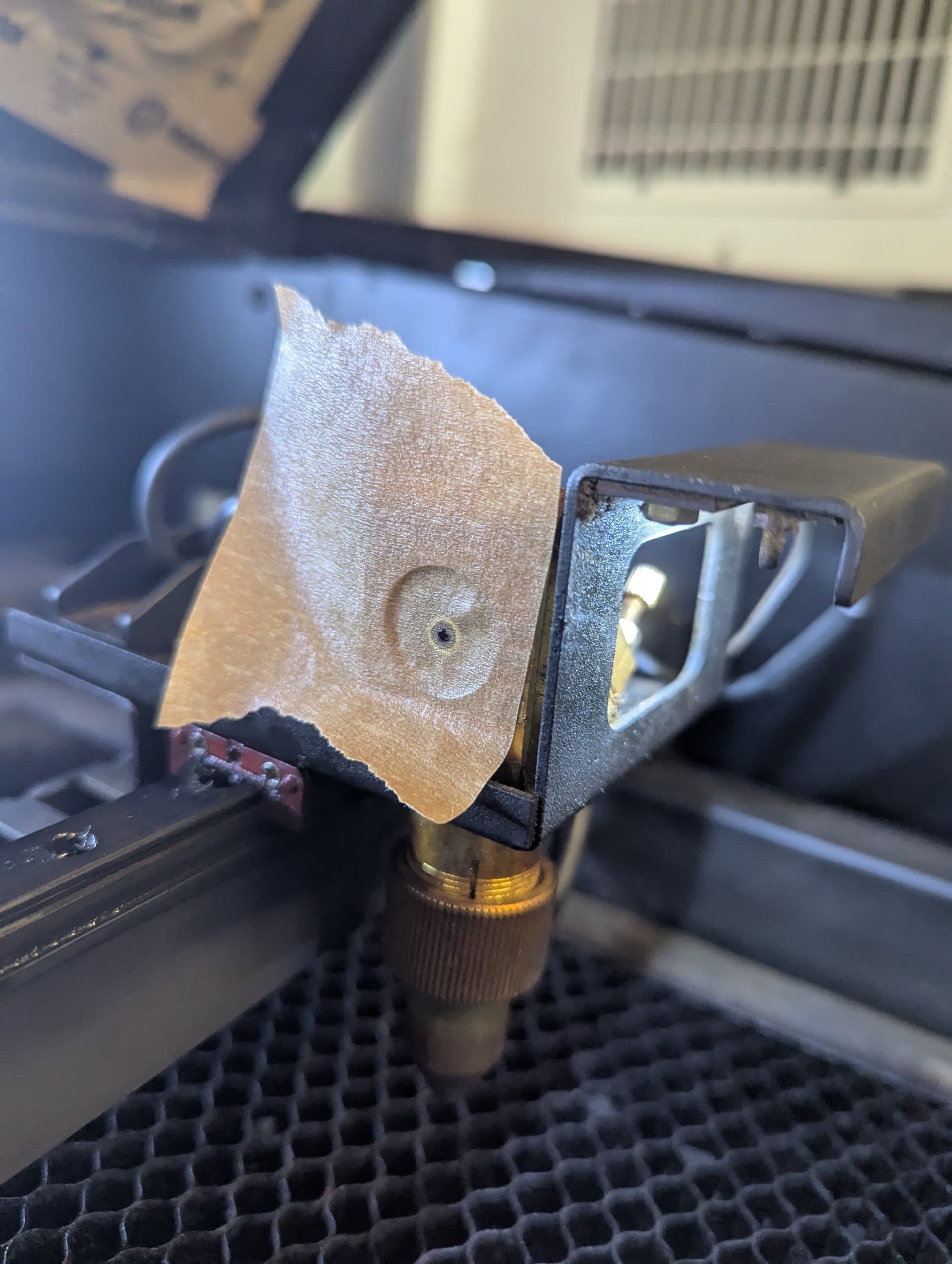

One thing I noticed which was odd was that if I do alignment at the nozzle exit which I normally do, it’s as good as I can get it. But if I take the nozzle off and just pulse at the ring it looks off centre. Of course if I adjust it and put the nozzle back on it’s then hitting the edge of the nozzle. But there’s no wiggle room with the nozzle and the lens is sat flat and the right way around so I’m a bit lost.

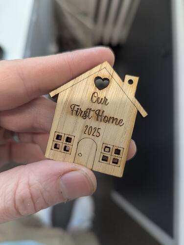

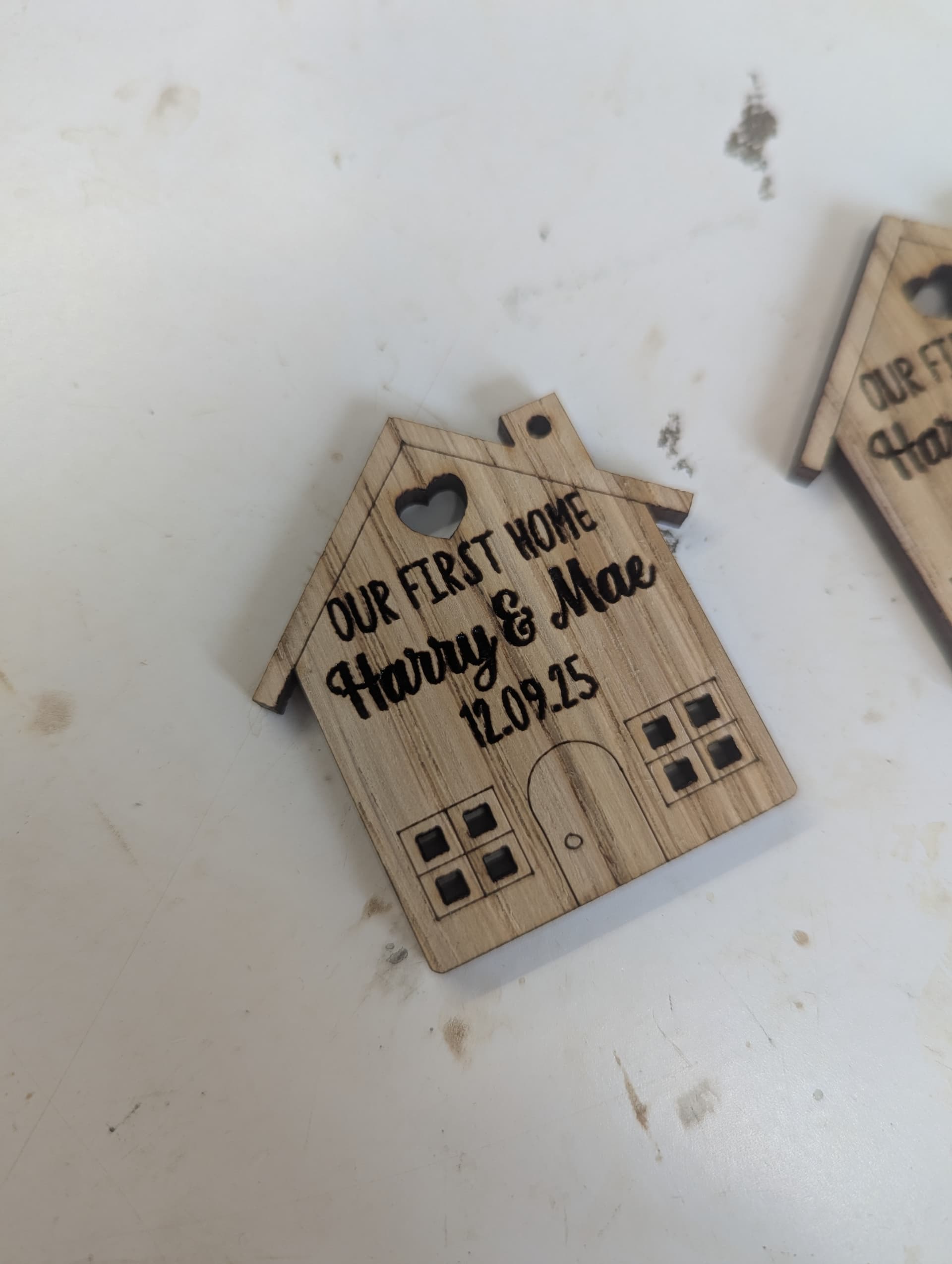

I’ve attached images and the end result. The darker engraving is the laser in question. The other house shape is at 333 dpi and the 2025 is much sharper.
I’m tempted to drop down from a 2 inch lens to 1.5 inch but I know this isn’t solving the actual issue.
I used to have very sharp results.

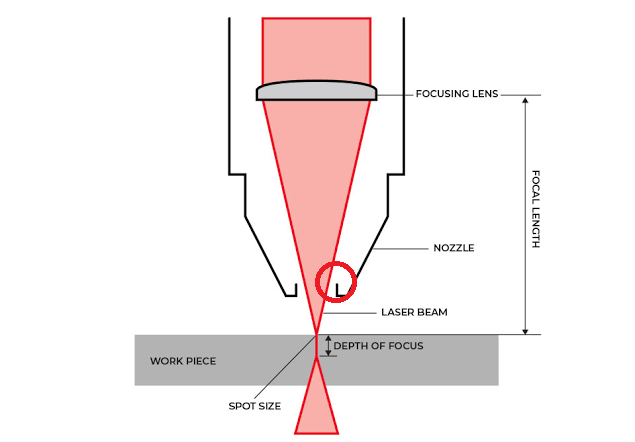

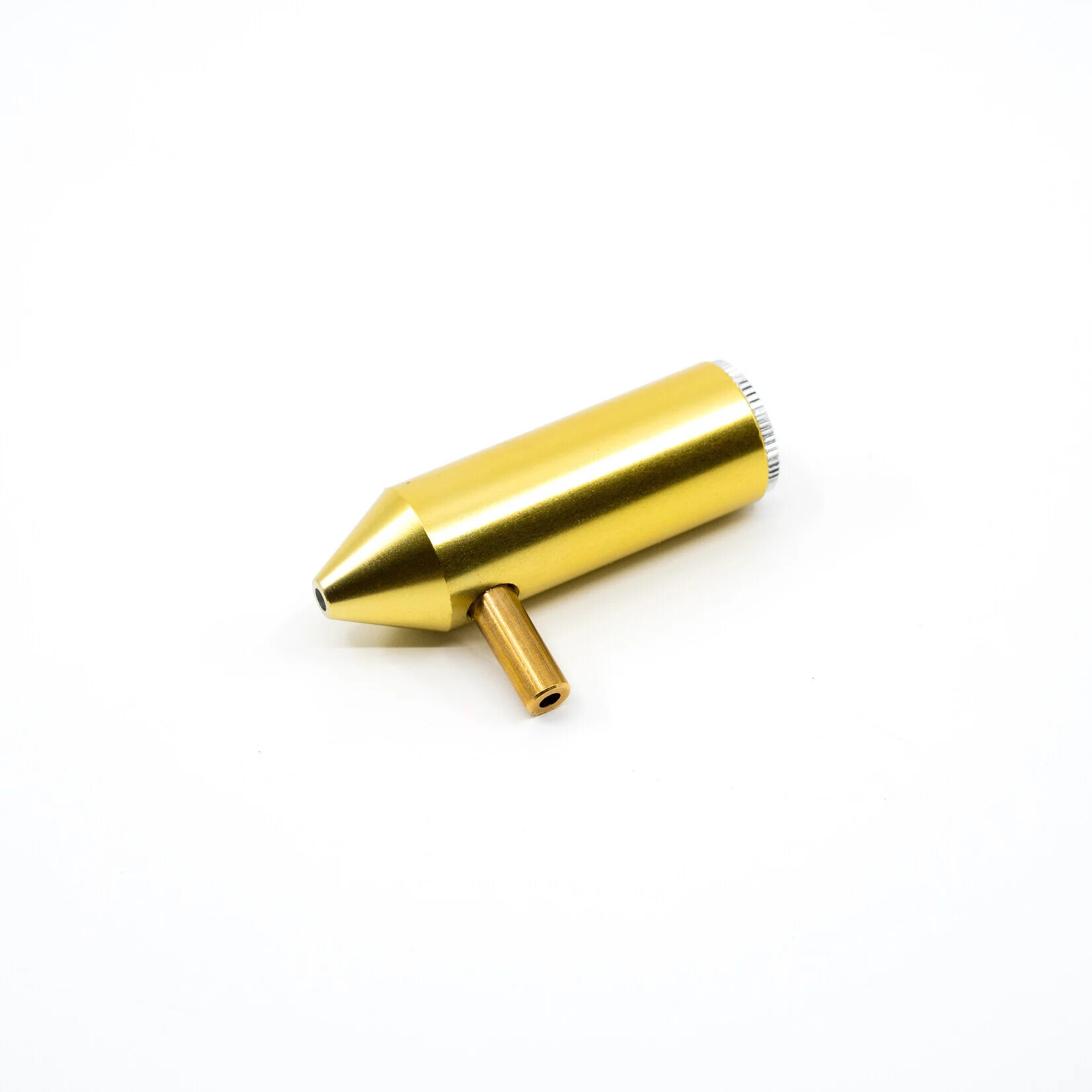

I wonder if your beam’s waist (tightest focal area after the final lens) is not coinciding with the tip of your nozzle, causing your beam to get cut off by the nozzle itself. If your beam diameter out of the tube has changed it would change the shape of your focus hourglass
In the red circled area, it could be clipping. There’s also the possibility your final lens isn’t concentric with the tube. I’d inspect that final lens to confirm and run a focus test. Focus Test - LightBurn Documentation

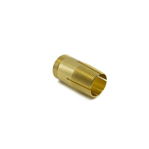

It certainly feels like this diagram. So basically when i take the laser head nozzle out and just do alignment on the Double Threaded Laser Head Socket as shown below, I can get it central no issue.
But then as soon as I pop the laser head nozzle (shown below) in with the focus lens, it then looks like it is just hitting the corner. Note there is no wiggle room, it is very snug.
If i take the focus lens out, it looks fairly central but obviously the beam is quite big so its hard to know if its being clipped etc.
I have two lens (both the same but one is brand new). I ensure they sit perfectly flat inside the housing and then secure it. When i look at them inside the nozzle at the focus lens I am zoomed out. It is a little hard to see the curve on the lens as they’re only 12mm in diameter.
Don’t worry about that, this was done on another laser machine (trotec). The issue i have is the thickness of lines, the font style which uses 2025 is really thick in comparison to the other photo.

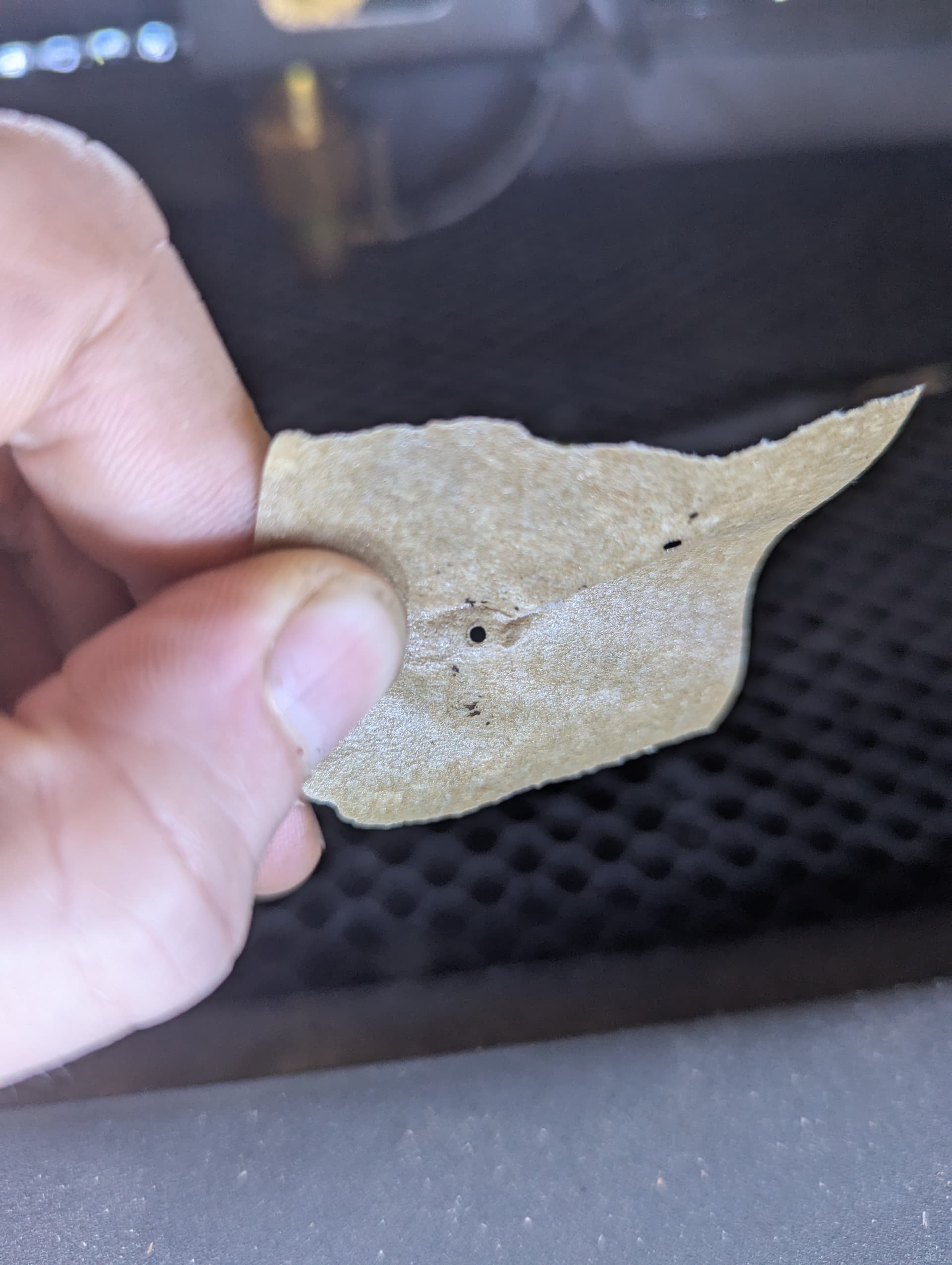

The beam shape does not look right:
I have no idea how a “normal” beam could form a light ring around a central darker disk with an oddly shaped hole burned in the center.

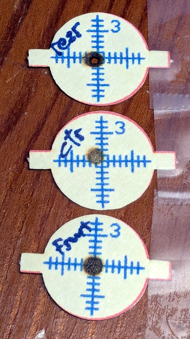

Run a few more tests over various power levels and pulse durations to see if that’s an outlier or an indication of something amiss.
You may get cleaner results on manila / file folder targets than masking tape:
Perhaps they sent you a dud tube …
When you pulse this machine, how long and how much power are you using?
Thanks both, I don’t have access to the pulse power percentage but i assume it is 100% or close to .What i do generally is lower the pulse down by about 60%. When i pulse it normally closer to 100% it looks OK i think.
