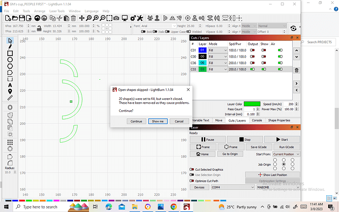

Pop up that shapes are not closed and so they have been removed
I was designing a logo that required me to break apart the shape and delete some unwanted part pieces, when I clicked on start to engrave tab, a popup saying ‘20 shapes were selected to fill, but weren’t closed. These have been removed as they cause problems’. Does anyone know how to sort-out this problem?
Probably how you built the objects.
Fill has to have a closed area to be able to fill.
Edit → Select open shapes (or Select open shapes set to fill) will tell you which shapes are open.
You can use Edit → Auto join selected shapes to see if the software can close them for you.
