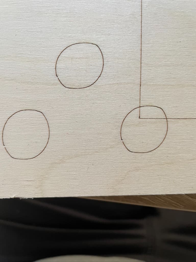

Porque me deforma los circulos?
buenos dias, tengo una cortados laser ortur LM2 y lo manejo con un macbookpro. estoy usando la version de prueba e lightburn. soy nuevo en esto. cuando quiero realizar un circulo no lo hace perfecto alguien me puede ayudar a resolverlo?
This is usually a mechanical fault. Go over all your moving parts and make sure that everything is not too tight or too loose.

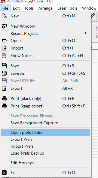

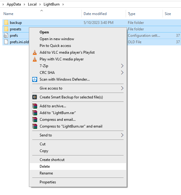

If you want to restore Lightburn to default settings you can do the following.
  1. Open lightburn, go to File—>Open prefs folder
  2. close lightburn
  3. delete the contents of the folder and restart Lightburn. You may want to back these files up before you delete anything if you want to reset Lightburn to those settings
