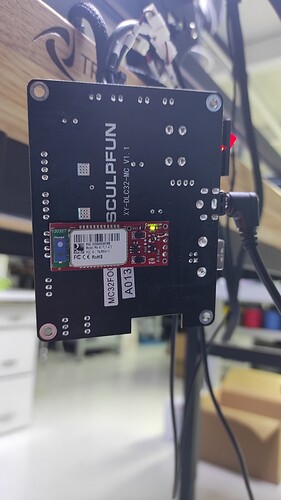

I installed (mod) a bluetooth wireless serial in a laser cut (S30 Pro Max), these modems work as a serial (RX/TX) pipe, and are a great wireless replacement for cables. I tested over open air at 60m and everything works very well.
But it does NOT work (at least in an easy way) on Lightburn for Linux, because of the way the ports are designated.
It would be great to be able to choose (in Lightburn) the port in a simple way like simply typing:
/dev/rfcomm0
I tried to do it in “prefs.ini”, changing the line
“CommPort”: “ttyS1” to “CommPort”: “rfcomm0”, but it didn’t work.
It would also be very useful if there were a button to “connect” and another to “disconnect” the port, especially when a cutting machine is shared.
