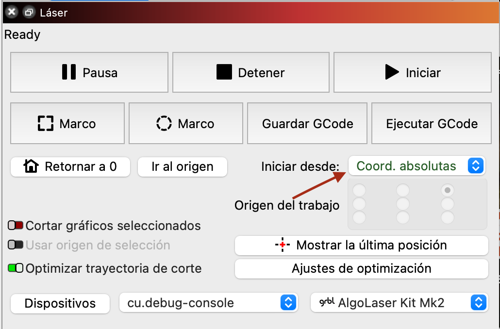

In the Laser window, on the right side under two rows of buttons, have you selected ‘Absolute coordinates’?

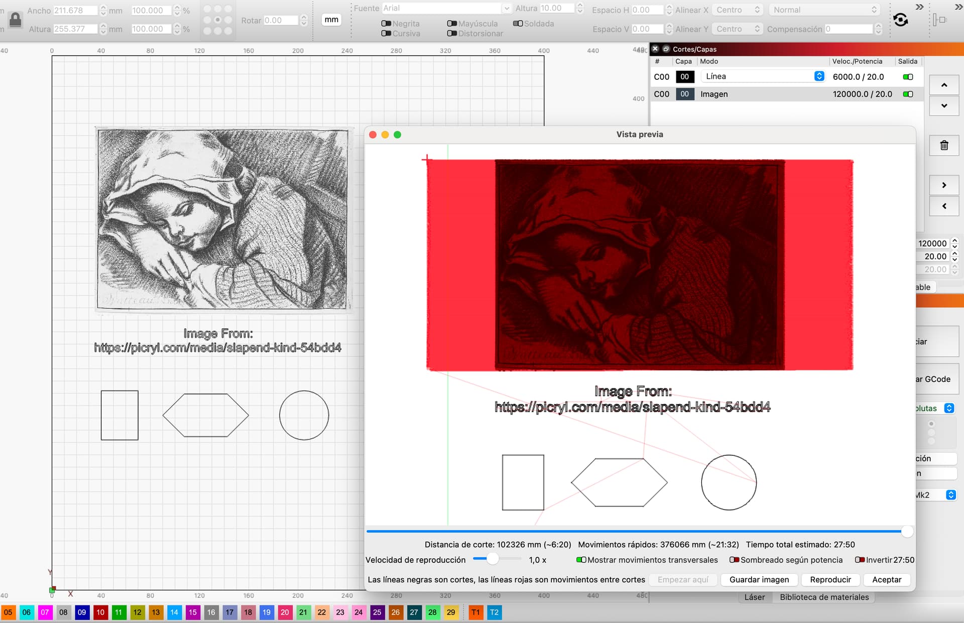

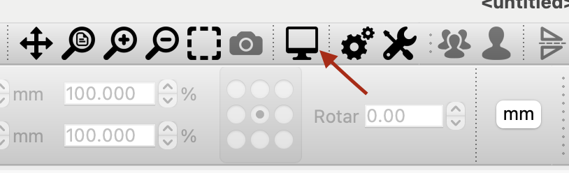

Please open the Preview Window in LightBurn to see how the laser is expected to move.
Select “Show Traversal Moves”, and confirm that the pink or red lines remain in the work area. The pink or red lines show the expected motion when the engraver is moving with the laser off.
Below is an example of excessive speed, excessive overscan and the engraver being set to move outside the work area (the Green Line in the Preview window)
