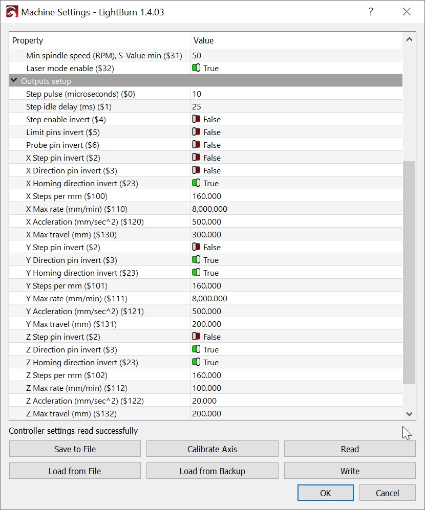

These numbers are also in Machine Settings. To access them click Edit, then Machine Settings then click the > symbol in the last line next to Outputs setup. Skip the dire warning. :slight_smile:
Note here that the Units are shown. Knowing the Units applied to acceleration (mm/sec^2) and speed (mm/min) is critical for comparing them.

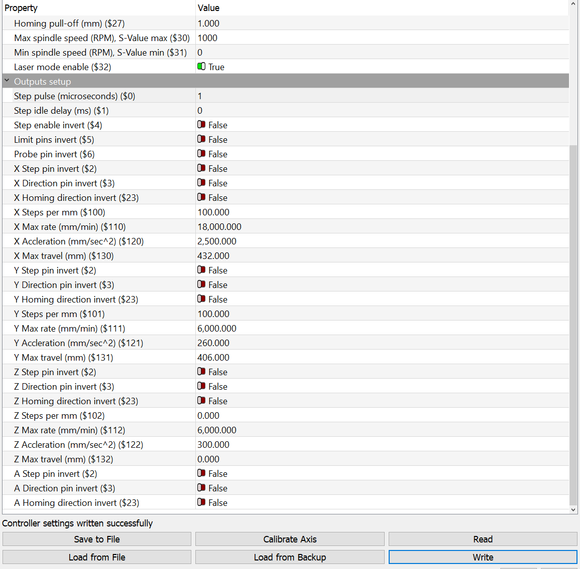

With your xTool D1 pro connected to LightBurn, please enter the following into the Console window:
$121=260
then press enter.
Please verify that the setting changed by requesting the machine settings $$ report, as you did above.
With the reduced acceleration along the Y axis you should have more consistent results in LightBurn. Please let me know if this fully corrects the unwanted behavior or not.
Thanks!
The command $121=260
Is not changing the value of $121. (Just in case, I have restarted LightBurn after issuing the command, I have issued the command multiple times, and the value is still 300)
Should I try to change the value in Machine Settings?

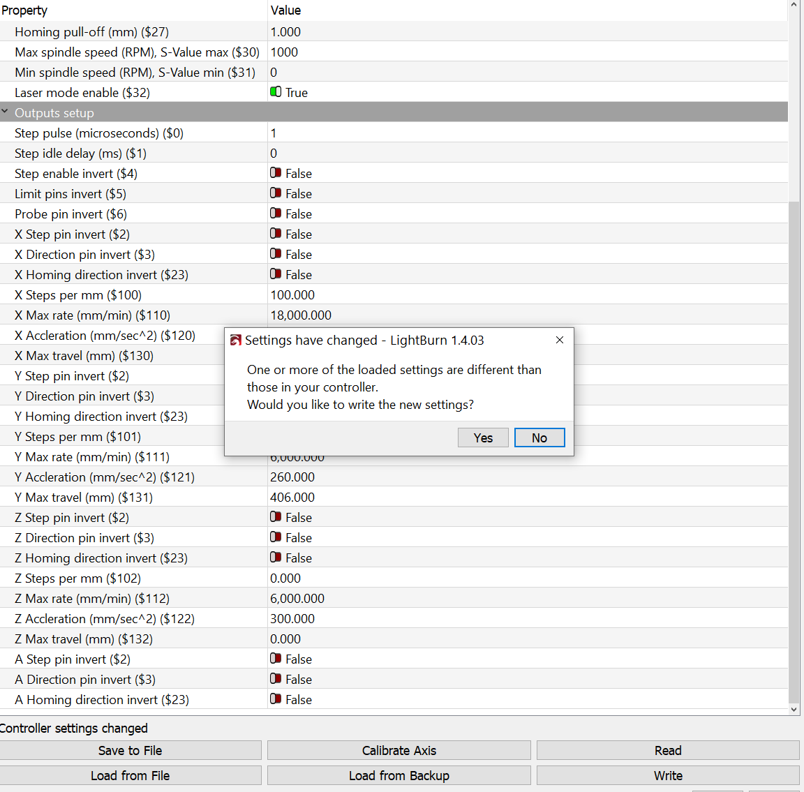

Yes, Please do… and Please test the Write button at the bottom of the Machine settings window to write the change out to the controller.
The Persistence of Machine Settings is most often a chosen setting that is deeper than the regular machine settings. Usually, it’s something called a build-time setting. It’s made in the firmware in the controller by the folks that ‘do the build’ or Compile and Flash the firmware. I don’t know of a way to re-open the persistence of Machine Settings after they have been closed. They may have built another way.

Unfortunately, it did not work as expected. The changes are written successfully to the file (See snapshot, and I checked the content of the file); however, when I close the Machine Settings window and reopen it, the value is reverted to 300.
I even tried to load from a backup file where the value is set to 260; the read is successful, as shown in the below attached snapshot. Again, the value is reverted to 300 once I close the Machine Settings and reopen.
In both cases, the “$$” command shows $121=300

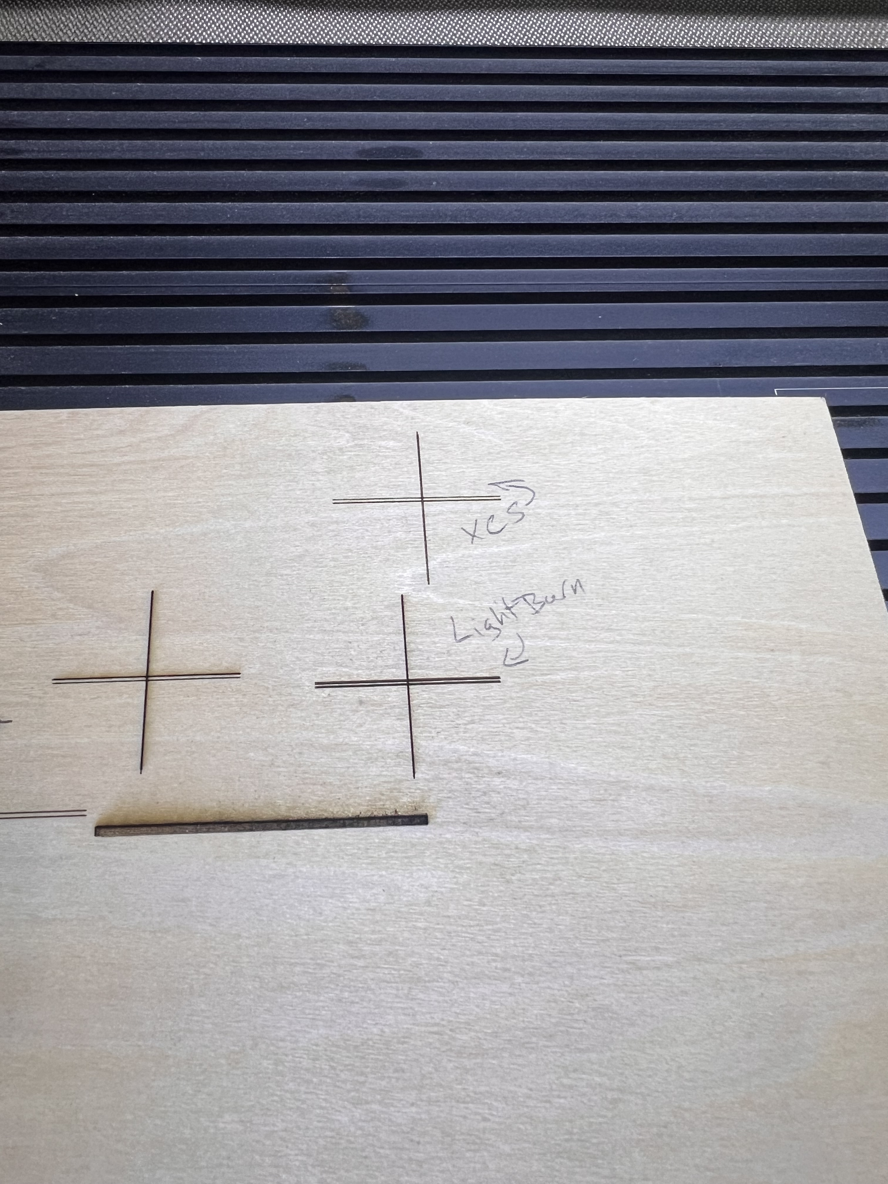

Hey guys, I ran this test on my 20w xtool d1 pro with the latest firmware, XCS, and LightBurn 1.4.03 and I am seeing a shift on the Y axis with both software consistently between homing.
Run the cross hair, let the machine home, run again.
My assumption is the repeatability of the Y limit switch is not great based on this and many posts I’ve seen about them.
I’ve seen homing repeatability issues with xTool machines before. But based on the steps listed by OP it doesn’t appear that he is homing in between runs, just re-hitting Start button.

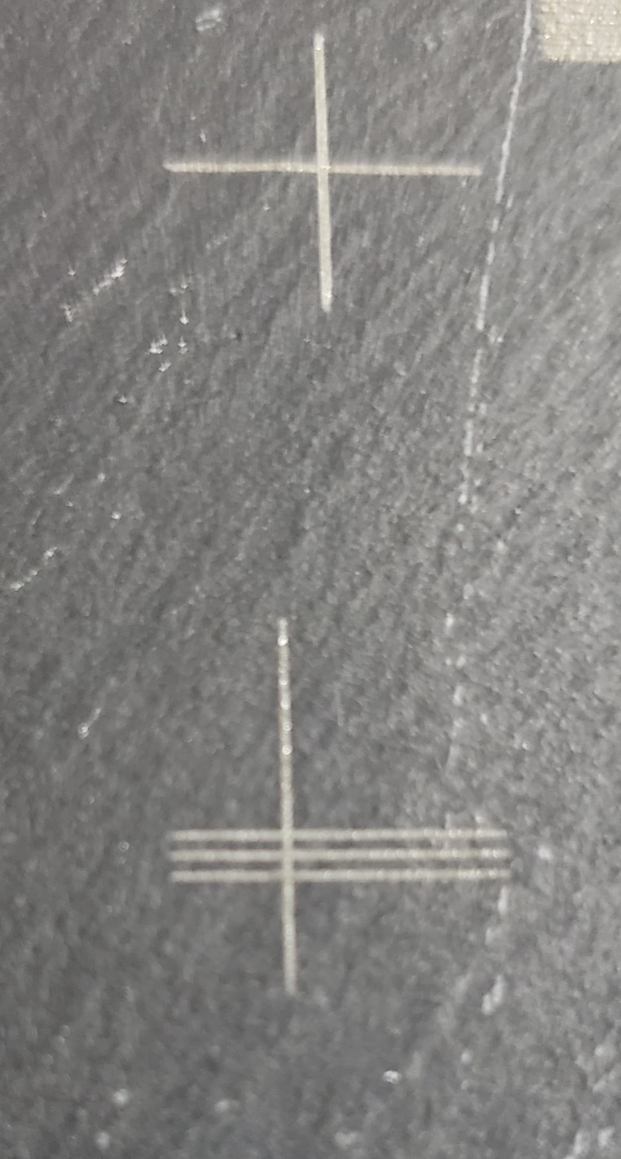

I am testing with XCS version 1.6.10-2023-10-08-21-34-45; Absolute Coordinates were introduced in version 1.6.10 (By the way, version 1.6.10 does not compute properly the dimensions of an imported PNG photo; as a workaround, I create an SVG in Inkscape, import the photo and import the SVG in XCS; older versions compute properly the dimensions)
In the below photo, the differences between the top and bottom crosshairs are
  • (Though it automatically returns to Home after etching) In the bottom crosshair, I have added an explicit “Home” between two “Sarts”
  • In the bottom crosshair, the second “Start” did not fail which explains that there are only two horizontal lines
Homing is done automatically, and as shown in the picture above, it does not seem to impact on the behavior.

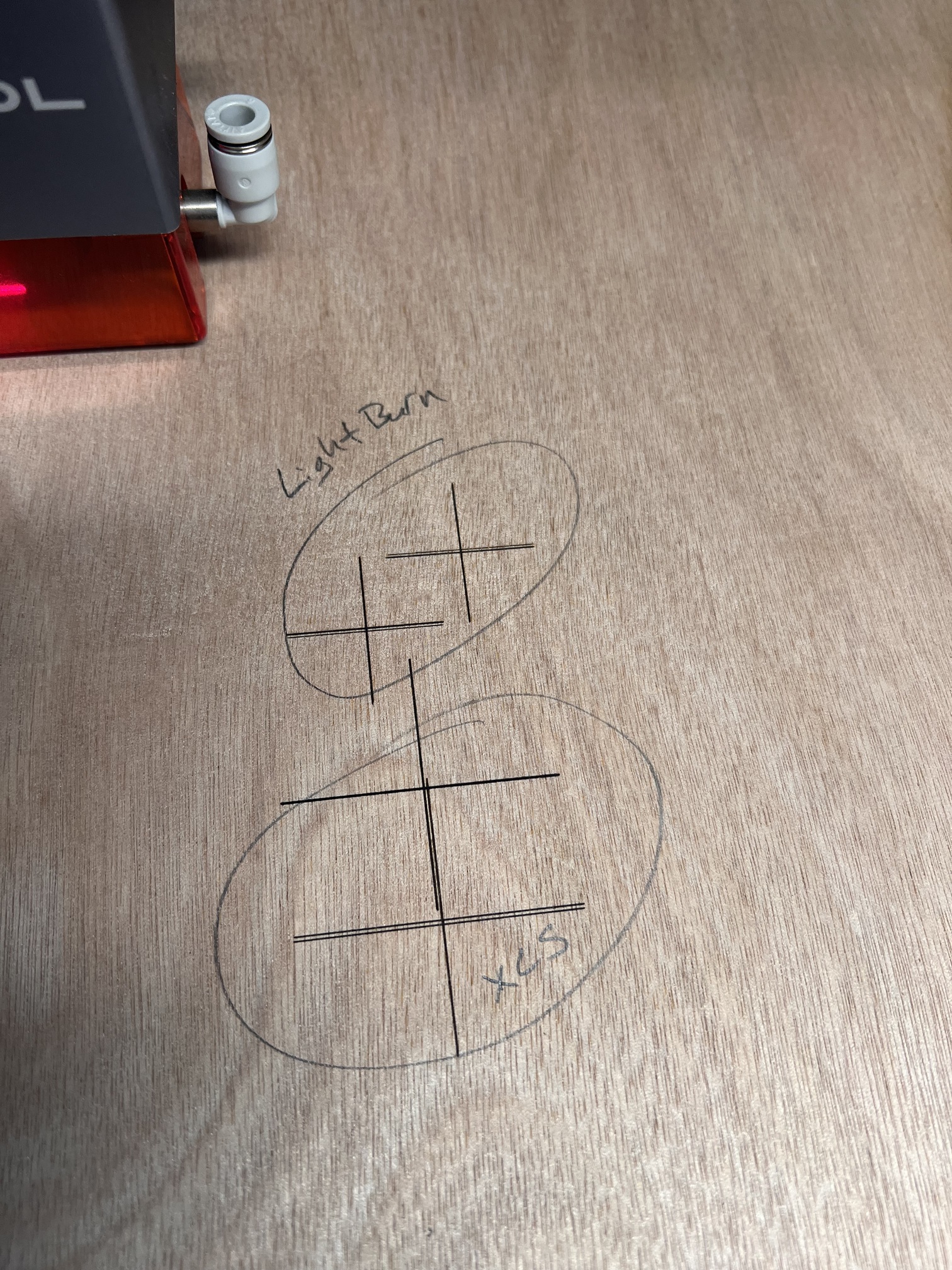

I repeated my test again today. Different laptop. Latest XCS and latest firmware. The results were the same. My D1 pro is not repeatable in either software. It might be slightly more repeatable in XCS but the shift happens in both softwares.
After I saw your post, to make sure, I have repeated the same in my environment: XCS is consistent while LightBurn is not, as shown in the picture below, where the top crosshair is etched using XCS.
(The same crosshair is etched three times, in both XCS and LightBurn, using the same speed: 80mm/s)
Considering John’s hypothesis/explanation, can it be that the difference in behavior is due to the fact that the weight of a 20W module is different from the weight of a 10W module? (I am testing with a 10W module)
Most importantly, if that is the case, is it configurable or controllable using G-Code? (I have no exposure to G-Code)
