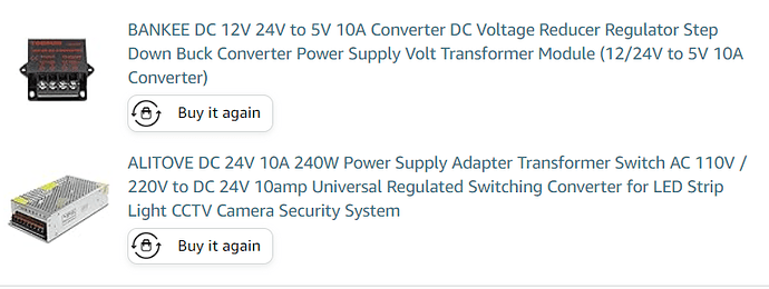

Just to put a final comment on this thread, I received and installed the following power supply and reducer.
99f037d796700b49c8192be5690e708f45636eec_2_690x260
They worked great!
Wired them up like @micrololin and @parsec suggested. I was up and running in less than 30 minutes. If anyone has the same type of Chinese 50w laser, a power supply with three 24v DC outputs, reducing one of them from 24v to 5v for the red dot and supplies the needed wattage, then this solutions works.
Thanks to everyone the contributed to this tread!
