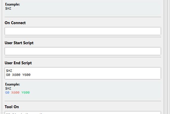

if you go into custom g codes user end script it will go to what you put in there after each job

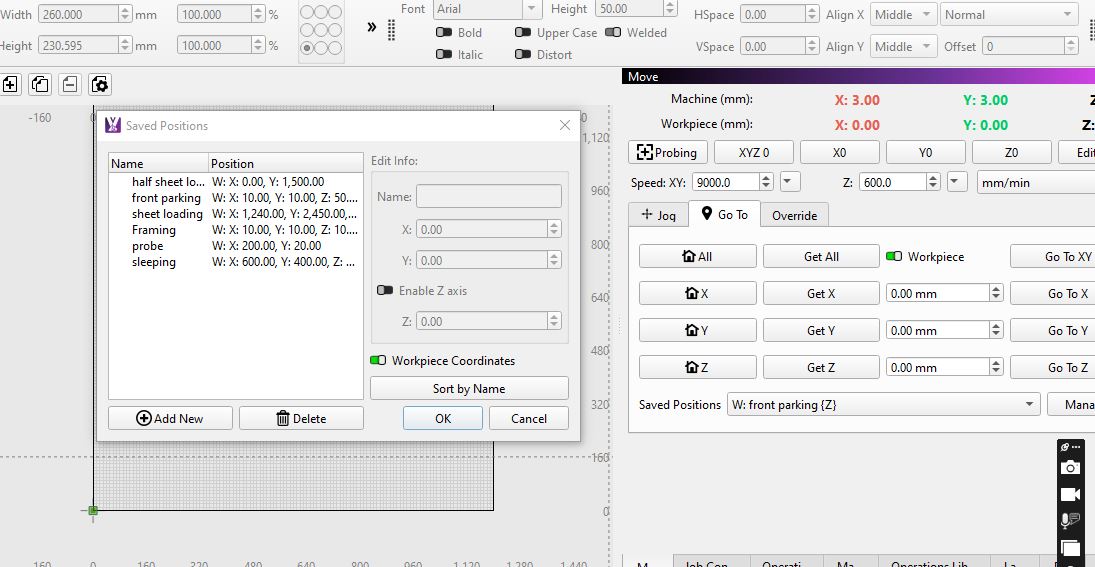

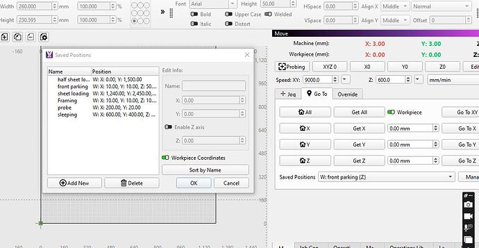

another option is under move tab ,saved positions and click manage and set up any saved positions you want , they become very handy especially if you have a big table

This is what I use all the time. I run multiple jobs or operations on the same part. Put this in your end job script:
G0 X0.0000Y0.0000

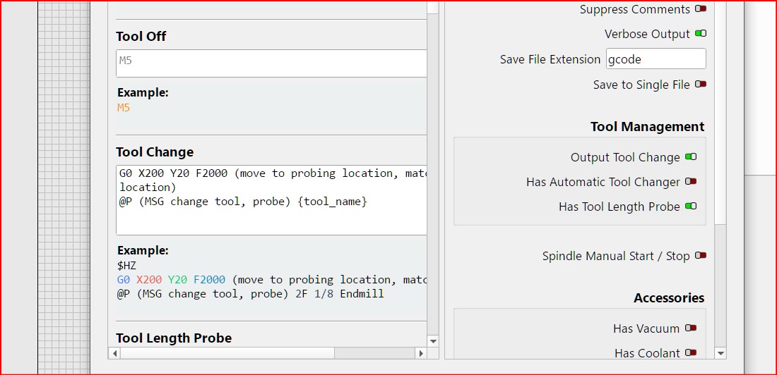

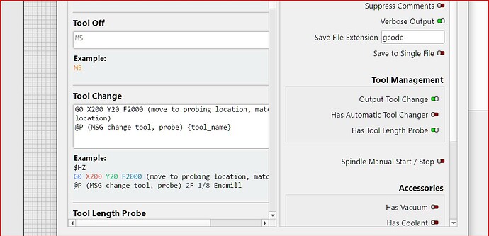

re multiple operations that is different again -( tool change) in custom g codes under tool change this is where you tell your machine to go at end of each operation
unsure as weather you have all operations enabled or manually turn them on and off
This effects how things are set up , if all enabled you only need to find X0 Y0 at start of job after that , tool change can be anywhere as above mine is x 200 y 20, as Z only needs probing after each tool change , if multiple operations use same tool , it may pause and ask you to continue for next operation , or just carry on with next operation with out blinking , (well my machine does that , has mind of its own some days)
