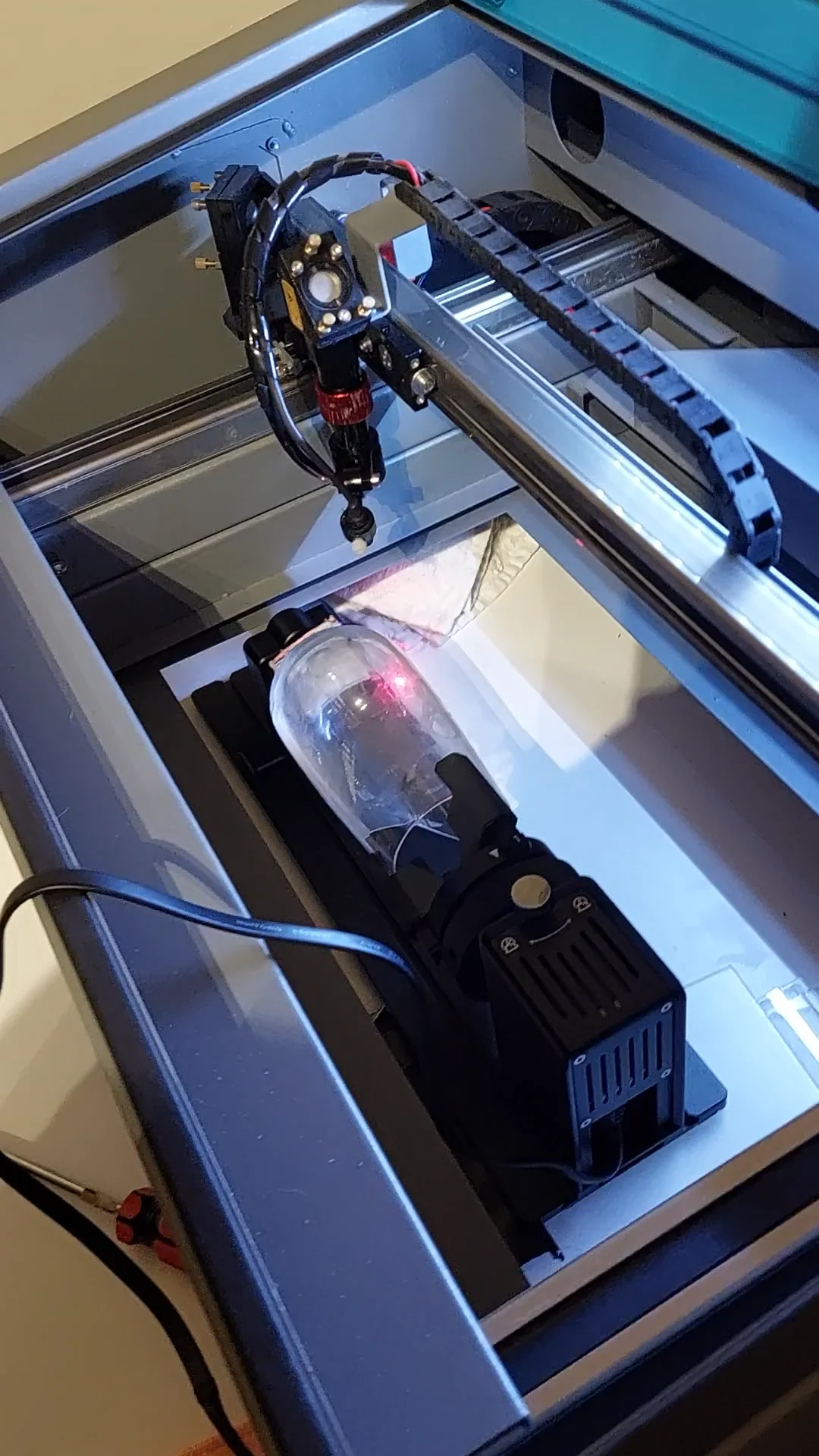

I have a self induced control board issue, I want to know if I fried my Y axis or this is fixable.
Basically I was hooking up a rotary attachment but the wires needed to be switched around. I seemingly have toasted my Y axis output from my control board. If it’s not toasted , it’s at least confused.
X axis output on control board works fine, rotary and Y motors work fine, but everything is grinding/erratic when plugged into Y axis.
Also grinding whilst machine is switched off but still plugged into Y axis output, as soon as its unplugged - smooth as butter.
  • standard OMtech k40, with the board that’s compatible with lightburn. (I have no idea exactly what it is-see pics) For reference the rotary is a creality one, and the wires are different to most. Helpski pleaseee

I believe the intent was to swap the x axis and the y axis and see if the problem moves.
Oh well i thought i explained this haha, but yes the problem moves. It happens to whatever motor is attached to the Y axis output. Whether that be the Y axis, X axis or the rotary itself. Whichever one is plugged into that output has a weird grinding resistance
As far as my expert opinion goes - it is the Y axis output of the driver/control board that is fried. I just want a suggestion on whether i buy a new one or it could be fixable/firmware related
If the problem moves when you swap it, it’s likely a hardware failure in the driver circuit. It’s possible that it’s a cable, but unlikely.
On your board these drivers are under the heat sink. Some can be changed out, some can’t.
It’s likely more sensible to change out the board.
