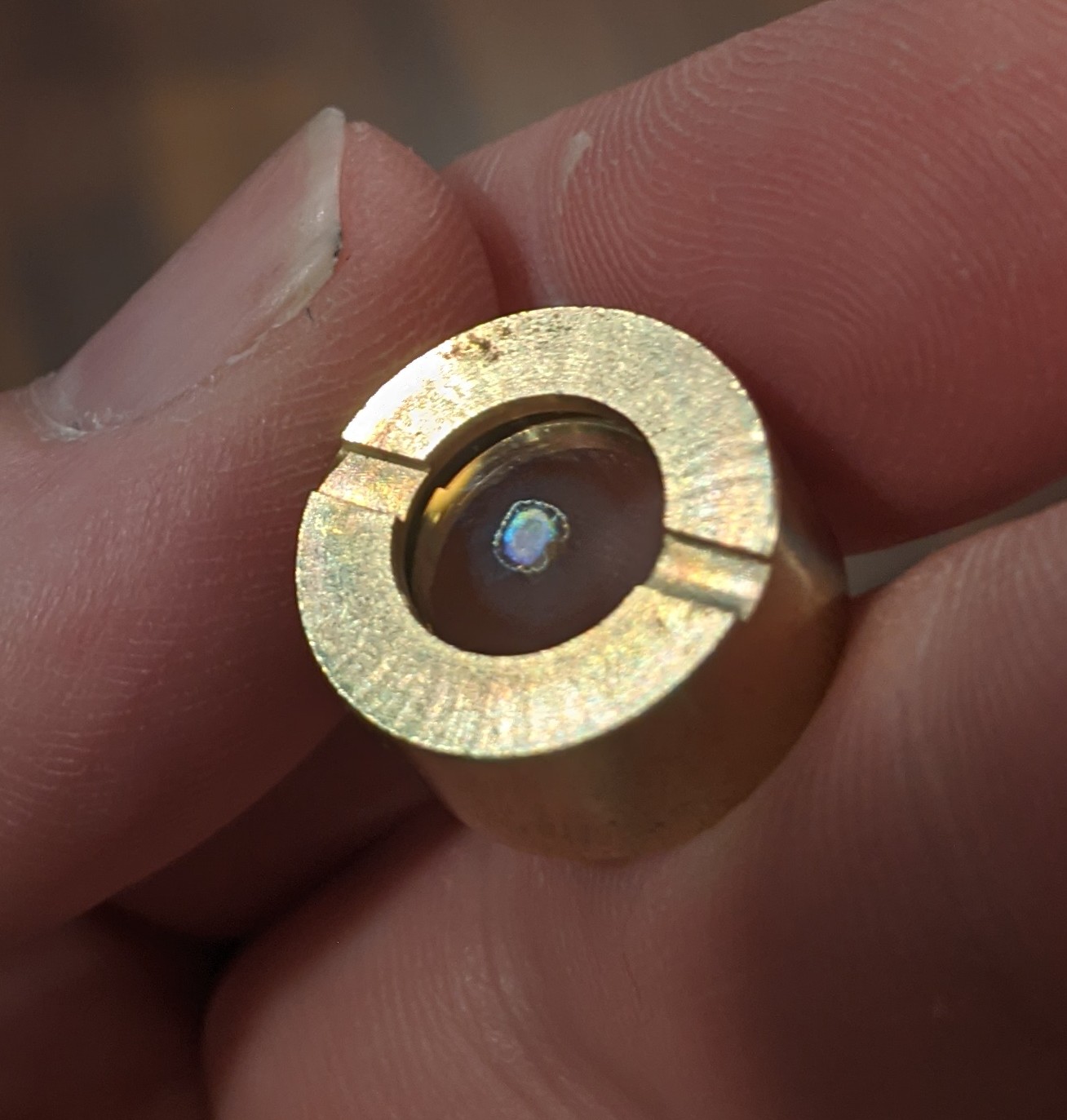

My xtool power has suddenly decreased I have changed no settings but now even though light burn says 100% power I barely even burns through paper what am I doing wrong
What speed setting are you using? Make sure the units are what you expect. People often switch to mm/s and input values meant for mm/min.
Make sure to double check your lens if you haven’t cleaned it in awhile. Smoke and other debris can get on the lens, even with a nozzle and air assist, and torch it.
A o I have messed with all different speeds and power and I also just clean the lens neither work

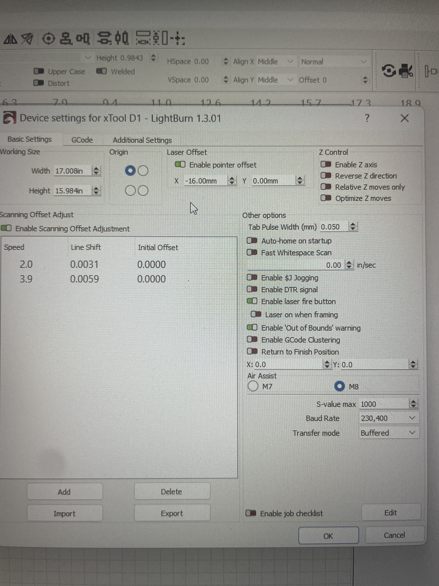

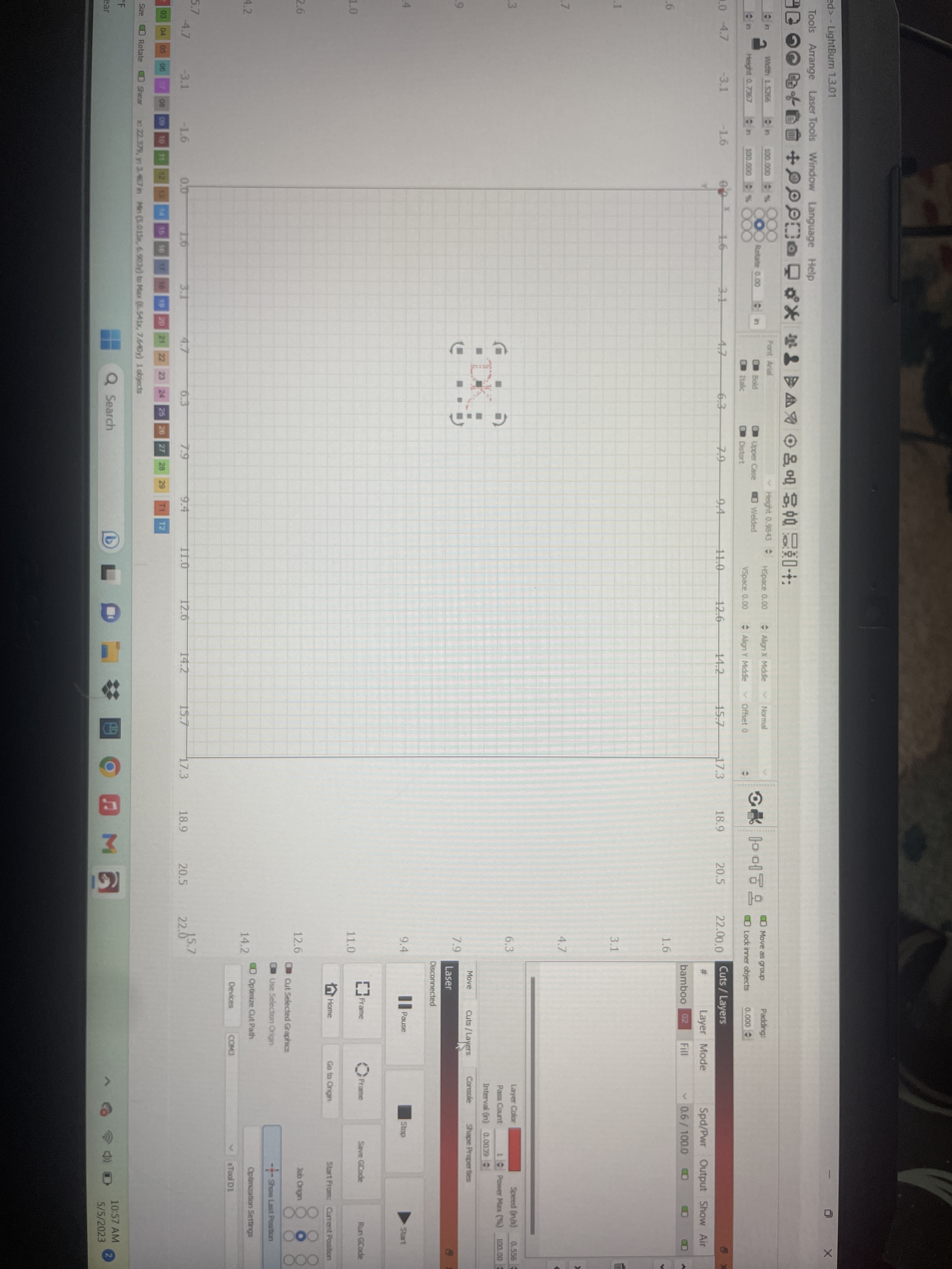

Can you provide the following:
  1. full screenshot of LightBurn with Cuts window showing?
  2. screenshot of Edit->Device Settings
I don’t see anything too unusual there. If you are still experiencing problems after having cleaned the lens then it’s likely you may have a hardware issue.
Check over cables and make sure they’re properly seated and don’t have damage.
If you have a volt meter check power supply voltage just to make sure it’s operating normally.
If none of those bear fruit then it’s likely your laser module is damaged or deteroriated.
While I don’t think it’ll help this situation, I will note that XTool’s supplied device config for Lightburn has DTR Signal turned on, and you have it off.
