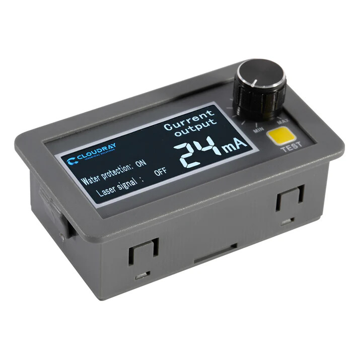

The usual remote meter setup has a knob similar to this:
The knob varies the tube current from 0% up to whatever the controller’s PWM output specifies.

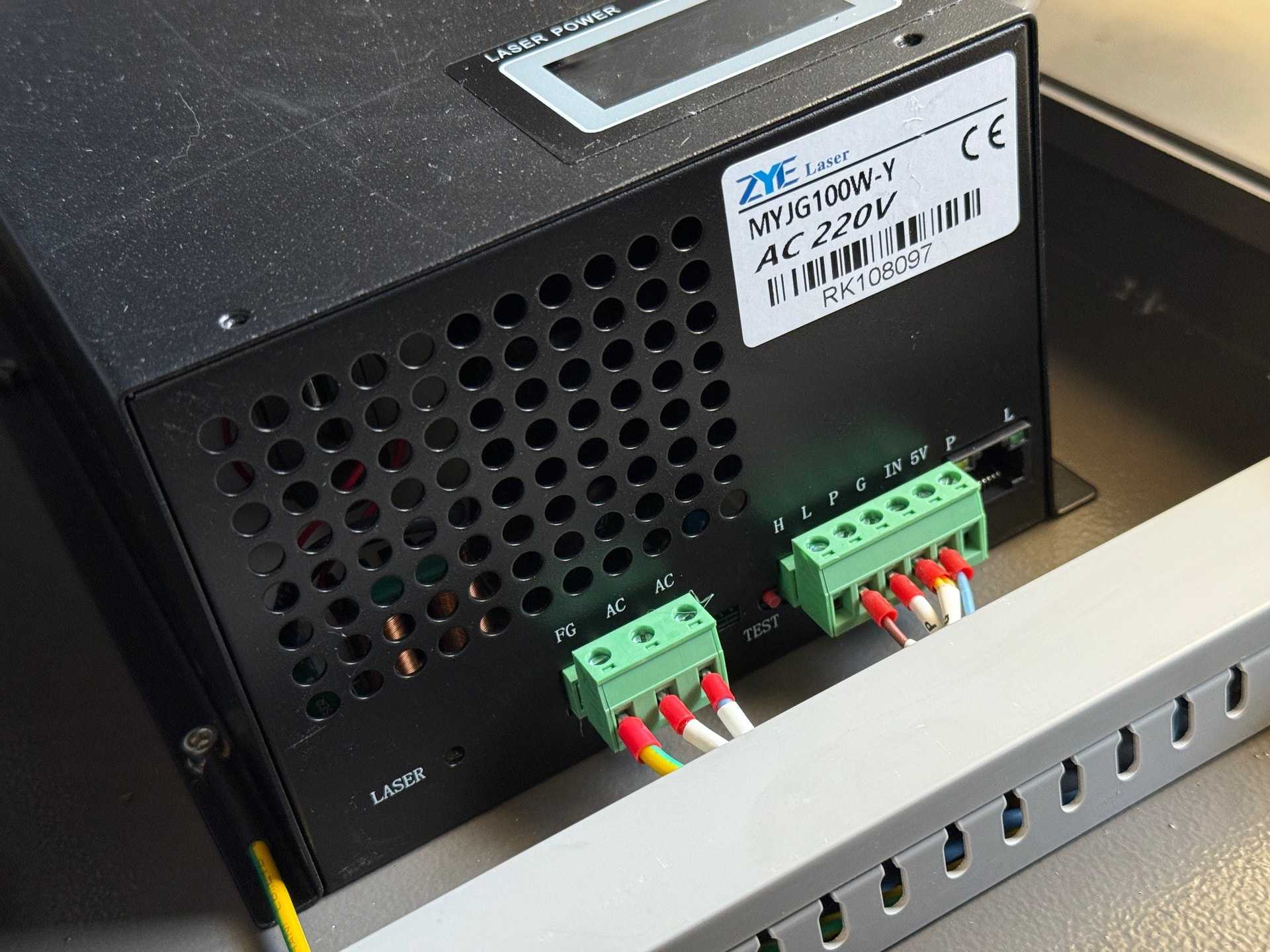

This is my power supply, a ZYE laser myjg100W-Y. 100W in the description but the specs say it is suitable for 80-120W. I found the manual online, it says nothing about adjusting the power. There’s a little hole next to the ‘laser’ label at front left. Changing the phrasing of my Google search yielded an AI-generated result that indicated that on some models of this power supply there is indeed a hole labelled ‘laser’ that is the adjustment point. I will give it a go. The goal is to have long life from the tube but to also have a linear output from different power settings in Lightburn for accurate cutting and etching / engraving.

Small note, if you have the possibility to open the box - do it. If not, you have to fumble your way to the small pot and there is a risk that you short something - use a ceramic screwdriver.
And to make it even more interesting :wink: , some power supplies with internal mA meter have their pot on the side and not at the mentioned hole in the shown position next to the green sockets.
You are about to learn a possibly very expensive lesson about trusting AI slop.
The hole marked LASER has a small LED behind it that lights up when the laser tube should be firing. It’s amber in the 60 W supply in my machine:
The unmarked hole you want is on the right side of the case (as shown in your picture) and likely inaccessible due to the wiring raceway (or whatever) a few inches further right.
Of course, trusting randos found on the Interwebs is also risky, but … :grin:
Thanks @ednisley and @bernd.dk Yes the potentiometer is not behind the hole marked ‘laser’ but behind the unmarked hole down the side. The internals look similar to Ed’s photo. I did have to remove the power supply from the machine and remove the cover to identify and adjust the potentiometer. I would have to drill a hole in the frame of the laser to access the potentiometer with the power supply in place. I will do that at a later point. While the power supply was out I turned the potentiometer screw down a few turns, reassembled and tested. With the Ruida power set to 100% and 90% power in Lightburn the current draw is 24mA, the maximum recommended, so I am using 90% as the maximum. At least I now have a linear change in output power across the range, with the Ruida power percentage matching the Lightburn setting. I will remove the power supply again soon and wind the potentiometer screw down another turn which should allow me to take the Lightburn power up to 100% for better adjustability.

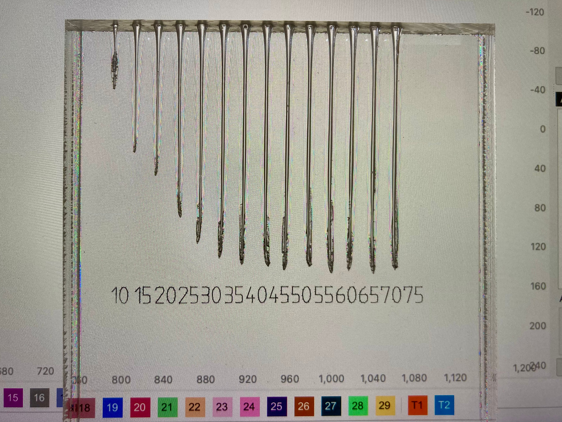

Small recommendation, now that you have reassembled your machine/power supply. If you can find a piece of thick acrylic, you can stand it on its edge and test your tube to find its real power curve.
I used 5 or 7 sec pulses, can’t remember. But my max power with this tube was achieved at 65-70% and 17-18 mA, after that the curve flattened out. So in my opinion there is no reason to pump more energy into the tube than necessary to achieve max power - at 70%.
I extremely rarely go above 16 mA and the tube has so far not lost much of its original power.
So my maximum is set to 18mA, not because I am “conservative” but because that is the (my tubes) physical actual max.

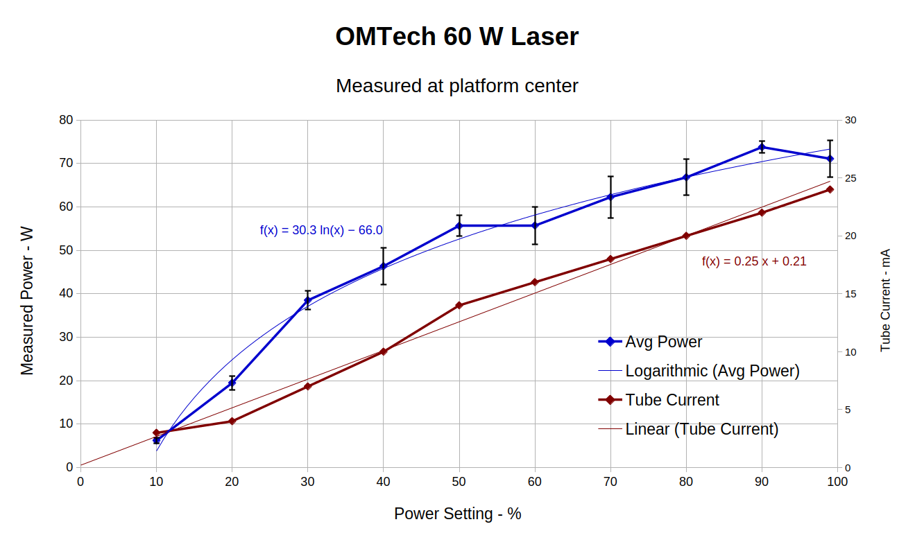

That’s a better and more convincing physical plot of the power output I measured last year:
The power supply regulates the tube current (red curve) linearly with the PWM percentage, but the optical power (blue curve) shows most of the power variation happens below 20 mA. Not only does more current not produce much more power, the beam quality deteriorates.
I built most of my Material Table entries before I had the meter, but if I knew then what I know now, I’d adjust the power supply for 20 mA at 99% PWM (by setting 10 mA at 50% PWM) to flatten that curve.

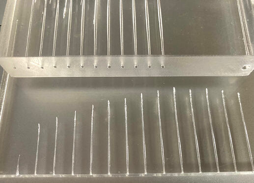

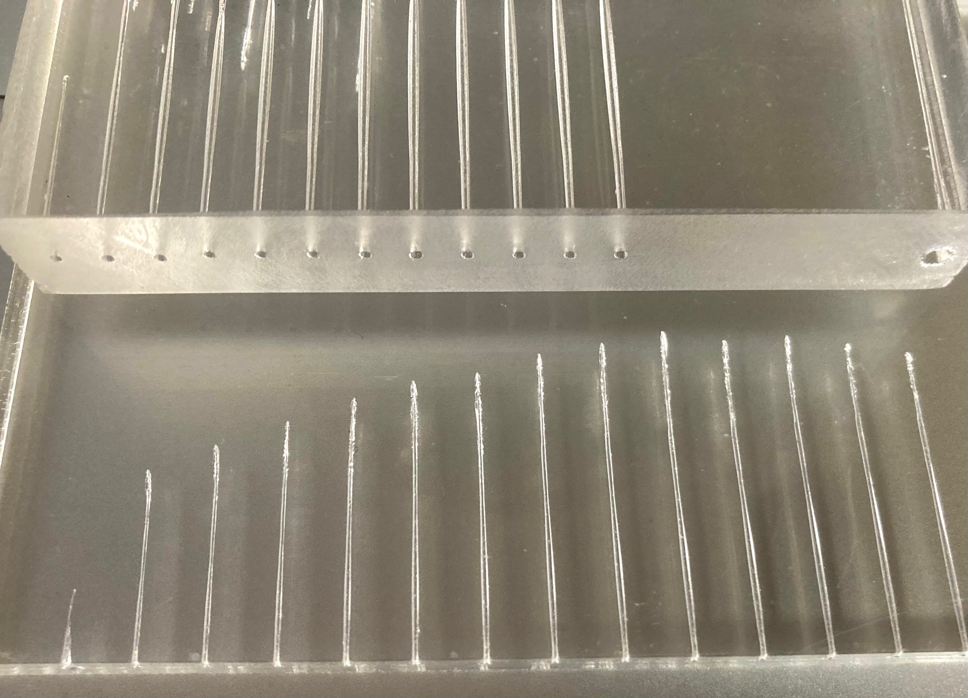

I did a new test today to make sure I’m not remembering wrong. The geometry of the curve is not much different from my old test, but I’m surprised that my power range is relatively low, i.e. 15-17mA is max here with this tube. However, I’m reasonably convinced that I get around 60Watt - bar at lower mA values.
It could be interesting to measure the true output, but on the other hand I don’t have enough practical use for it and to invest in an expensive measuring instrument.
Bottom line, it’s important to have a good tube that can cut and limit the tube from unnecessary overload, in my opinion.
PS a completely different little detail, notice the small cracks in the numbers, that’s material stress after using alcohol to clean the residue from the marker pen.

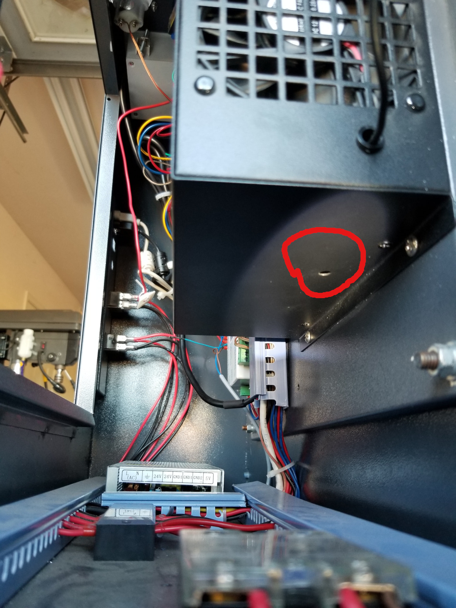

This is where the adjustment is on my 50W machine. You need to be a contortionist. :wink:
You can also set the pwm limits within the Ruida controller and limit it there. The best procedure is the one @ednisley described using 50% power.
