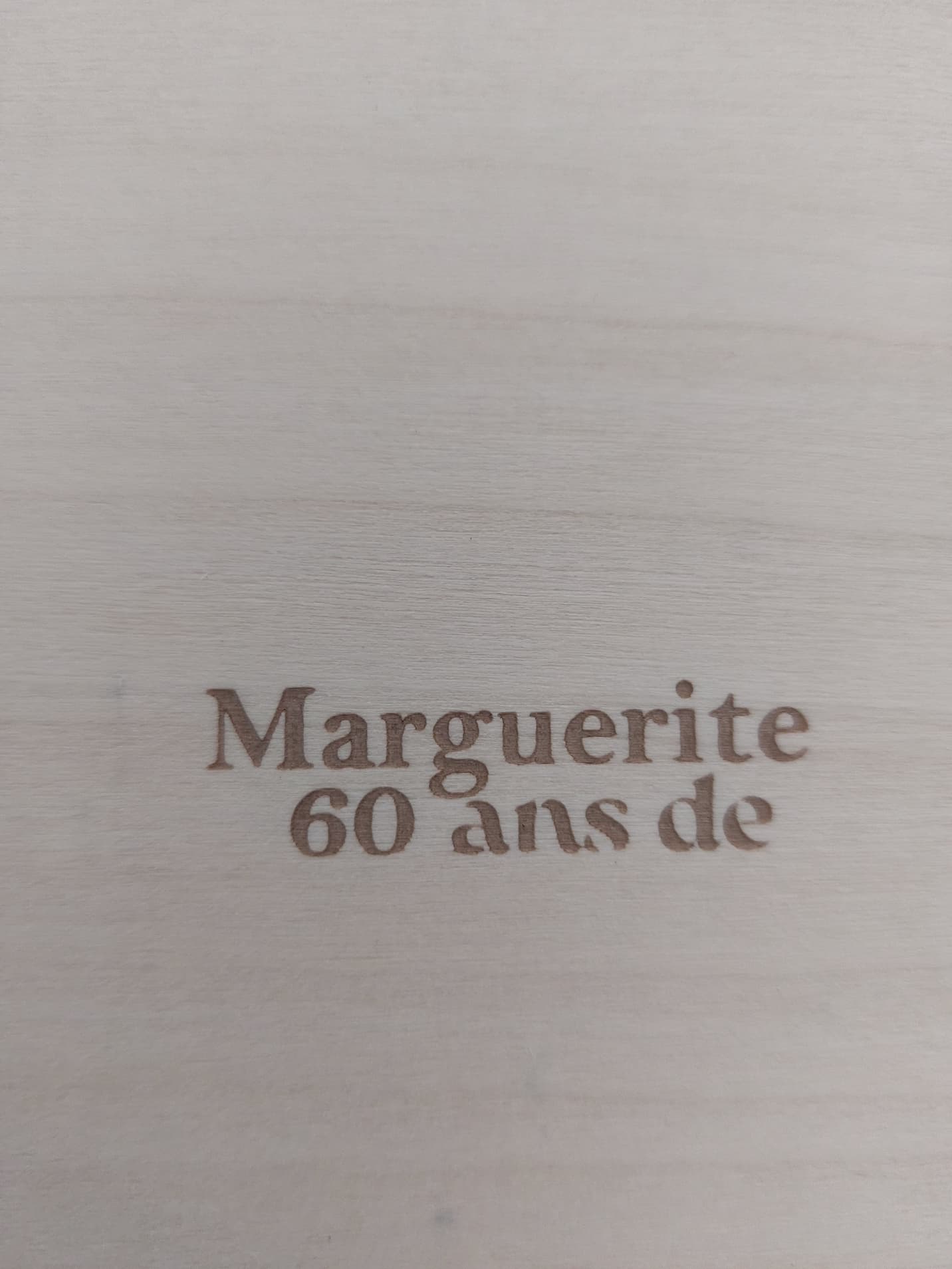

Here the good result from yesterday
And here what i got this morning (same file, no modification)

If the power setting is the same as yesterday perhaps it is the speed that has been altered (increased). The engraving this morning may be a little shallower than yesterday and less crisp.
Also perhaps the bottom photo shows signs of air assist being turned on.
Here is a new pic : to the left, the today’s result. To the right : yesterday’s result. Presests are exactly the same, speed and power. The difference is obvious, and affects the cutting line as well as the filling forms, since a 7mm/s x 74% line was ok for cutting yesterday ans is not anymore.
But you were right about the filling problem : is’t clear that the 100mm/s x 82% and 100mms x 90% (the 2 rectangles in the up right corner) is powerfull enough to get good filling.

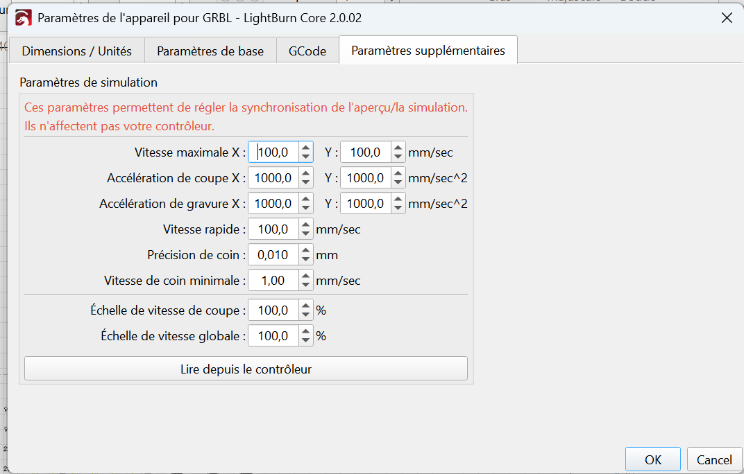

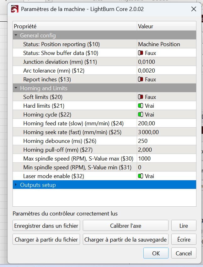

I may be wrong but would someone check the values in the screenshot of “Parametres de appareil pour GRBL”.
If I am looking at the same values listed in the photo compared to my values for “Device Settings”..then they are very different.

Your firmware and device settings seem to be ok. Do the wall test (create a picture of the beam spot on a wall) to check if the beam is disturbed somehow.

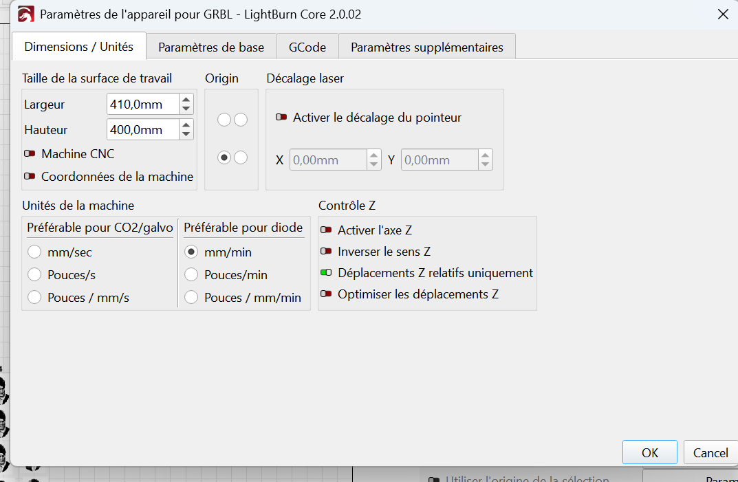

Todays’ tests : I tried to reset lightburn by deleting the prefs folder, but still nothing gets better. Here is a picture of the laser beam against a wall , also a screenshot of the file cutting and filling settings. Is it normal that there are two
I think you have a mix of mm/s and mm/min settings, which resulted in incorrect speed settings.
The values in your screenshot are insane and not possible for this laser. The maximum speed you can use is 6000 mm/min (100mm/s). Most of the layers shown in your screenshot are far above that limit.
Do a new material test with 6000mm/min maximum for engraving and 1000 mm/min maximum for cutting.

Awww ok, I’m gotta run another test. I guess I know what happened. I was disturbed by those mm/min. When I found the mm/s option, I was happy. I made conversions, but very badly, as it seems. Looks like I’m on the mm/s second brain-wired team. Thank you very much for the examples of passes and max speed infos, I was badly struggling with those. back soon with another test, wich will be correct I hope !
Oh I feel so dumb… it’s official, I was lost in conversion between mm/min and mm/s.
