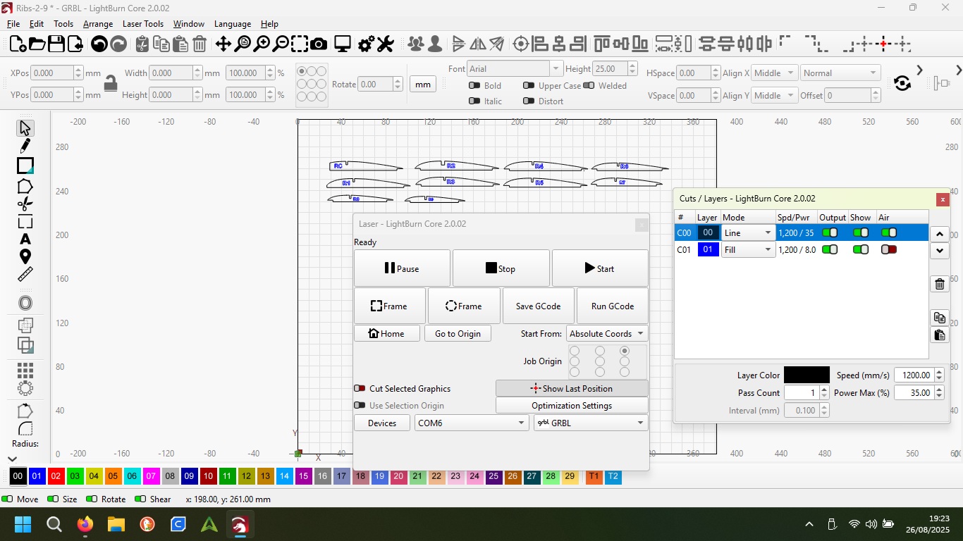

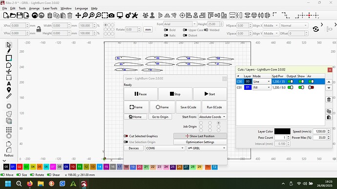

Please post a screenshot (not a cell phone pic) of your entire Lightburn screen with your project loaded and the Cuts/Layers Panel and Laser Panel visible. Also post a screenshot of the Settings Window (Gears icon) with the Units and Grids tab visible and post a screenshot of the Device Settings Window (Wrench and Screwdriver icon).

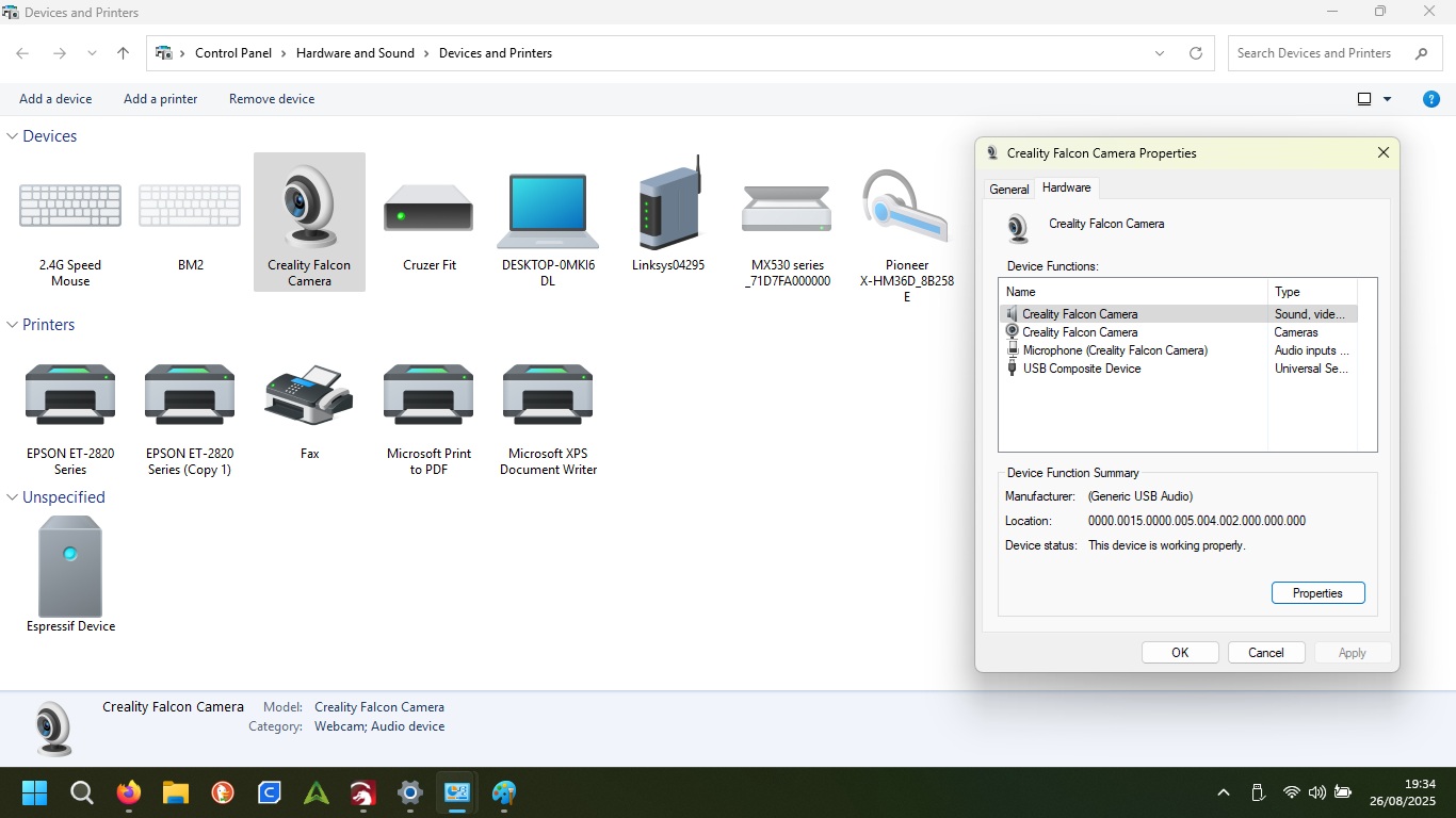

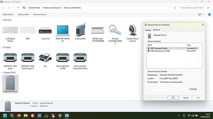

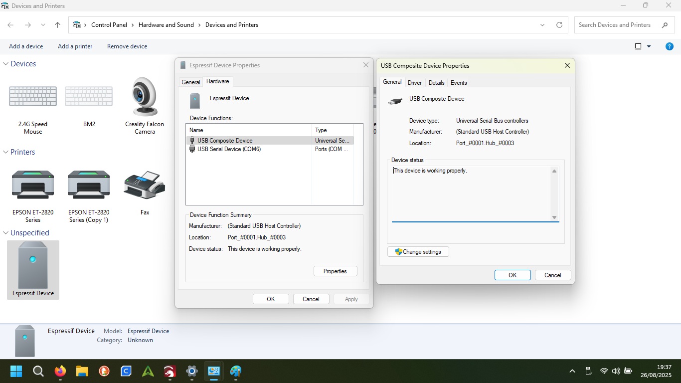

Hi Tim, Hope these are ok. Let me know if you need more.
I’m on Windows 11, version 24H2
Stuart

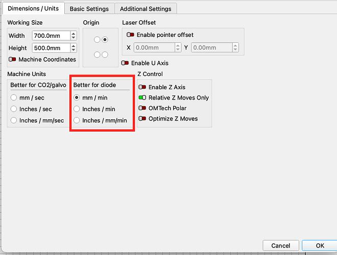

OK, that’s what I thought the issue probably was. You’re running in mm/sec not mm/min, that’s 60X the desired speed. Make the change in device settings (Wrench & Screwdriver icon).
Hi Tim.
That did the tick thank you.
I don’t remember hving to set that on my old unit and the old level of Software.
