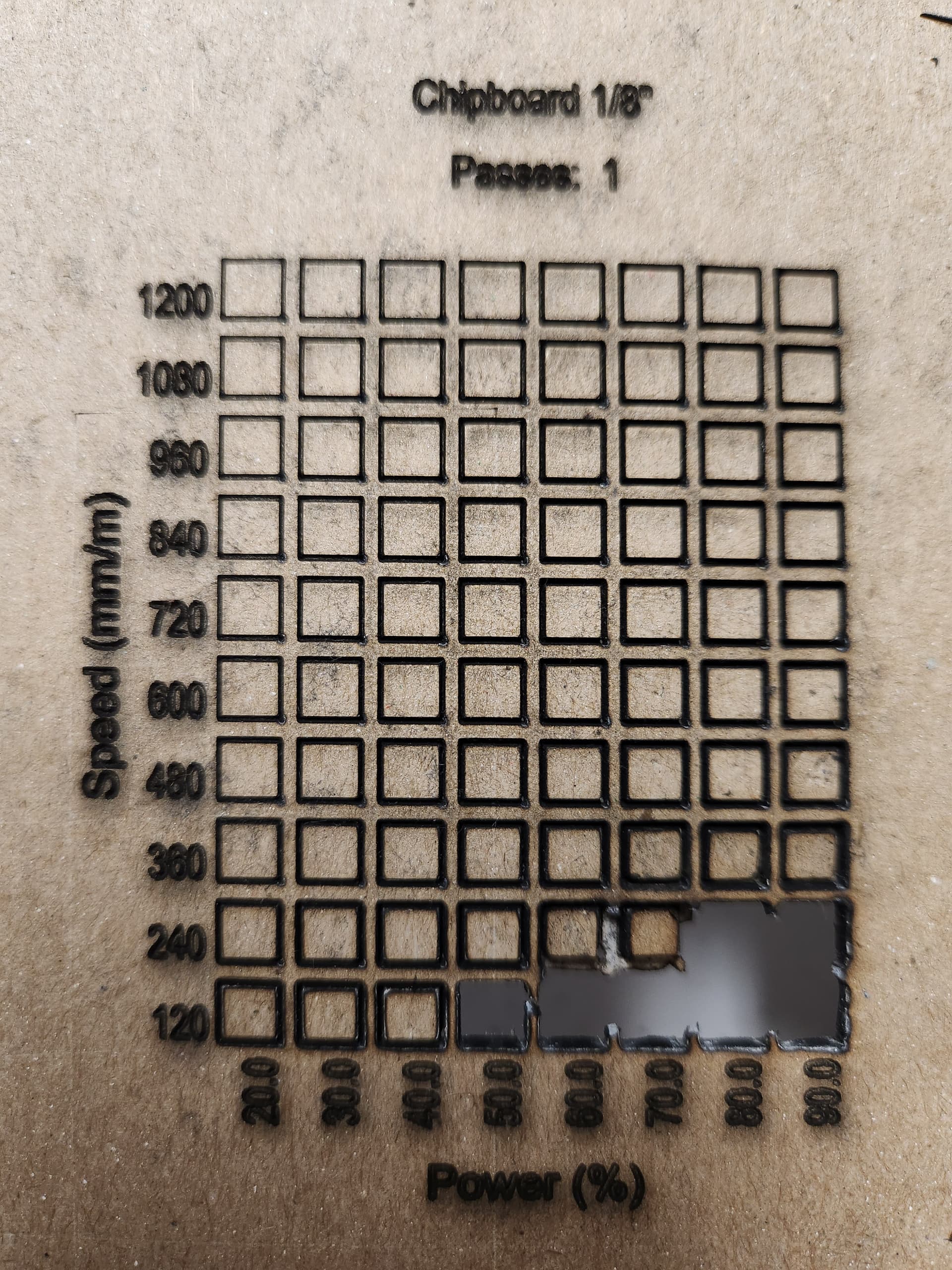

I am looking for power and speed setting advice for cutting 1/8" (3mm) Chipboard (like solid cardboard/ mat board).
New here, just starting to learn. Working with a Longer B1 30W on Mackbook Pro. Thank you!!

This was my material test, wasnt great. Unfortunately this chipboard just happens to be the required material for my Architecture design 4 final.
There is hope ahead;-) What you call chipboard, is it MDF? 1/8 inc. is about 3mm and your Longer B1 30W should easily be able to deliver a nicer result.
Check if your focus is on the spot, you have enough air support and position your material in a way that the MDF can get rid of the burnt residue, either honeycomp or small blocks or spikes will do this job.
Do another test with 850 mm/min max speed, I think you should end up between 300 and 400 mm/min, but I’ll see if I can find the test data from my Longer machine and report on it later.
But, concentrate on focus and air support in the first place.
Sorry for the delay, but 325 mm/min with a 20 Watts Longer diode laser, that’s the speed of “our” machine for nice results on MDF.
