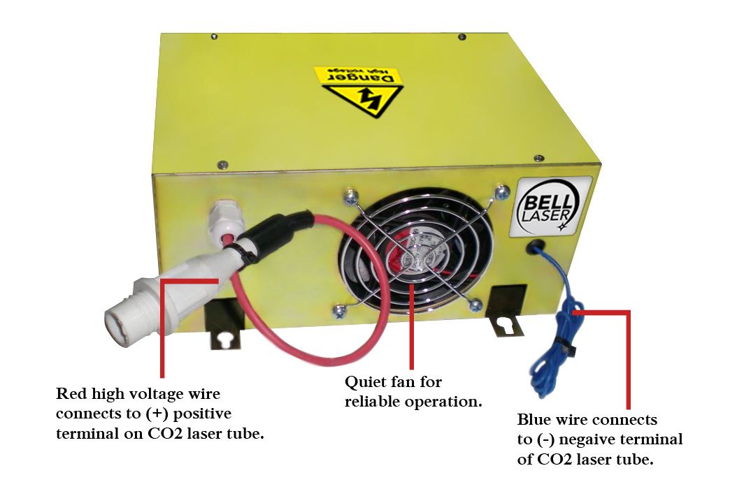

80% means nothing, unfortunately - the only way to know whether you are overdriving the tube is to measure the output current from the power supply. Your tube will have a recommended rating, and as long as you’re under that you’re fine. If your HV-PSU is outputting that power value at 100%, great. If it’s outputting that power level at 50%, not so great. :slight_smile: But you won’t know unless you have a way to measure.
Lots of people install a milliamp meter in-line with the tube so they can see it any time, or you can test / set it once, and be done with it.
