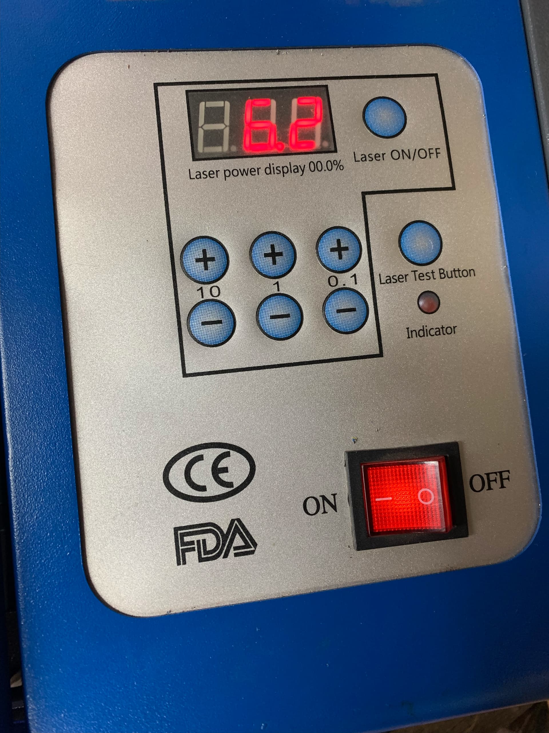

Does the version with digital readout & knob to control power still show power reading ( I read where you are suppose to set it 1000 & leave it alone)?

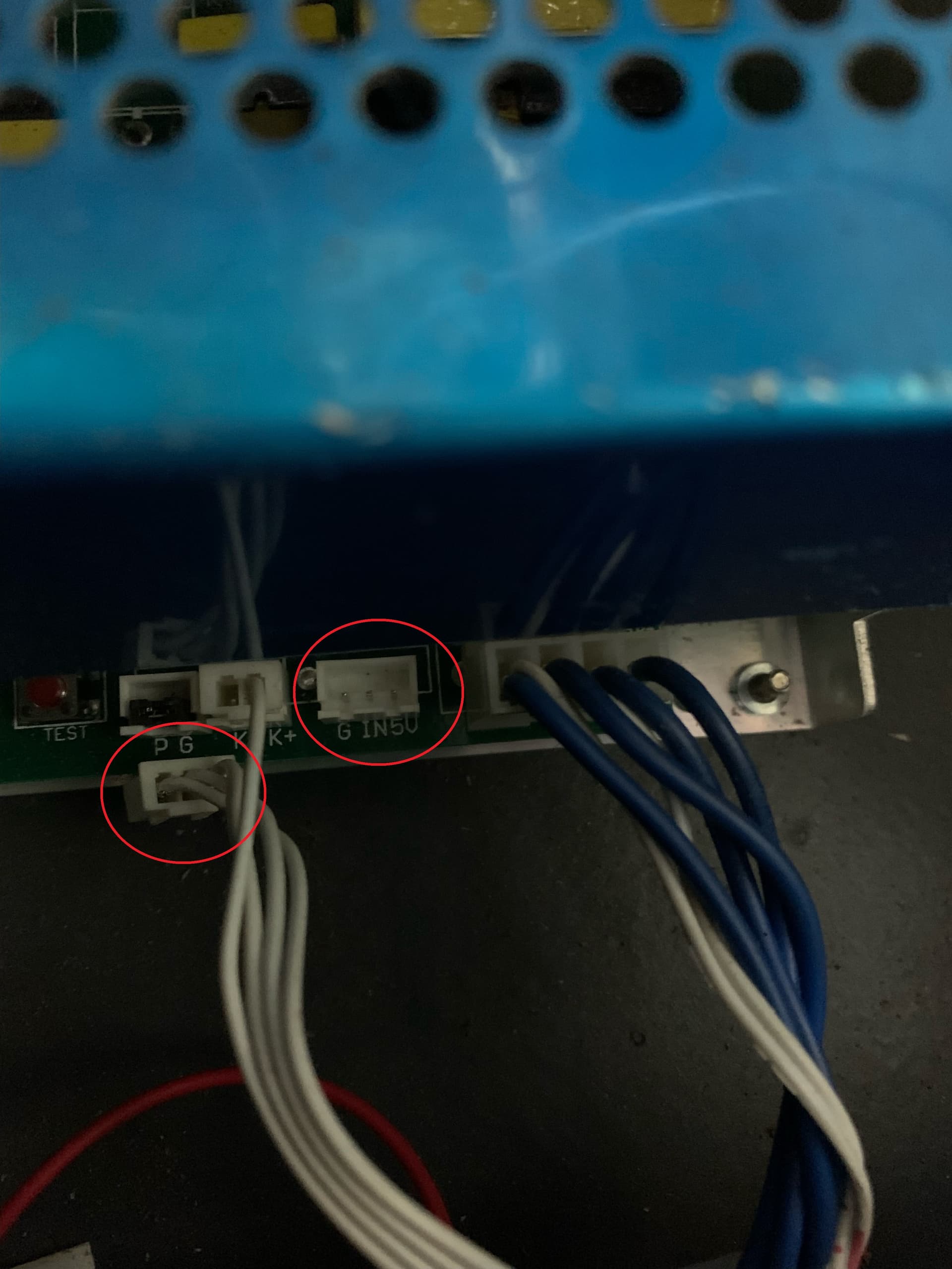

on mine the plug where the CBL Cable connects is where my digital panel is connected (G IN 5V)
When the CBL cable is connected I have no reading on the digital panel
I believe they’re stating that you cannot use the digital panel and the board at the same time which makes sense since it looks like they connect to the same connector on the laser power supply.

There are some units with potentiometers that plugin to a different port and can be used to attenuate power. Typically you’d set it to limit the top end of power and leave it there. I don’t know if there’s a specific value target.
Just confirm that the wires that are unplugged from the G, IN, V port lead directly to the digital panel.
Also, can you trace the wires from the controller PWM and GND pins and confirm how they are wired into G, IN, V?
Yes they are
G & In
the 5v on the power supply &24v on the board are empty

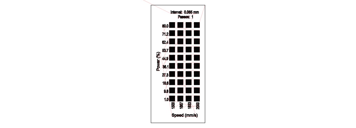

Create a large rectangle design in LightBurn, set speed to be fairly slow so that it gives you ample time to test voltages and enable Constant Power Mode so that variable power is not in play. Test voltage for at least 0%, 50%, and 100% power.

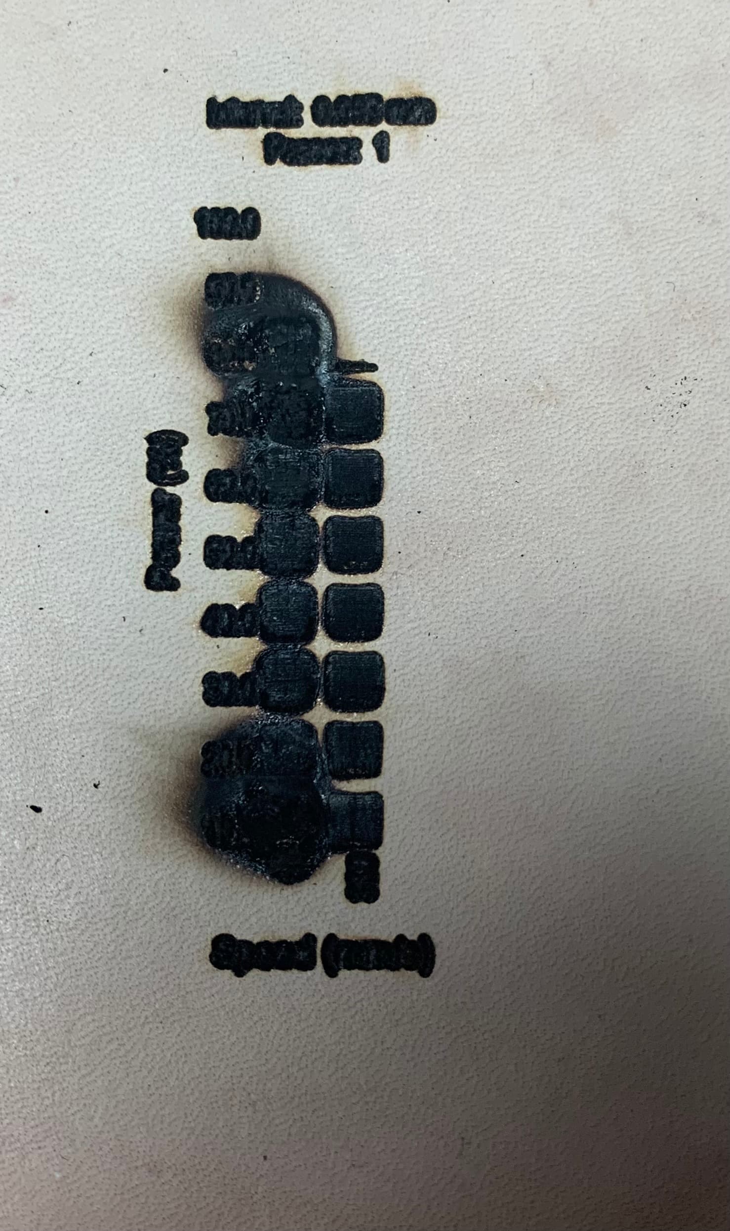

1st test (kinda scared me)

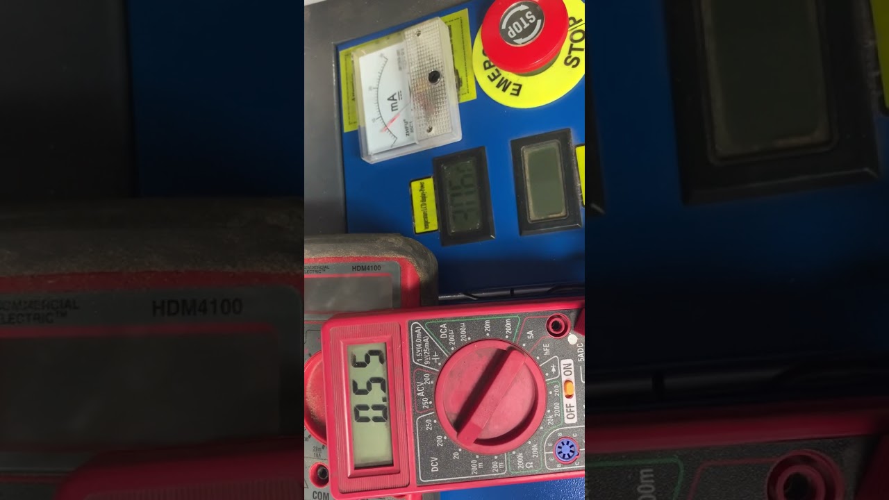

The volt meter was connected to the PMW Pins

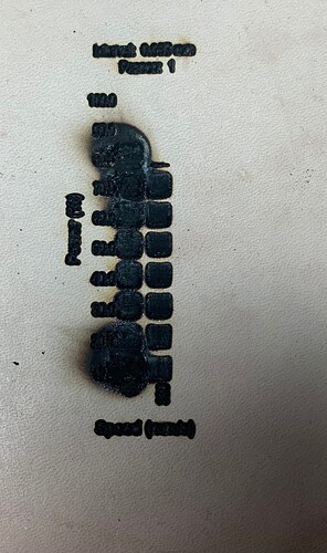

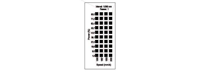

There was little change until the outline
the 1st test was burning thru @ 10%?

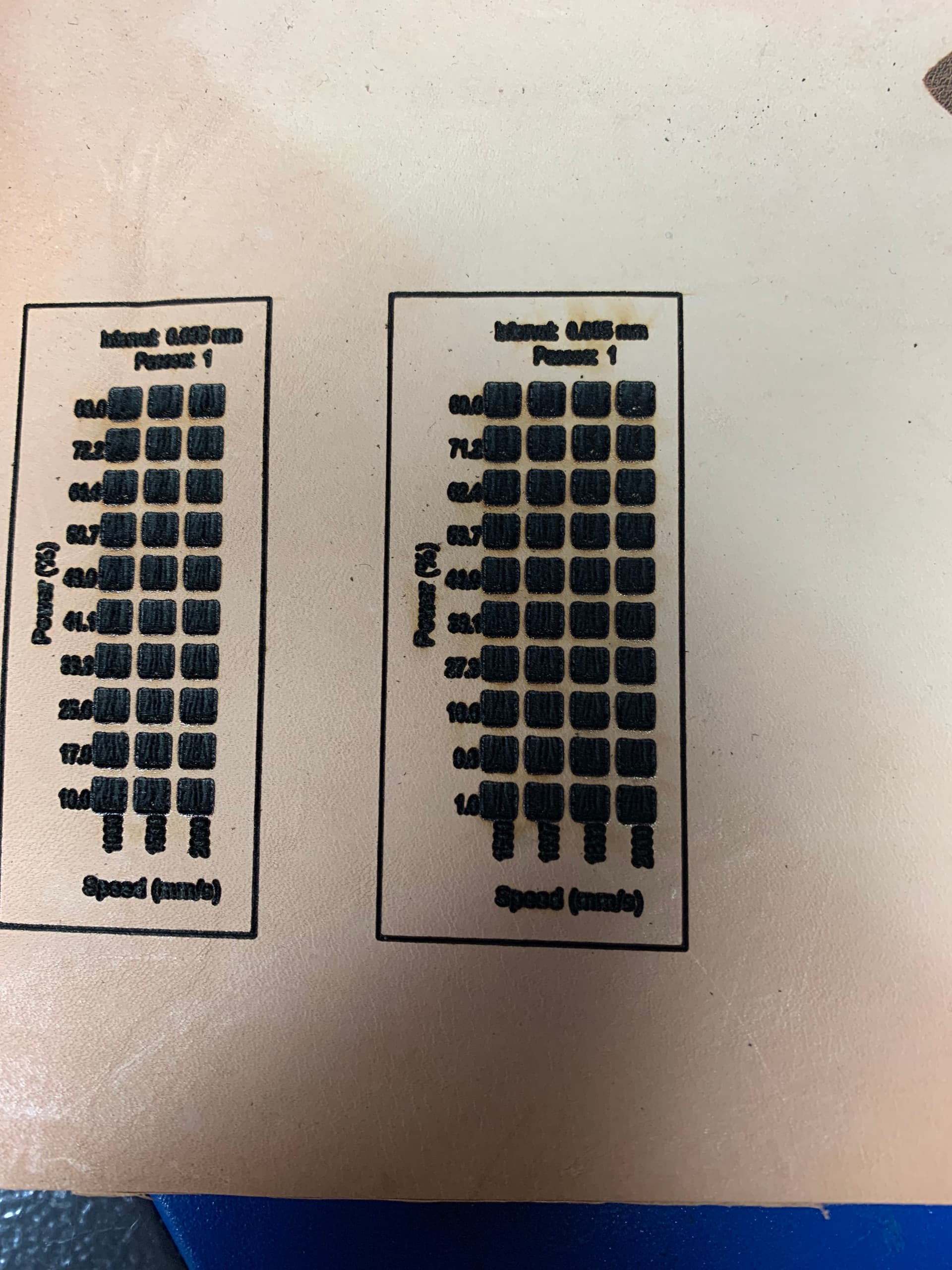

Draw a line in Lightburn. Set your power and run it slow. This gives it time for meter readings to settle and for a human to read it. The first video of the materials test, I can’t tell what the pwm is, so there is little use to know what the voltage and current are.
Using known values of a TTL (0 - 5V) pwm signal, the output of the controller has to be a percentage of that.
At 50% pwm (power), it should read 2.5V at 20% pwm it should read 1V at 80% pwm it should read 4V. Any power setting you use should produce that percentage of 5V.
If these are not correct, then the problem is before where you measure it. The controller, including it’s hardware, but more likely it’s configuration, including Lightburn.
If the voltages are correct, it’s after the test point, indicating a problem with the lps.
I’d suggest reading it off the lps IN pin. If it works there, you’re done. If it fails, you can disconnect the lps connector with this signal and read it off the controllers output. It should not change between being connected and disconnected state.
