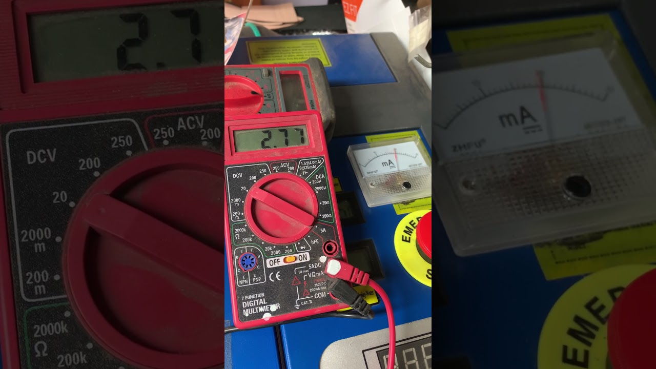

vm connected to G & pmw on the board
connection disconnected from power supply
laser was still firing
0% 0v
10% 1.0v
20% 1.46v
30% 1.91v
40% 2.37
50% 2.77v
60% 3.23v
70% 3.68v
80% 4.14
90% 4.59
100% 5.05

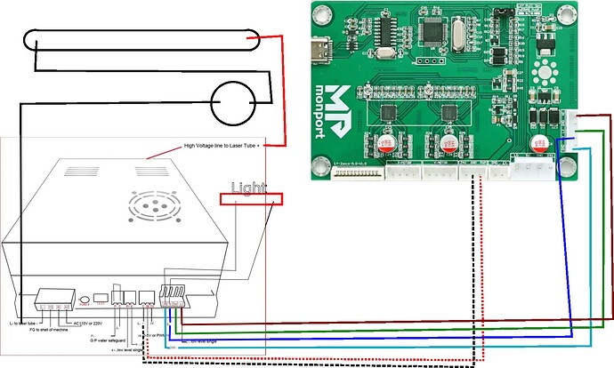

Can you create a wiring diagram that shows how your laser is wired?

Did another test today
Cbl (Control wire disconnected & Then connected
% V MA V MA
0% 0 0 0 0
10% 1.0 16 1.01 8
20% 1.46 16 1.46 12
30% 1.91 16 1.92 15
40% 2.37 16 2.36 17
50% 2.78 16 2.78 19
60% 3.23 16 3.23 22
70% 3.68 16 3.68 25
80% 4.14 16 4.15 27
90% 4.60 16 4.61 30
100% 5.05 16 5.05 30+
the voltage reading when connected seemed very close
i think the differences are just a flicker one way or the other
got a picture of wireing (not my best work?
Voltages look good.
It’s interesting that you get steady 16mA when PWM not connected but some power modulation when connected.
Based on the wiring diagram I don’t see this is working.
Can you revisit some of the areas? I suspect at least some of it is incorrect.

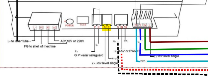

Check if the wires on these 2 ports are not misdirected:
Also, can you check what’s going on with K+ and K-?
In one of your previous pictures it looked like K+ might have been plugged into something. Also, K- and K+ on the diagram seem to be labeled opposite of what’s on your machine so that’s interesting and something to watch out for. I believe these are commonly connected to a test switch on the control panel.
Is the “Light” that you have showing in the diagram always lit when the machine is on?

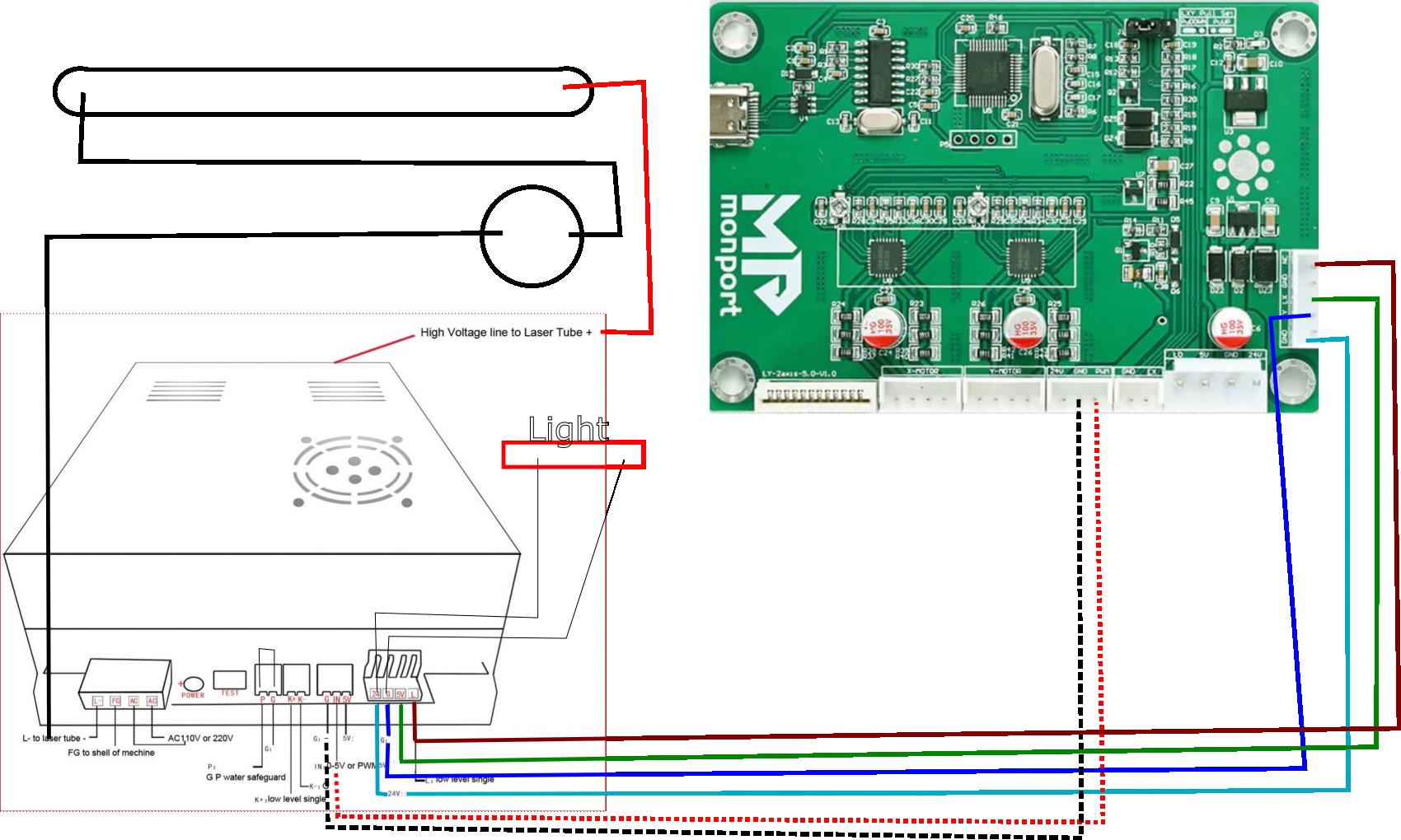

Sorry I picked the wrong port on the pic.
all my wires are blue :o(
(wire in my drawing)
red goes to Lo
green to 5v
blue to gnd
light blue to 24v
K+ & K are reversed, (i used pic. off web)
there is only 1 wire in that plug goes to K+ (i believe goes to the test fire on the digital panel, it was not connected for the test, it will only function if the connector from the digital panel is also connected to GIN5V )
