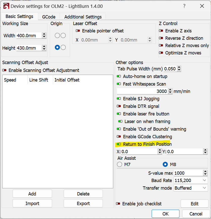

For confirmation, are you doing this with the “Return to Finish Position” option in Edit->Device Settings? Or is this something else?
yes i have that set berain

The position after that homing operation is defined to be the “home position”. Setting Return to Finish Position will return to that spot.

I think I’m not making myself sufficiently clear on this. It should not, as in it ought not and will not engage the switches as-if it were going through a homing cycle.
It should only reposition the laser to go to the location specified in “Return to Finish Position”. This is typically 0,0 which is being loosely referenced as “home position”. It should not execute a “homing operation”.

I don’t know if I got everything correctly now, but here is another remark:
The homing function in grbl offers some compensation for switches that usually have some hysteresis (different activation and deactivation positions). That’s called “homing pull-off”, controlled by parameter $27. This is usually set to 1mm, I think at the S30 firmware it’s 3mm by default. This means, after a homing cycle, the laser is moved that distance back into the workspace to make sure the switches are released properly. Because if you hit them again they might trigger a hard limit alert which stops the firmware. Now, the different firmware versions behave a little different. Some versions set the position to 0,0 AFTER the pull-off, some BEFORE. So depending on that, you might have 0,0 as position after homing or 1,1 or 3,3 (depending on $27 setting). I think I had some cases where this behavior also created some repositioning error (though in theory this should not make a difference in absolute coordinates).
