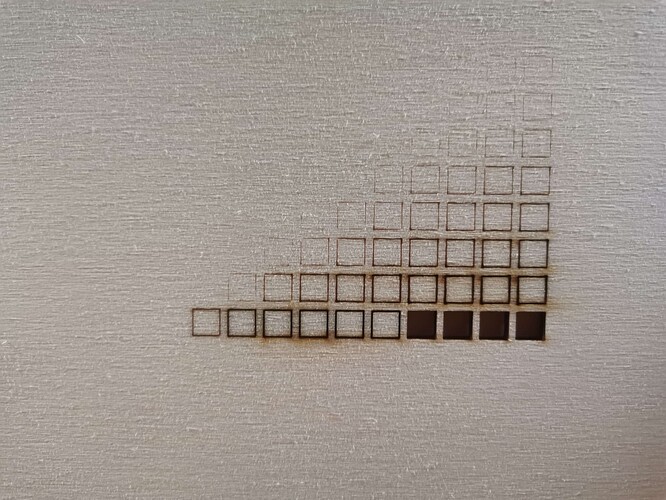

Hi, I have a Longer B1 30W laser and I’ve encountered an issue, as shown in the attached photos.
In the first test (grid), the engraving/cutting is not uniform.

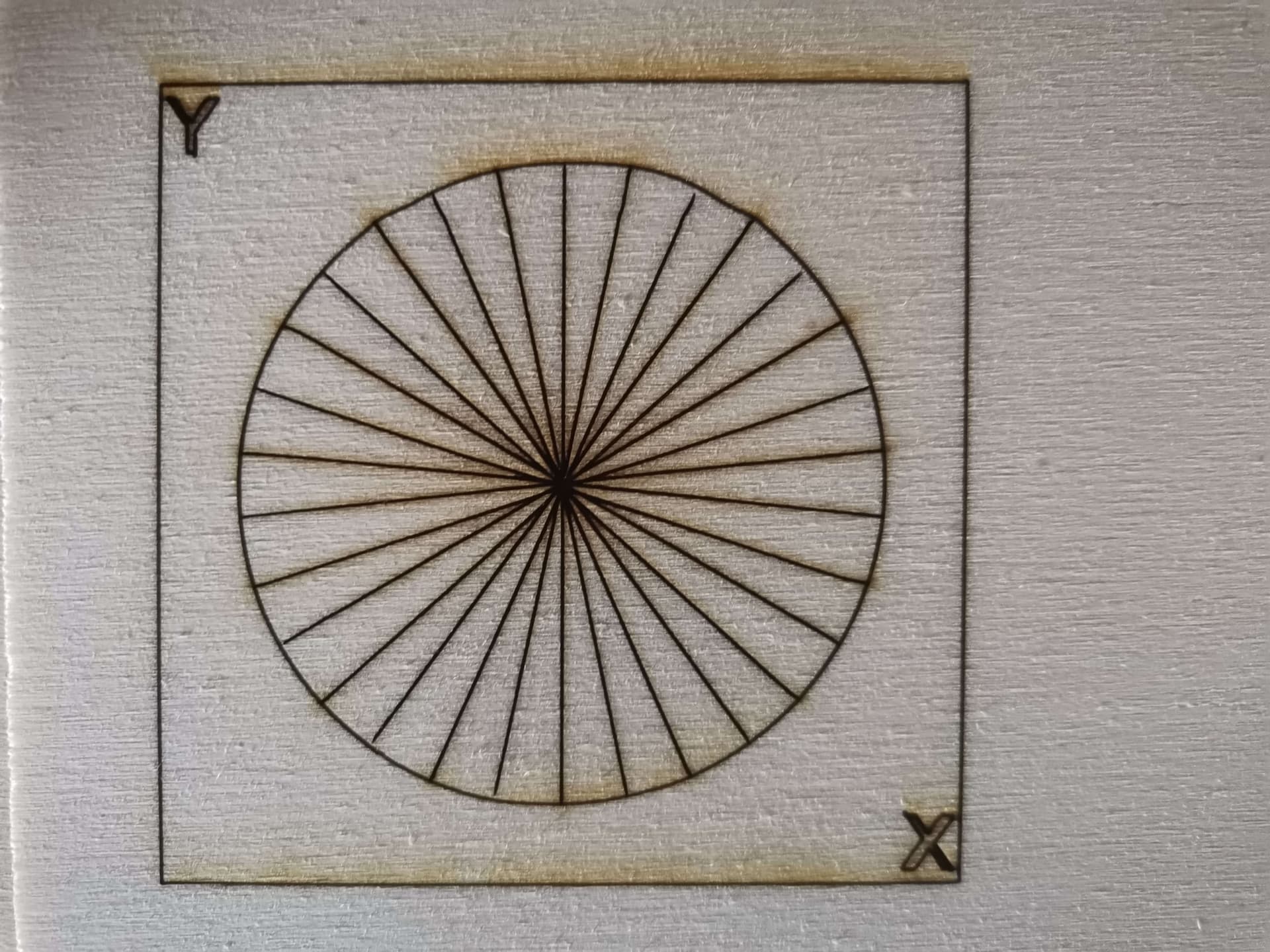

In the second test (circle inside a square), I noticed that the circle is not perfectly symmetrical.
Questions:
:red_question_mark: Has anyone experienced a similar problem and found a solution?
:red_question_mark: Could this be an issue with the Y or X axis not being perfectly perpendicular?
:red_question_mark: What are the best settings to adjust to eliminate these inaccuracies?
I’d really appreciate any advice! :wrench::fire:
I’m attaching photos for better visualization of the issue.

Don’t know how you made these… but I’d say you have a loose belt causing the variations in lines.
That’s about all that can cause this without everything being bad…
Good luck
When I first set up my Longer Ray5 10W I had similar wavy lines and irregular circles because the two belts for the Y-Axis were at different tensions.
All the best
I have already tightened the belts, but I think they might still be a bit too loose. I tried to make them as even as possible, and it seems slightly better now.
