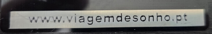

Hello everyone.

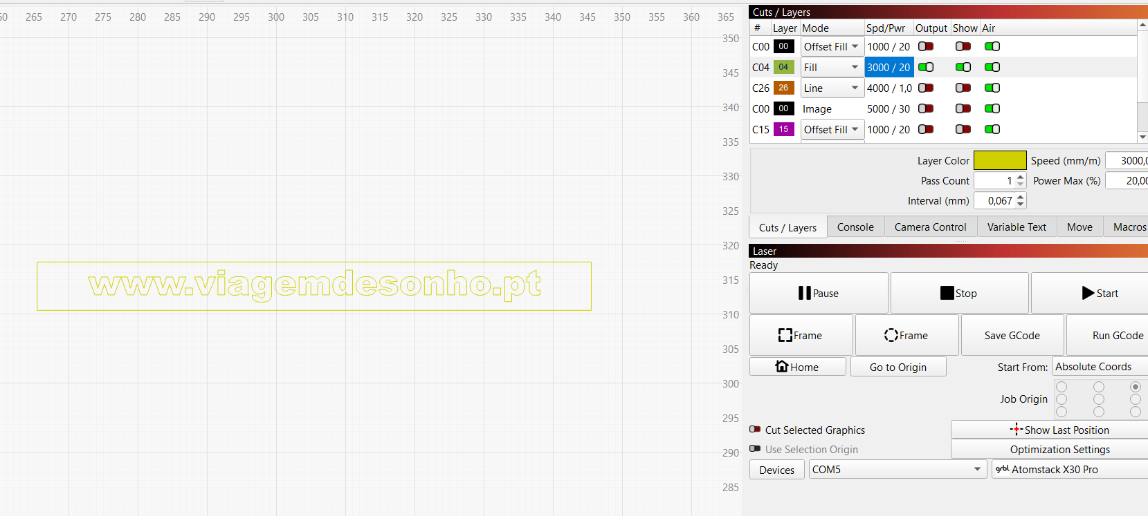

Im a newbie into this. Starting to understand settings and trying to get it as better as possible.
Im trying to engrave some texts. And i cant get it even closed to what i want.
Already tried lots of combinations with overscanning lines per inch and some other things, and i always get blurred letters.
Any idea how can i try to make it look better?
This is 0.2mm thick aluminum sheet.
Thank you for your help !

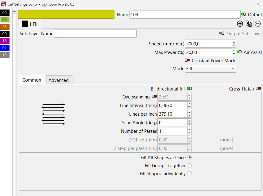

I would suggest first getting rid of the commas in the speed and power, Line Interval and lines per inch.
Speed 3000
Power 20
Lines per inch 379
Line Interval .0670

Anyway, @jkwilborn this are aluminum sheet that i buy already with this “black mark”. They are completly black like that, and im just trying to engrave it.
It looks like everything i do, i have to do it really slow. Im even trying to engrave wood, and for me to have a good quallity in my letters, i have to set the speed like 1000, or lower, or ill get letter like that one.

Interval 0,05

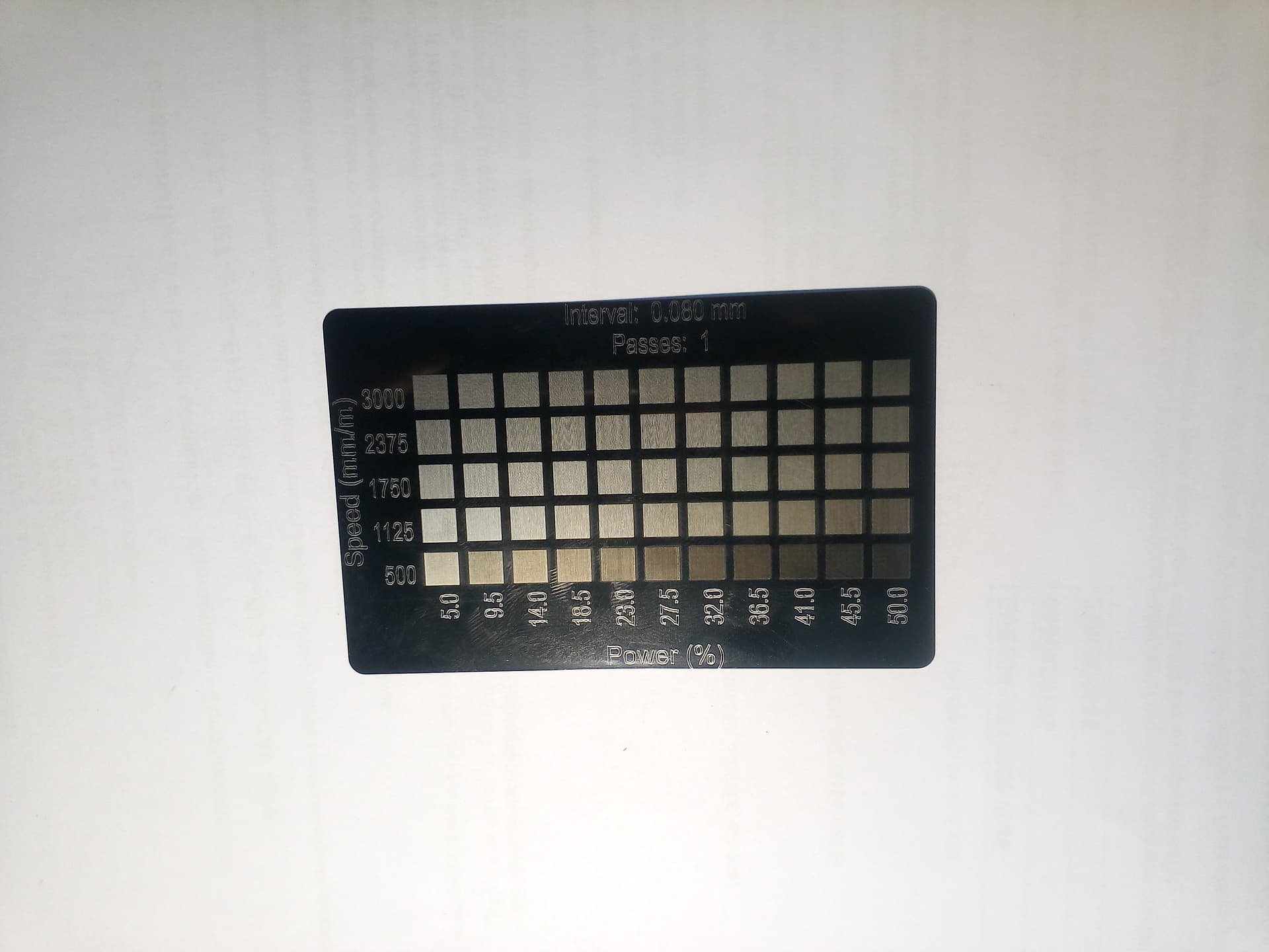

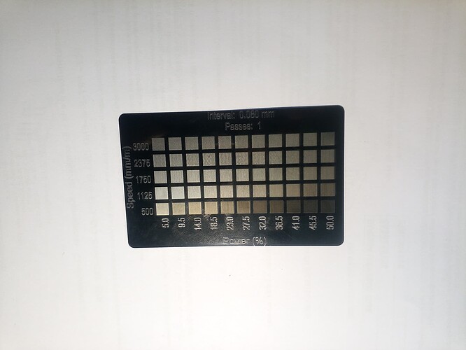

But according to a material test I did, with higher powers, it can create discoloration. :wink:
I don’t know how the engraving was done, but it may have been with the text inverted and only the outline was “burned”. :thinking:
Is your aluminum card really flat?
Forgive me but it’s early morning and I didn’t understand if the question is for @jkwilborn who copied @TinoVieira’s photo or for me who published a material test image… :thinking: :laughing:
Oh sorry it was for you, bad manipulation, have a nice day.
No problem!!! :+1: :wink:
To answer your question, yes, perfectly flat (taken from a batch of 50 cards) sitting on a honeycomb base. The optical power of the laser is 5W.
Hello, your DPI seems a little high on a TS2 10W I use 317 DPI. 0,05 en intervalle de ligne ,vitesse 1000 et puissance de 20%,bien entendu ,c’est pour 10w et je dispose de l’autofocus. 3000 de vitesse sempble un pzu élevé, va peut entraîner de légers tremblement si vous avez un léger jeux.De plus il est primordial de bien prendre le temps de regler les deux voir les 3 axes,de bien netoyer les roue de guidage a chaque utilisation. Cordialement

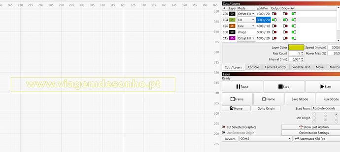

In this case, it looks like my problem is trying to do it “inverted” ( dont know exaclty if its the correct way to say it ). So, the card is black, and i would like to engrave it in a way to leave letters in black.
@Kuth there in your picture how did you engraved the letters? “Line” and what more ?
I would do it exactly the same way: create a rectangle and create the text inside it, set both to “Fill,” and then reverse the engraving. This way you should get the result you want.
This certainly wasn’t the first material test I’ve done. I’ve probably done others (I don’t remember, but it’s typical) and I made the most of it.
With the letters I simply set the settings in the “Material Test” tool that Lightburn provides to “Line,” as you mentioned, and probably the power to 9.5 and the speed around 1750.
Meanwhile, I was reading a review of the machine you have on your profile and I realize you should adjust your settings. The speed already seemed too high to me, but since it’s a machine from a reputable brand, I assumed it had better performance than mine. However, in the review I saw (if you jump immediately to minute 4.23), you’ll notice that the speeds are much lower.
Another thing I noticed was that the laser’s focal point is 0.1mm, and you have 0.067 in the layer settings (this is basically half the “resolution”). If you put two 0.1mm points spaced 0.6mm apart center-to-center, you’ll overlap, and it probably won’t work as expected.

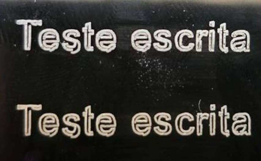

Anyway, i think that maybe this is a mechanic issue?
Just see here … it looks that it doesnt even follow lines properlly. That was with a speed set to 500(top) and 1000(bottom). So i dont even thing that this is a speed issue.
What you think?
