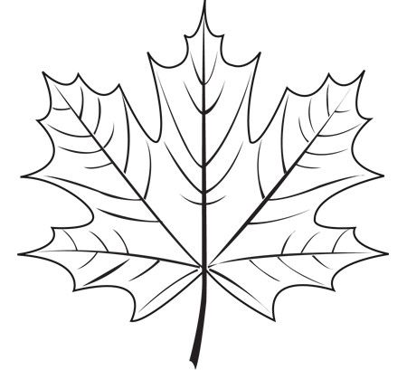

The outline of the leaf is not a closed shape when using center line trace
The outline of the leaf IS a closed shape when using just trace.
It would be better if the outline of the trace shape results in a closed shape.

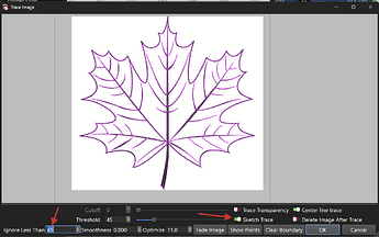

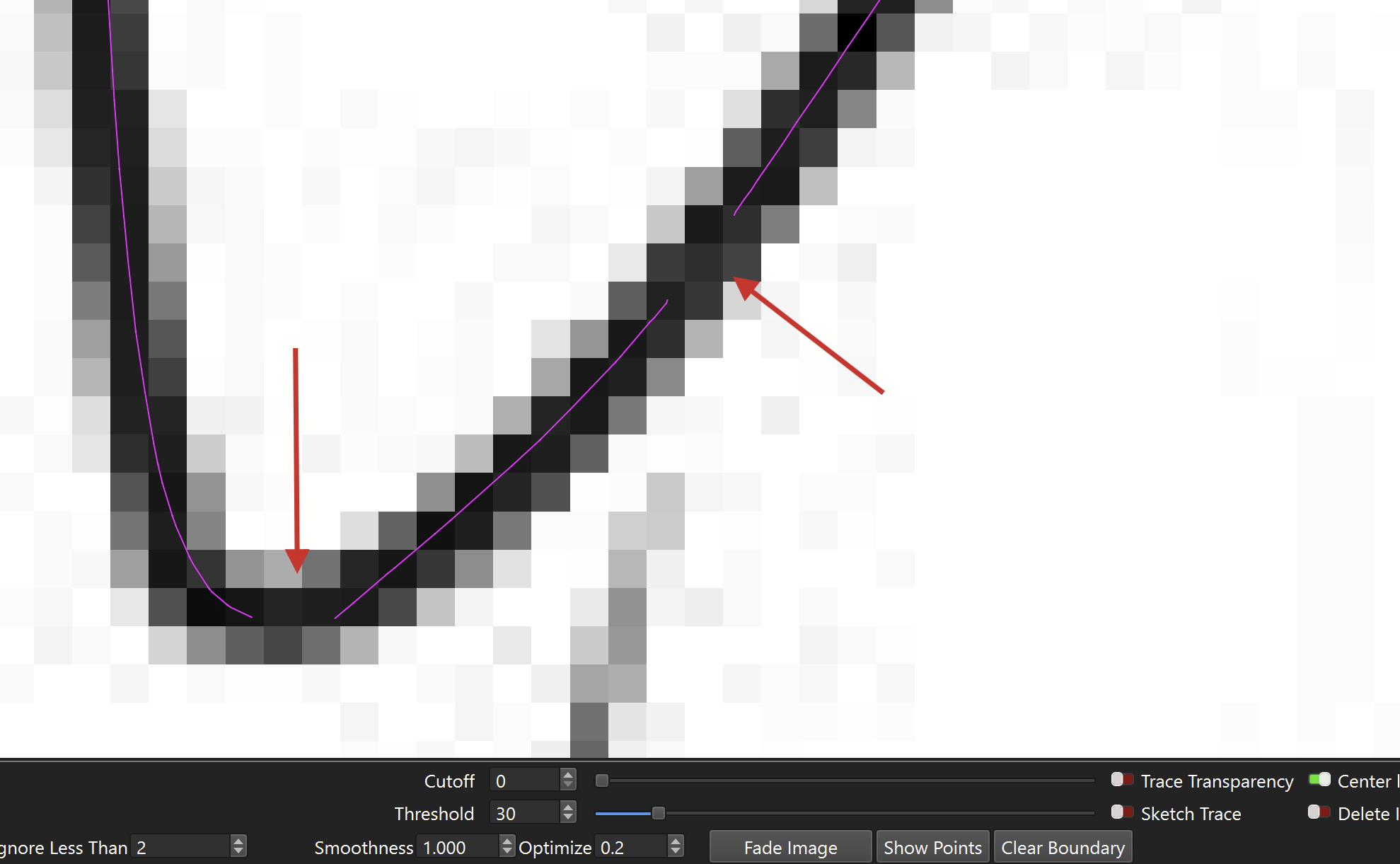

The source image is quite a low resolution. Depending on the “Threshold” setting, it will skip some pixels if they are not true black:

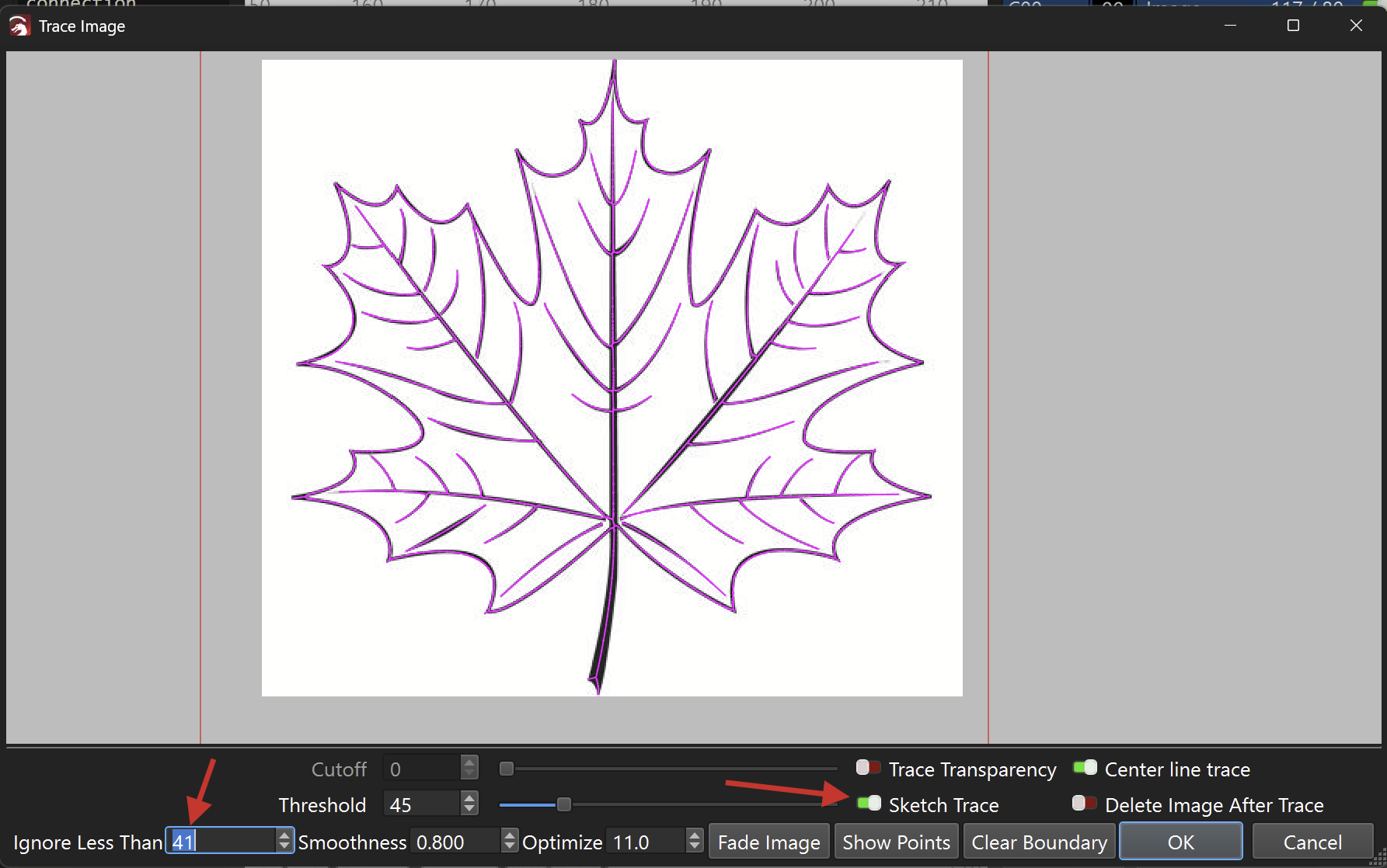

I got decent results by enabling “Sketch Trace” and adjusing “Ignore Less Than”:

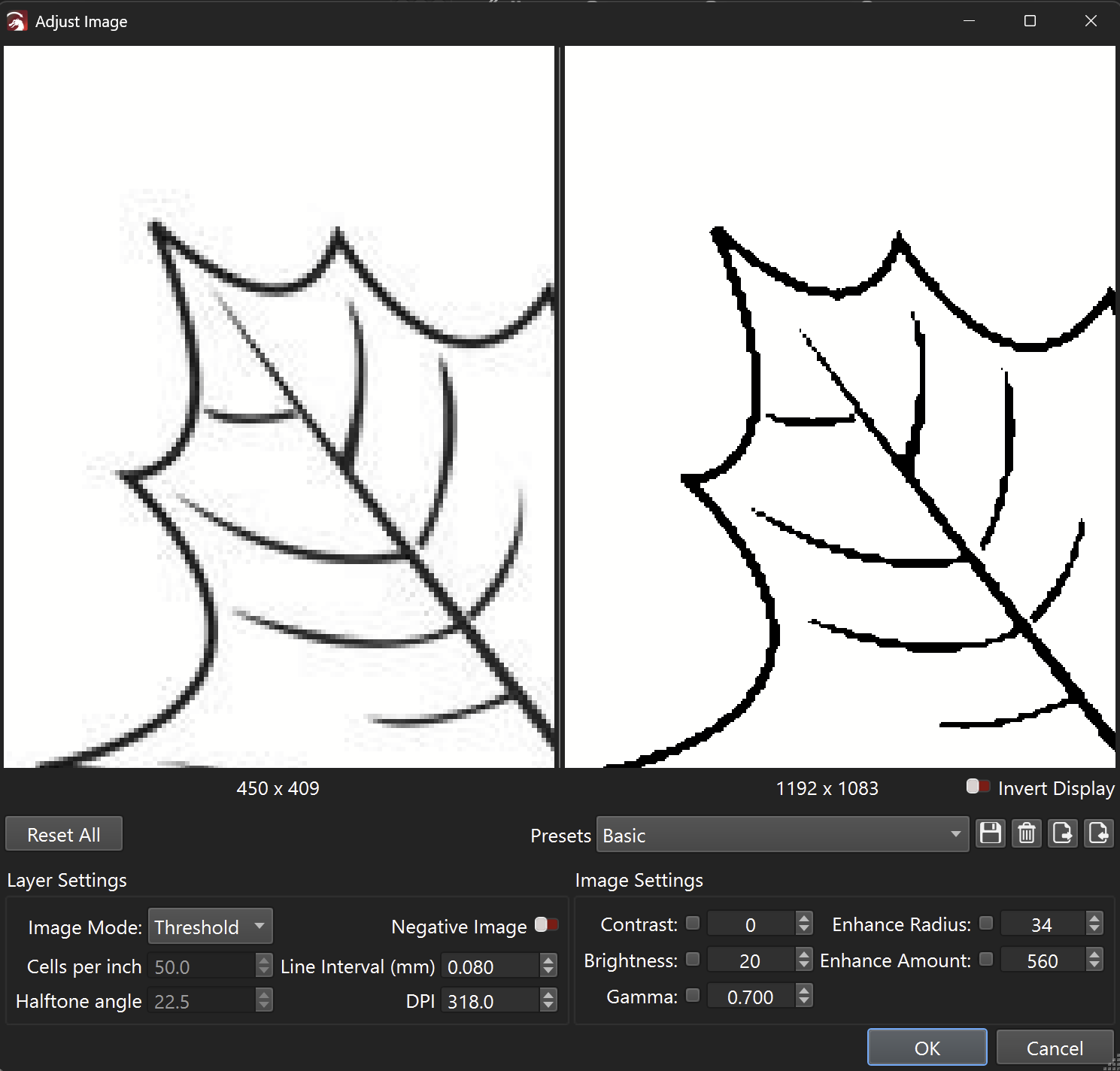

Adjust Image can also help to prepare the image for tracing:

This is from a 1200 DPI tiff file. Yes it is better, but the outline isn’t a closed shape.

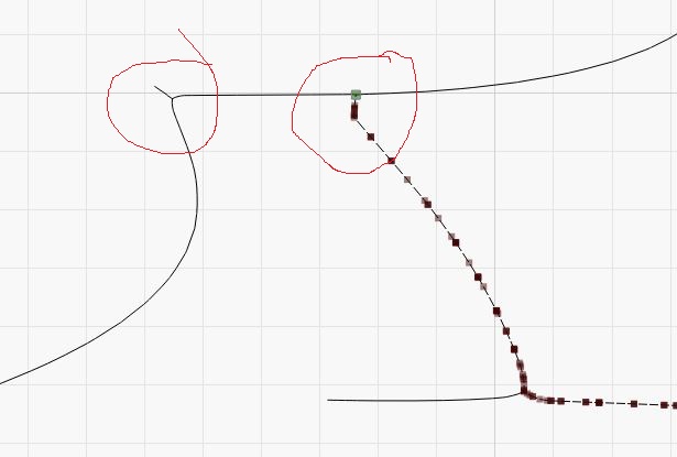

Cleanup work needed. Break the T-joint and remove all the leaf tip spikes.
