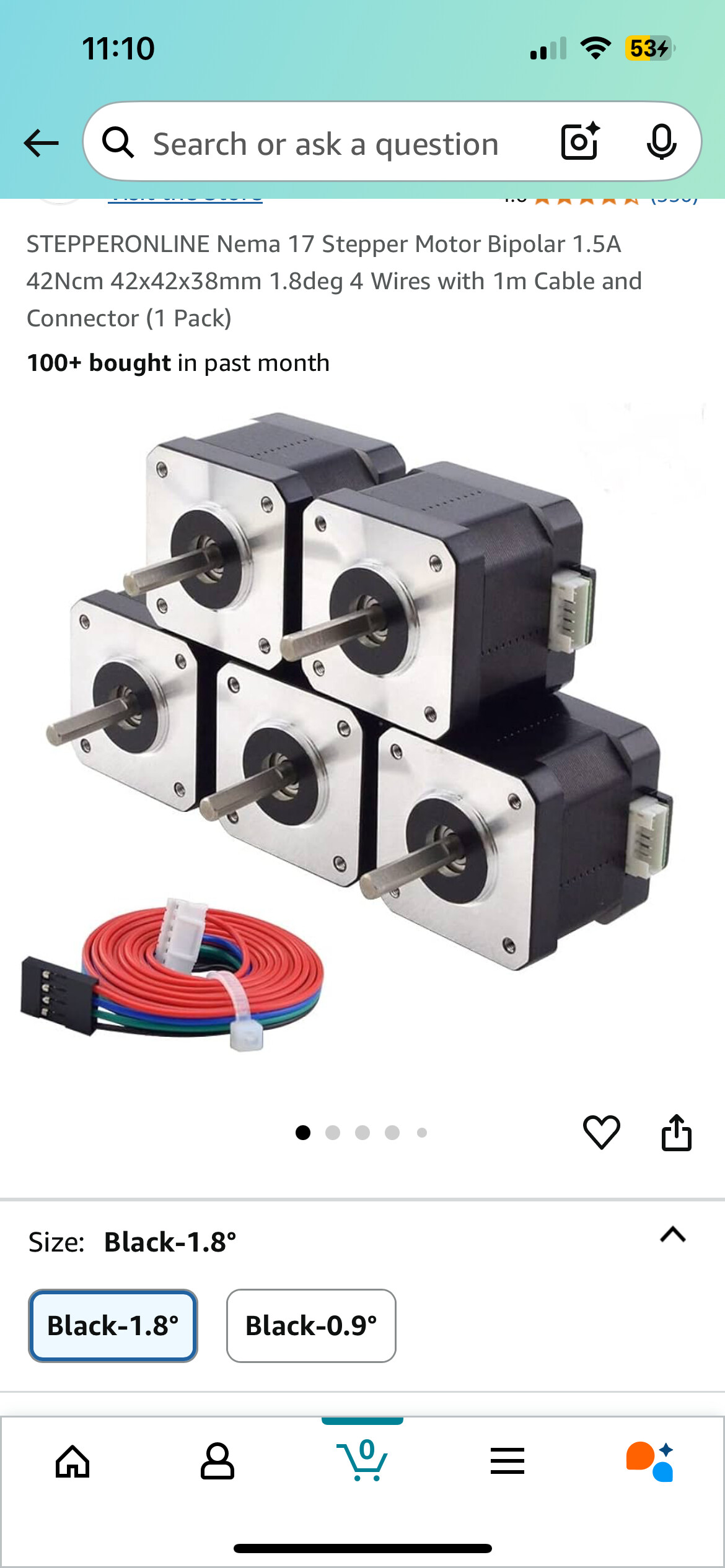

There are current limiting settings on the motor driver. Check your type of NEMA motor and see it’s maximum current.
A NEMA17 is 1.7" across each side..

This is a direct replacement for the stepper motor on the rotary so I ordered one because it’s super cheap, thank you for helping me so much today haha whoever put together the drive panel on my omtech is awesome, I figured it would be a mess in there but everything is organized and well labeled
