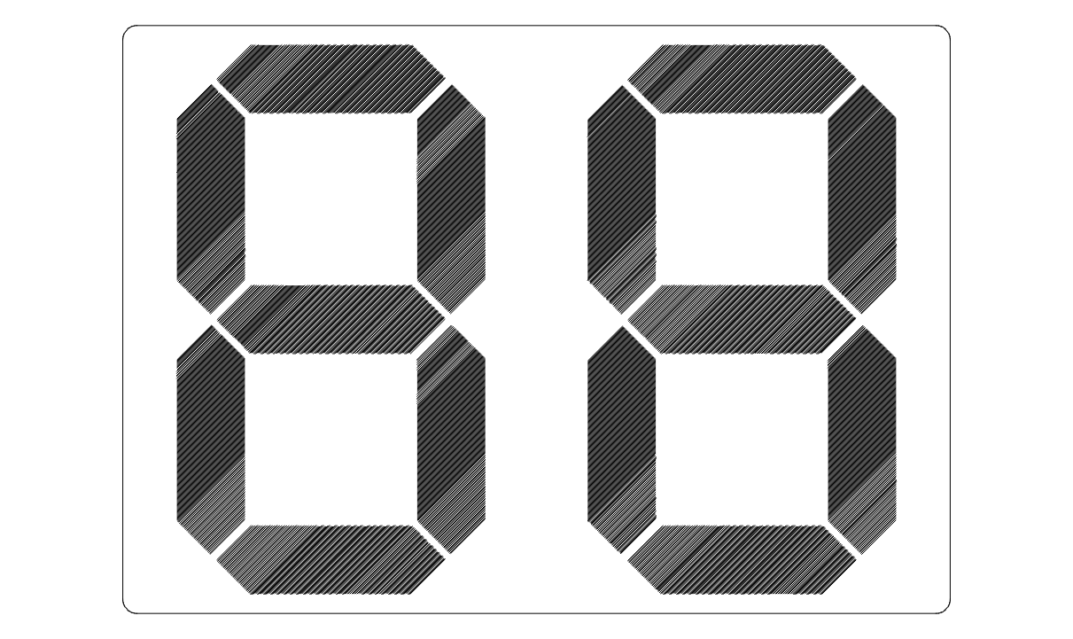

I’m filling some relatively simple vector shapes and want to see the effects of different fill settings. If I set the scan angle (that really should be Fill Angle shouldn’t it?) to anything but 0 or 90, I get some really weird shading results. At first I thought that is was a bug, then after playing around with the settings I concluded it’s a Moire effect caused by interaction with the monitor refresh. Is there a way of avoiding this?
I am trying to visualise what the engraving would look like at different settings and the interaction with the monitor refresh makes it impossible.
The settings for this preview were - Lines per Inch 100, Scan Angle 45 degrees

After a bit more playing around I’ve found that I can turn the Moire effect on/off by selecting/deselecting antialiasing in Edit / Settings. This setting does get set/reset by changing between smooth and coarse options in the Window / View Style menu.
Does anybody else see these Moire effects during preview? A simple filled rectangle will show it if I have antialiasing turned on and the Lines per Inch set between about 80 and 150.
