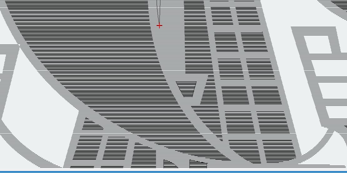

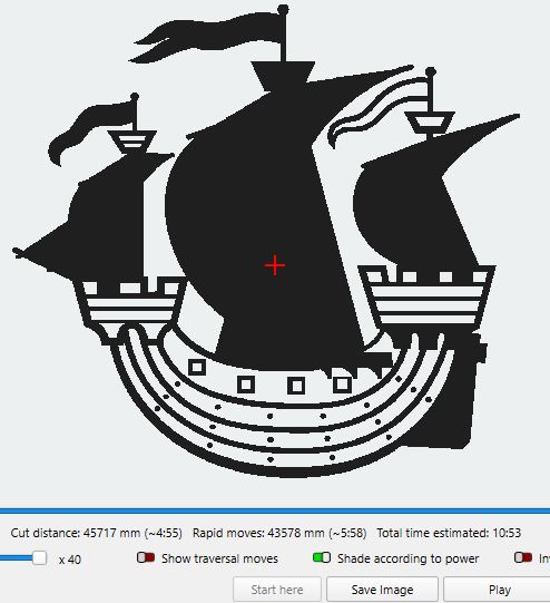

core 2.0.05, i have run this file before and it showed all layers in older version preview , but only shows as black mass now unless i zoom way in , is theer a setting they may not be active that im missing , i have done a test run and it engraves at the diffrent power setting as should , just not showing clearly in preview
What you show here is what I have always seen. If you reduce the LPI to a smaller value, you will see it look more grey.

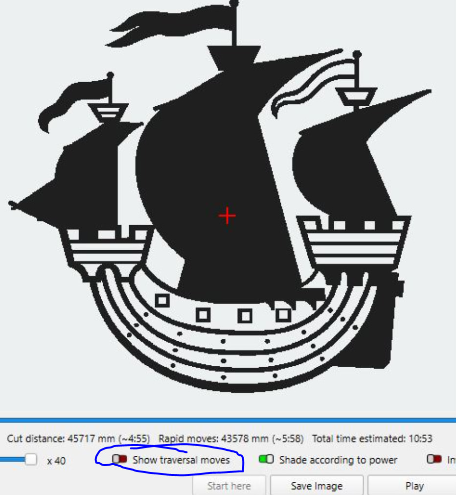

If you enable Show traversal moves maybe you can see your shapes better.
