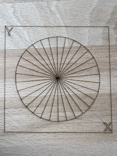

Dot Test with Angle.lbrn (46.3 KB)
Run this for me please
Send you the result ?
yes please upclose picture if you can
this good ?
mmm you have a little issue with your bottom end, is marking on the traverse movements
Also… your Y belts seem a bit loose
Notice how the Y right side is a bit wonky and your Circle is not a circle but more an oval
But 1 issue at a time
a) what GRBl controller have you selected GRBL or GRBL M3
b) edit _> device settings. Svalue Max is set to?
c) you need to review your belts
d) if you can. on iddle what reading you get measureing GRD + PWM

Hello again, am I back ? :smiley:
Unless we are both alucinating. yes you are!
they upgraded me to a trusted user, I was a newbie before :smiley:
Shall we continue ?
sure thing! what have you gotten set?
a) It’s a GRBL
b) It’s 1000
c) It’s my first time doing it so I have to search how to actually do tha
d) What I need to get from it ?
Belts is easy
Take a couple pictures of your belts
As per PWM test with multimeter
If able, take a multimeter, measure the GRD + PWM combo while machine is ON but not engraving
You should get a 0V
Then try 1% (fire button)
You should get 0.3v
If you dont get 0V on iddle, something is leaking voltage into your PWM so make sure is correct and no wiring needs review
Should I take them out / dissasemble the machine, or just like take a picture ?
I get 0 V on idle, 0.4 ~ V on 1% power.
this is odd, which means your machine should NOT engrave while moving across and yet it is
Something obvious might show on belts
What can I do about that
The belts are really dirty, maybe that’s the problem.
