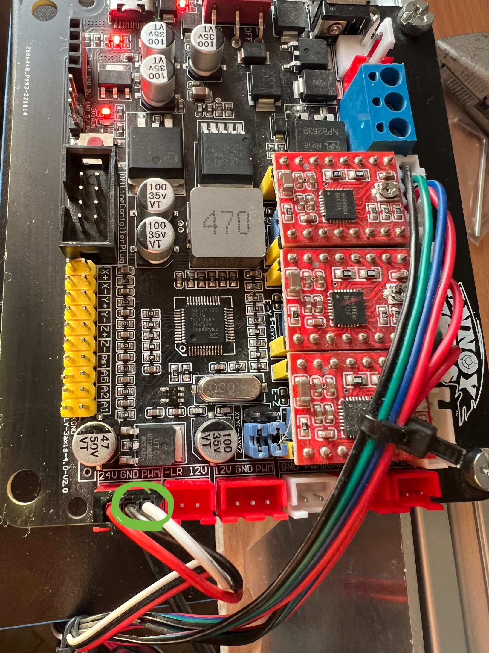

Preview Time not accurate ( already did "Read from controller" )
Actually, it’s 0.05V on 1% power sorry.
Still need those images
Triple check this
make sure the multimeter is on DC 20V range
1% should really read 0.3xV
iddle should read dead 0V

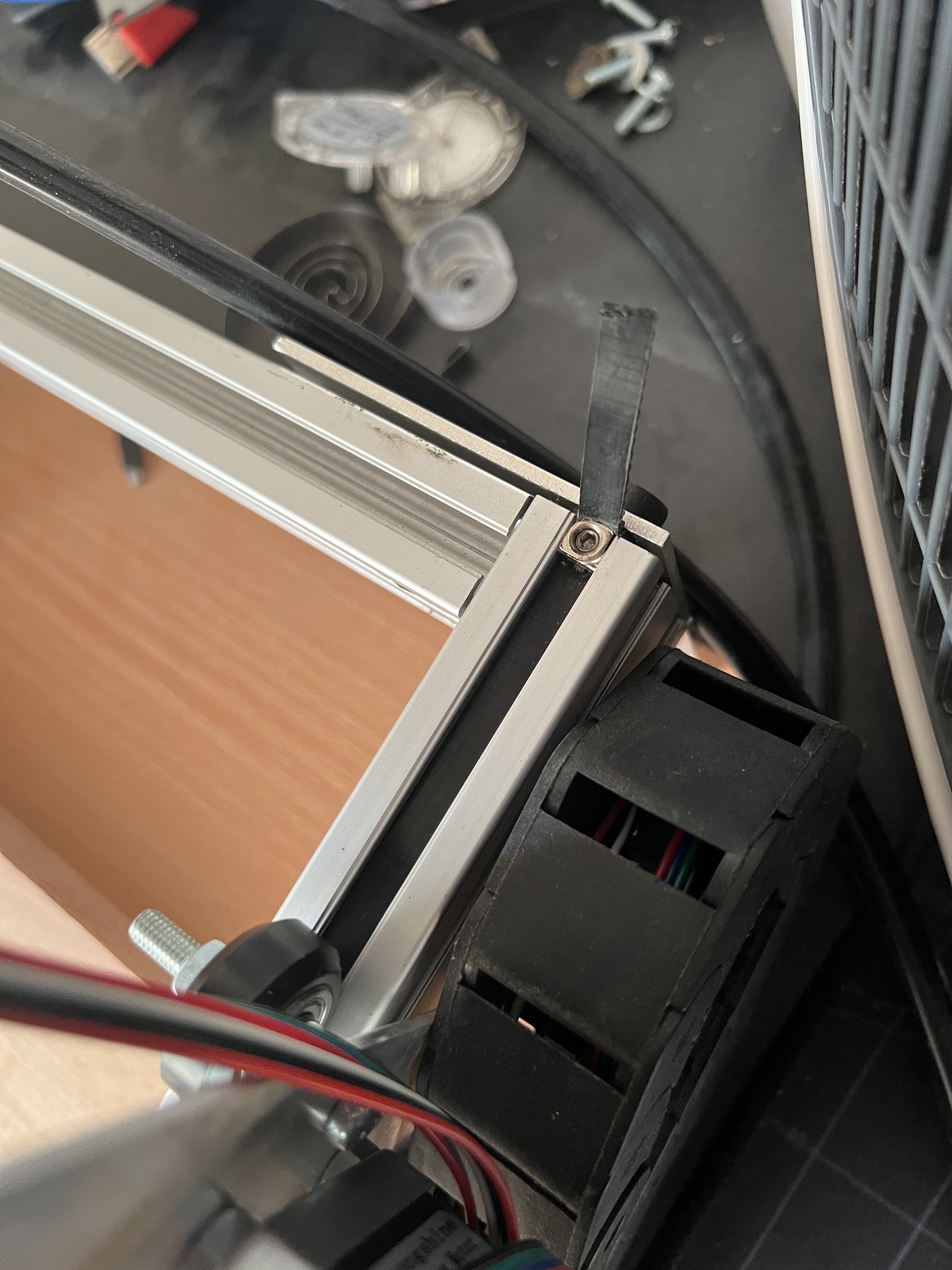

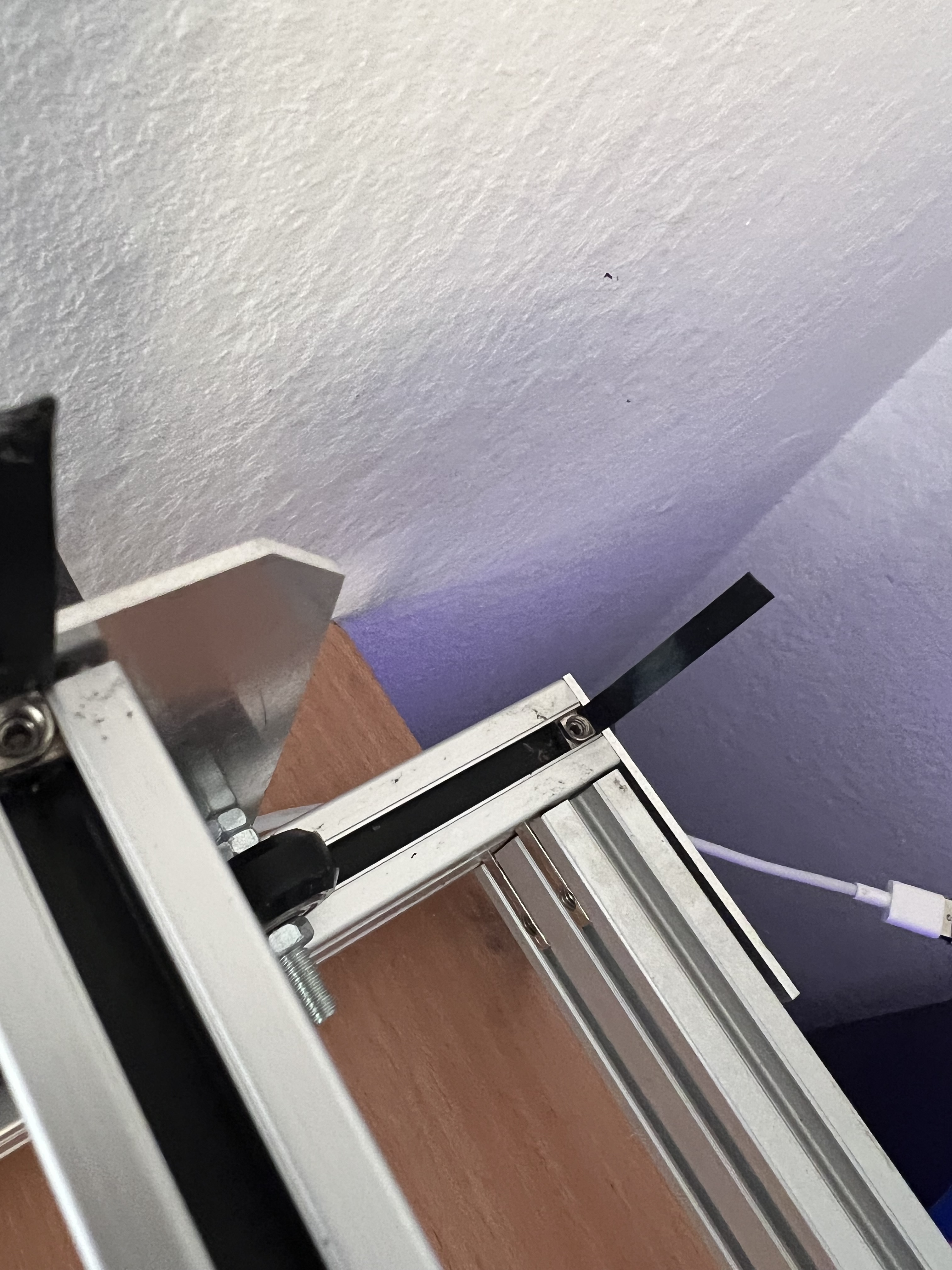

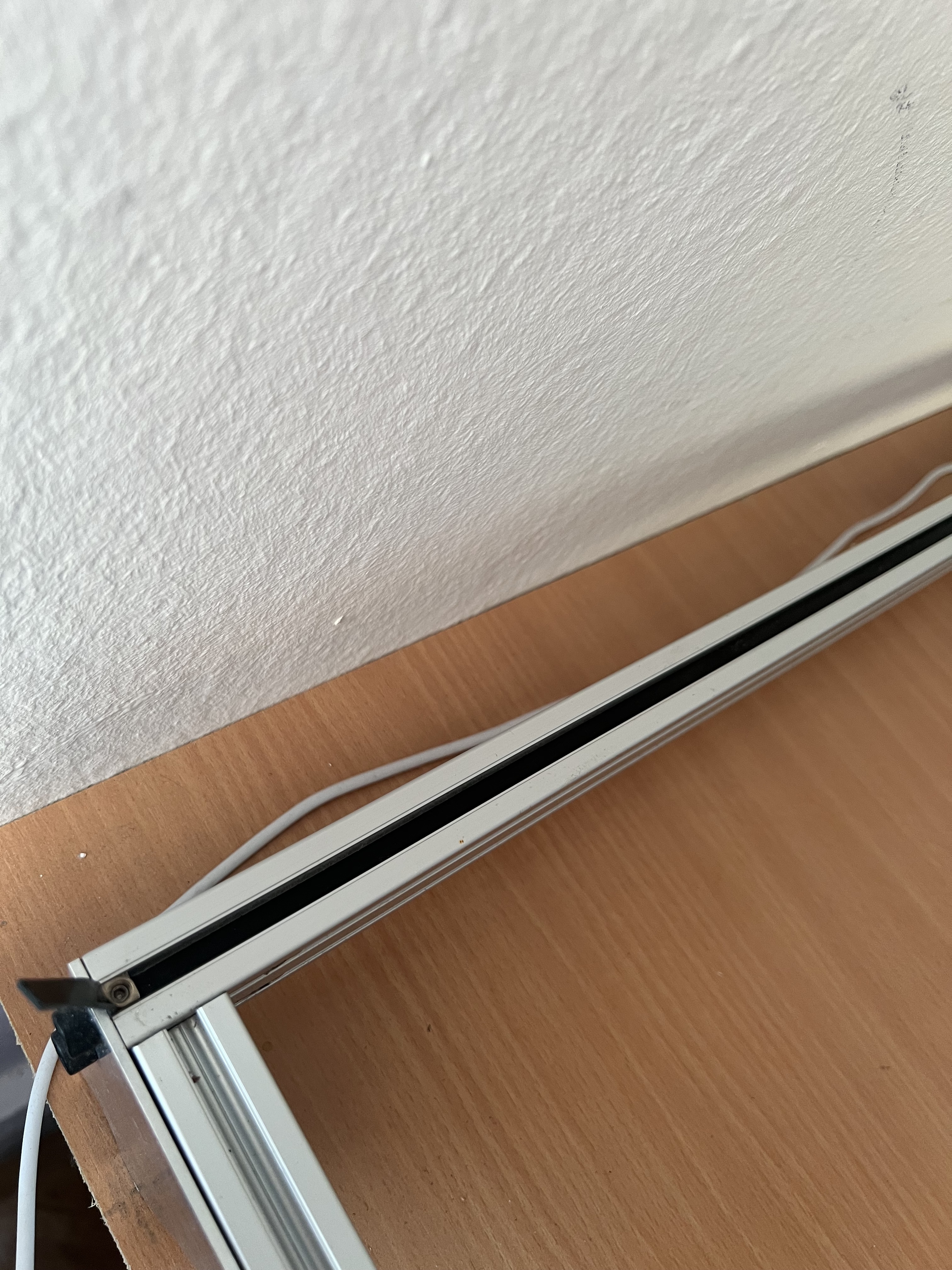

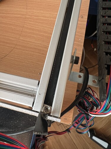

Here are the photos of the belts
and heres the photo where I put multimeter (marked green) and I get 0.04 value on 20 V DC multimeter… And 0V iddle.
Can you measure the same at the laser head end cable?
In case something is induicing mid engrave
Also… test this with machine moving, as in run my same test, and unplug the laser head cable and measur there
Your belts seem ok. Y might need a little more tension but seems ok ish
On laser head end cable is the same as on the board.
While in movement, it’s 2.50 ( on your file that you have sent me )

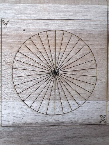

Is it still engraving traversal lines?

That your $32 is set to 0 and should be 1
Which is correct.
$32=1 press enter
Then try :slight_smile:
Okay, I will, btw thank you so much for this, I appreciate you a lot.
zero problems! see if we can figure this out! :smiley:

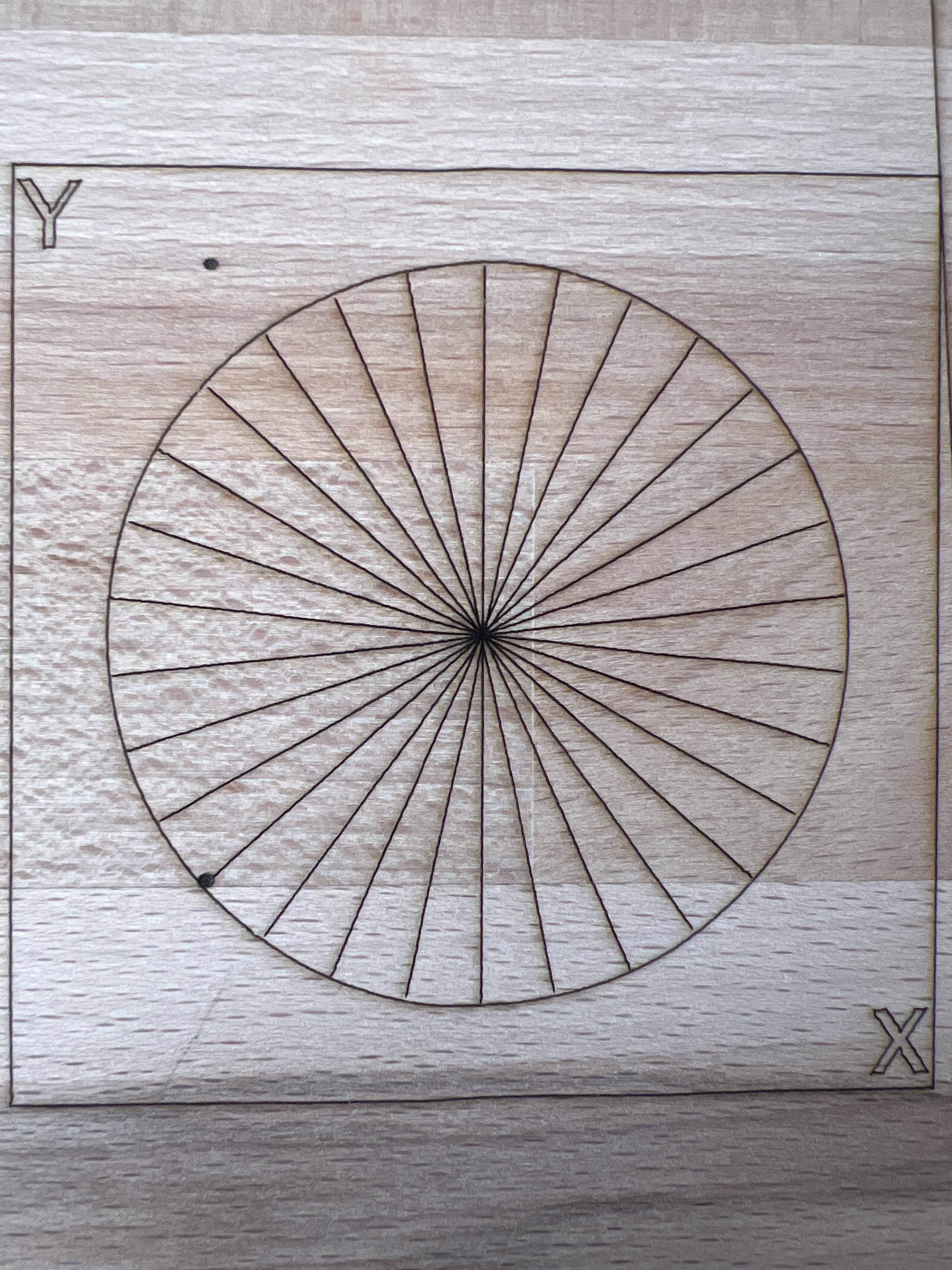

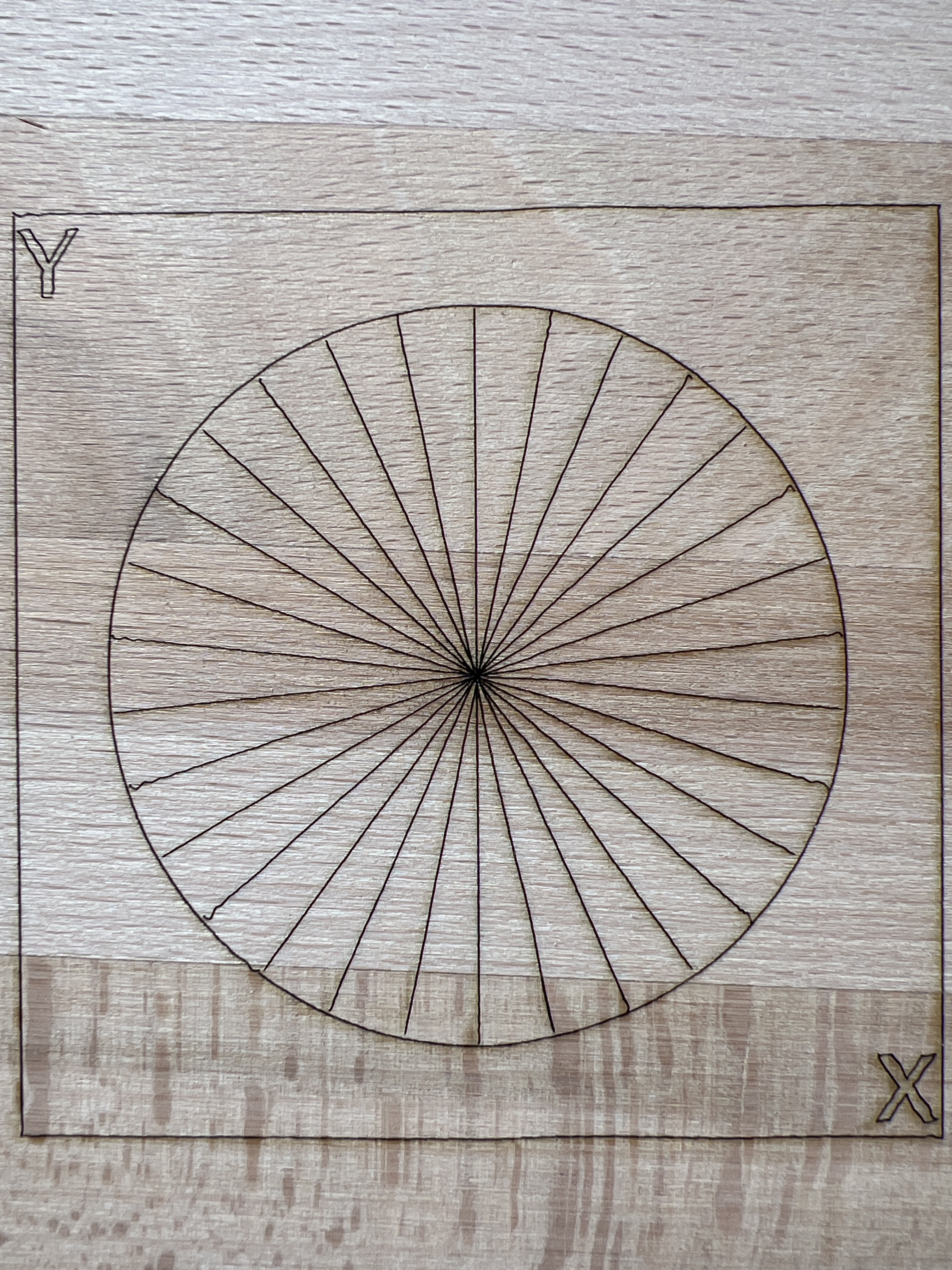

No traversal lines this time but precision is a bit funky, probably because it’s not attached to my table, I mean I watch it while doing this test and it’s moving in the corners a tiny bit.
Better!
You can focus on the shape of the Y
Note
How the right hand side is “squeezed in”
This is because the Y movement has some backlash
you got to tighten your Y belts quite a bit more
The wiggles is normal if you are on a non solid bed, also the test is quite fast

I have tightened them up and I ran the test but it’s not visible better. Idk.
Btw, those two dots are from my previous test for something, dont worry haha
