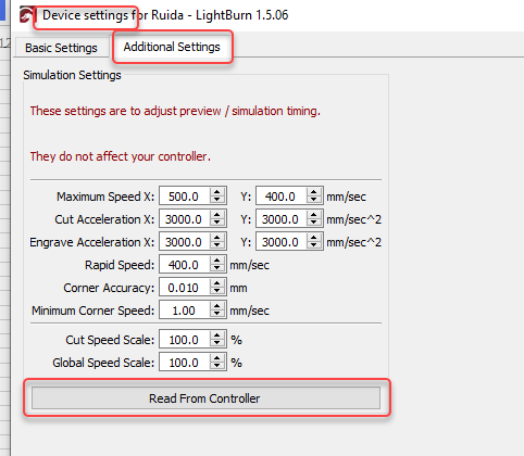

Preview time still not accurate enough
I think we defined that
a) vectors will time it ok
b) Images will be like 1.5 x 2 off if heavy gcode, like grayscale

Some one migh thave answered this already but go to:
DEVICE SETTINGS â ADVANCED SETTINGS â READ FROM CONTROLLER.
This should refresh your controller and give you a better reading. You have to understand that the time is a âguesstimateâ at best.
I had to manually adjust the values (mostly accelerations) to get mine within about 10%. All those values can be altered without affecting machine function and can be easily reset by reading from controller again. Play with it and see what helps.
