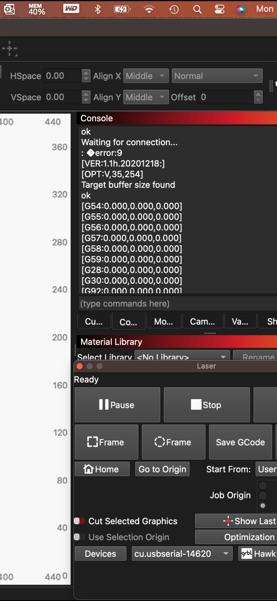

Hi Dominic
I’ve attached a screen shot of the laser window, which has always been set like this.
Hawk
From your screenshot LightBurn is definitely talking to the controller — GRBL 1.1h is responding on cu.usbserial-14620. The error:9 message is GRBL saying it’s in an alarm state. On the Masuter Pro you should be able to clear that by pressing the Home button in LightBurn.
Earlier you mentioned everything went “diddly” after the update — could you describe what changed? Was it movement, connection, or laser output? That’ll help narrow down whether it’s just the alarm state or something more.
