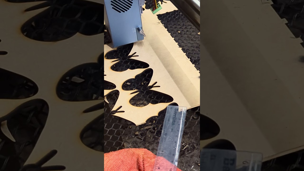

As you can see, there are more cuts after the marks, but when I try to cut it says that there are cuts outside the area and these are not going to be cut. I want to know is there an option where I can continue with the design, without having to do so much circus.
In any case, this version can no longer align the marks, it selects the first and the second when obviously I already moved the laser to the position it tells me “you must move the laser to the location of the second target” not go beyond that message…

"I want to cut a printed letter-sized sheet. For obvious reasons, the registration marks are within the same print. I’ve added other cuts beyond the printed sheet, but when I attempt to cut, a window pops up saying it won’t cut beyond the objects within the registration marks. I want to cut everything in the design. There must be a way to tell the software to cut everything in the design regardless of the registration marks.

I understand perfectly how it works. As I mentioned before, I had already done it with the pirated version I had. I decided to buy the original version because I had tried the software and liked it. Now that I am trying to resume cutting with the markers, it simply won’t work. I have absolute coordinates enabled and move the laser to the next marker, but it just says, “you must move the laser to the location of the second target.” I apologize if I repeat myself saying I have used it before and know how to do it. Regarding the first question, I just want it to cut everything that is designed beyond the reference markers. For example, I have an image the size of a letter, but my design is the size of legal paper. The markers are only on the letter size, but I want to know if it can continue cutting beyond the markers. Thank you. If this new version doesn’t work, where can I download previous versions?

Lightburn will cut anything within the constrains of your work area. The marks are for alignment only. They could be right next to each other and Lightburn would still cut the entirety of the work area, although you would not get a good alignment with the marks close to each other.
This is a different issue. Do you have anything on your screen outside the work area? If so, you need to verify that “Ignore Out of Bounds Shapes if Possible” is selected in settings or remove anything outside the work area.

NO NO NO… The offset is used when you have a crosshair laser pointer so that the center of the laser positions correctly. It was by chance that I realized it works and lets me select the second mark when I deactivate or activate the offset. I have already uninstalled the version I bought and installed the cracked version, and it works without any issues. I think I will contact support to have them fix it or simply get my money back. It is definitely a software problem. I appreciate your attention (and by the way, it does not burn incorrectly). When I make the second mark, forcing it to be selected with the offset, nothing starts. Even though it is marked, it doesn’t send to the cut. I’m sure it’s the version. Thanks again, my friend. version 1.2
I found the latest update that works well with my cutter; it is version 1.4.05. You were right, I was able to cut the entire design by activating the ‘ignore out of bounds’ function. Thanks!
