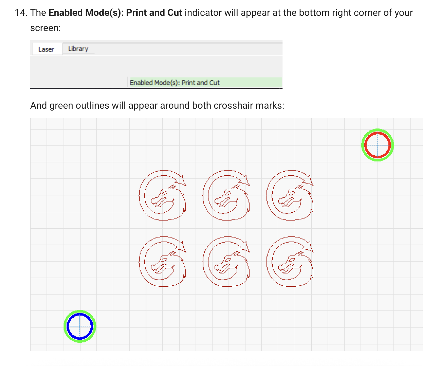

I have not tried P&C with version 2 yet, but one thing I notice is it doesn’t say Print and Cut Enabled in your screenshot. Nor do the targets have the green outline. I think we need to wait for Oz to look this over.

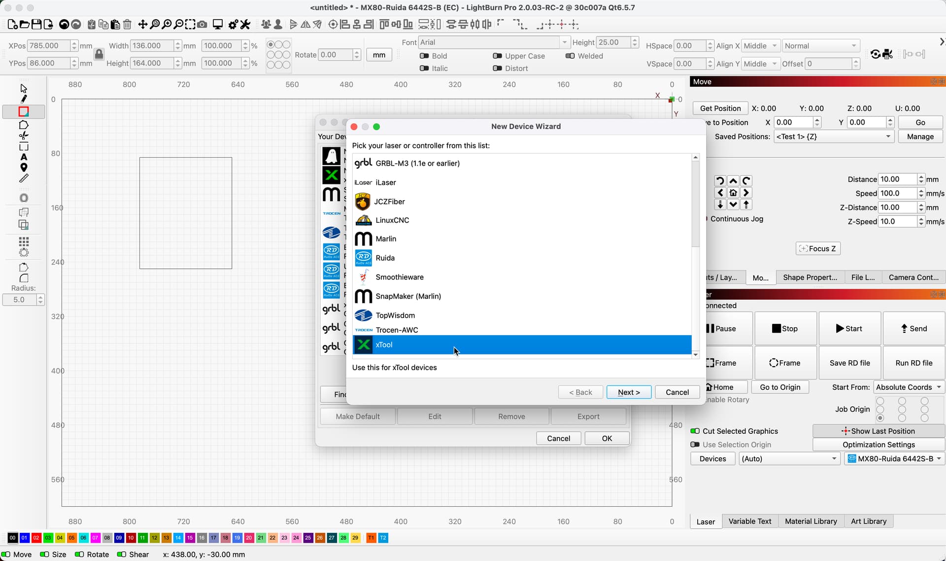

Haven’t use print & cut before, just new to lasers. I rebooted everything and now print & cut works after I changed several settings. I used the Xtool LBDev file from Xtool site, should I replace that file with the LBdev file from LightBurn (didn’t know there was a file on your site)
If it’s working now you should be ok. There’s an “XTool” specific device type in LightBurn that you can switch to, instead of using “GRBL” that bypasses a few bugs in the XTool firmware.
Many many thanks :). I’ll replace the Xtool file with the LBdev file from LightBurn.

So many questions, sorry about that. Where do I find the LBdev file? Xool website or Lightburn website? I’m having a hard time finding it.
Found it. Thanks
To assist others, the Device Profile is where folks will find this. :slight_smile:

@Tomfalcon - As far as I can tell, Tim is correct - there’s nothing in your log that suggests it’s not working, or gives any reason why it wouldn’t.
The only thing I can see from the log is that after your second point is tagged, it’s not automatically enabling the “Align output to targets” thing for you, which I think is because you haven’t picked the option to align with scaling or without. You have to pick one of those.

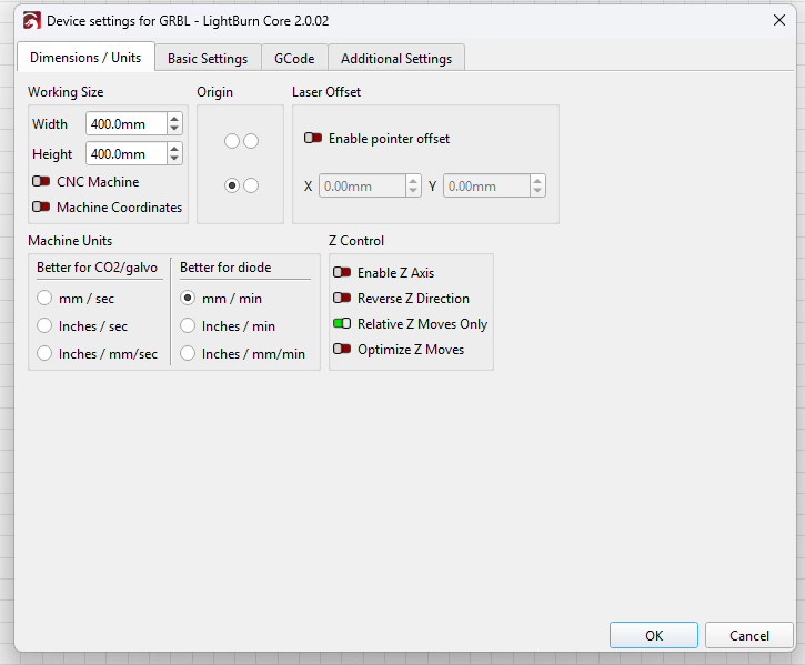

Check the settings in this menu. I don’t quite understand your problem, but I think you need to look for the problem in the laser settings.
