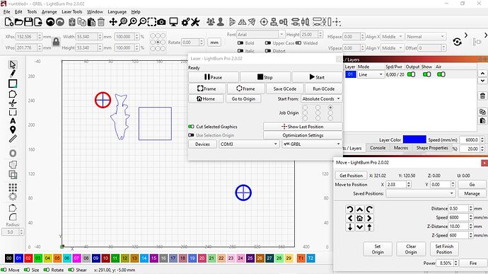

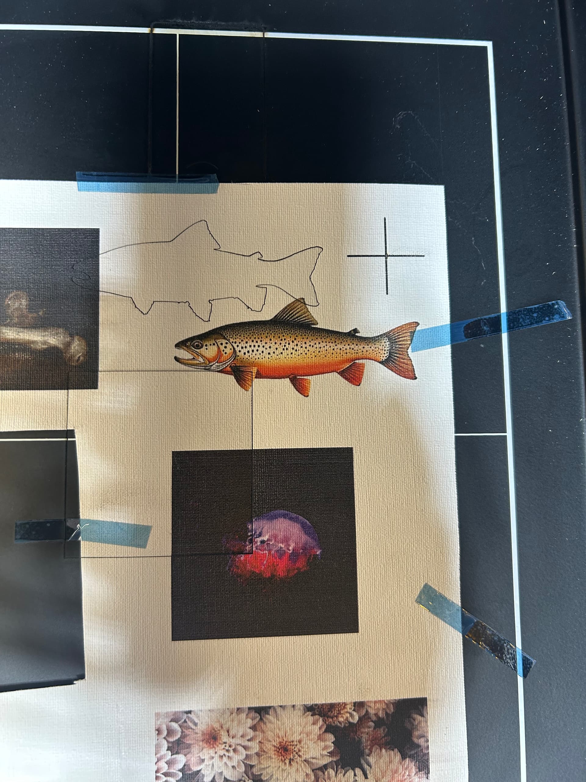

I was wondering if anyone has any ideas as to why Print and Cut would be so far out of alignment? I’m new to lasers and LightBurn but have tried everything I can think of before posting. The laser is a Creality Falcon A1 diode.
Edit: I’m creating an A4 image at 300 DPI in photoshop, importing that into LightBurn, tracing the image and then using the wizard. I have attached a screenshot of my workspace.
This is also happening when I trace and cut from the camera. It seems to be off the same distance.

While I’m hardly a guru as Mikey put it, I will try to help. Need at least a screenshot of your entire Lightburn screen with your project loaded and Print and Cut ready to send to the laser (not a phone pic, please) as well as a step by step description of how you set up Print and Cut.

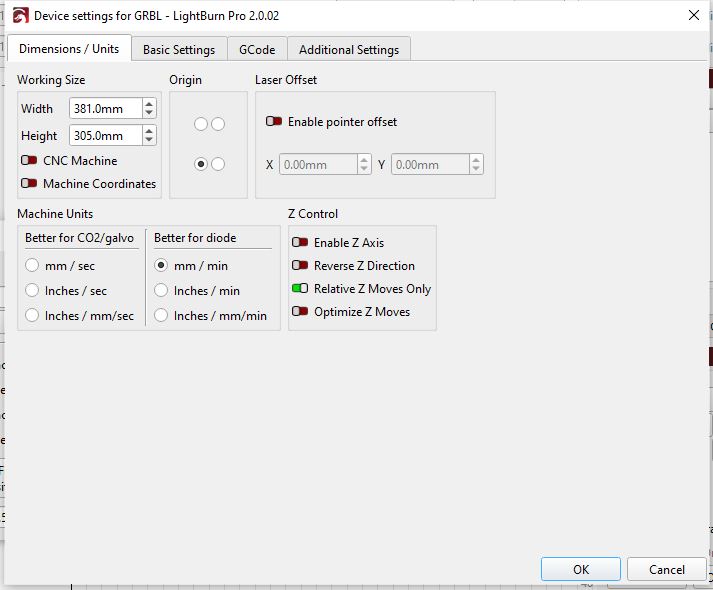

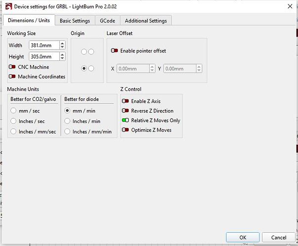

Do you have a “Pointer Offset” value set in your Device Settings?

I do not. Here is how it’s set up.
