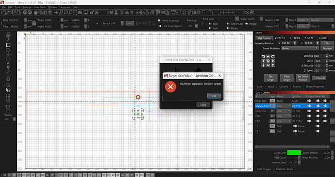

Print And Cut Issues LB 2
I’ve been trying to use the print and cut feature in LB2, and I keep getting an error message (see screenshot)
e
I have used this file many times in the past with earlier LB versions, and I’ve had no issues. I have even tried moving the target markers further apart, but that has made no difference.

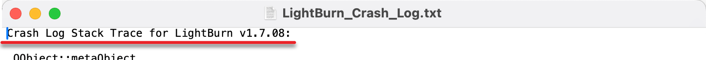

Also, LB2 crashed (crash Log included)
LightBurn_Crash_Log.txt (8.3 KB)

Thank you for reporting @Steve765. Will take a look… :slight_smile:
Edit:
Opening this crash log, the first thing I notice is this report was from version 1.7.08. Was this intentional, or maybe you posted a different log?
Dam! i uploaded the wrong one and I’ve deleted the right one. :confounded_face:
No problem, just make it crash again.
Hi Rick, I have had to revert to LB1.7 for the time being, as the print and cut works perfectly with the file I uploaded in this topic, which is a shame because I liked LB2. I hope you can replicate the print and cut issue and provide a patch soon. Keep up the good work, many thanks. Steve.
Thanks Steve. When you get a chance, and if you’re willing, we just announced the LightBurn 2.0.01 Patch Release. I am not certain this specific issue was addressed directly, as we have not found a reproducible set of steps.
Hi Rick, I’ve installed the latest download, but it hasn’t solved the print and cut issue. So it’s back to 1.7 for me for the time being. I am running the xTool S1 40w laser on a windows 11 laptop with all the latest updates.
