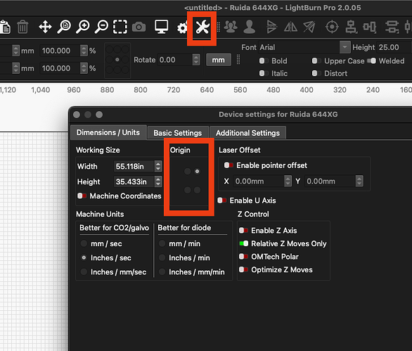

I often use Lightburn’s print and cut function. It works very well. However, what confuses me, and is the reason for this inquiry, is that every time I turn on the laser and enter the registration marks, the laser moves in a completely different direction than intended (often mirrored to the y-axis). After resetting the print and cut function and re-entering the registration marks using the wizard, it works as expected. What’s going wrong?
It sounds like the origin in your device settings may be incorrect. If this is set incorrectly, the orientation of your laser’s output will be mirrored or inverted.
Does the corner your laser physically homes to match the corner in your device settings?
