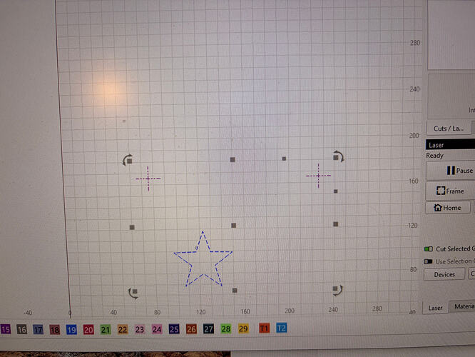

I’m definitely not the first to ask about this, but I’ve read all the forums I could find about this along with videos. I’m pretty sure I’m confident about how Print and cut should work but there’s something very strange that’s happening that prevents me from engraving the two sides of a basswood sheet.
The issue
Every time I setup Print and cut, my engravings on the other side of the sheet are always offset by some millimeters, even if I take a lot of time ensuring my laser points directly at the middle of my markers (Im using crosses in two corner). Once I complete the print and cut setup, if I run the Frame to see where it’ll land, I already see that the framing is offset.
I’ve tried using align with and without scaling. I also tried on the latest version as well as an older version - Same outcome.
So, my flow is :
1- I put my sheet on the honeycomb
2- I home my machine
3- I put my design in Lightburn
4- Trace a square around it
5- Put markers (+ signs) on each top corners
6- I engrave the first side
7- I select my design and flip it to mirror it (Yes i flip it the same direction as my woodbass sheet)
7- Then, I flip my woodbass sheet and start the Print and cut setup

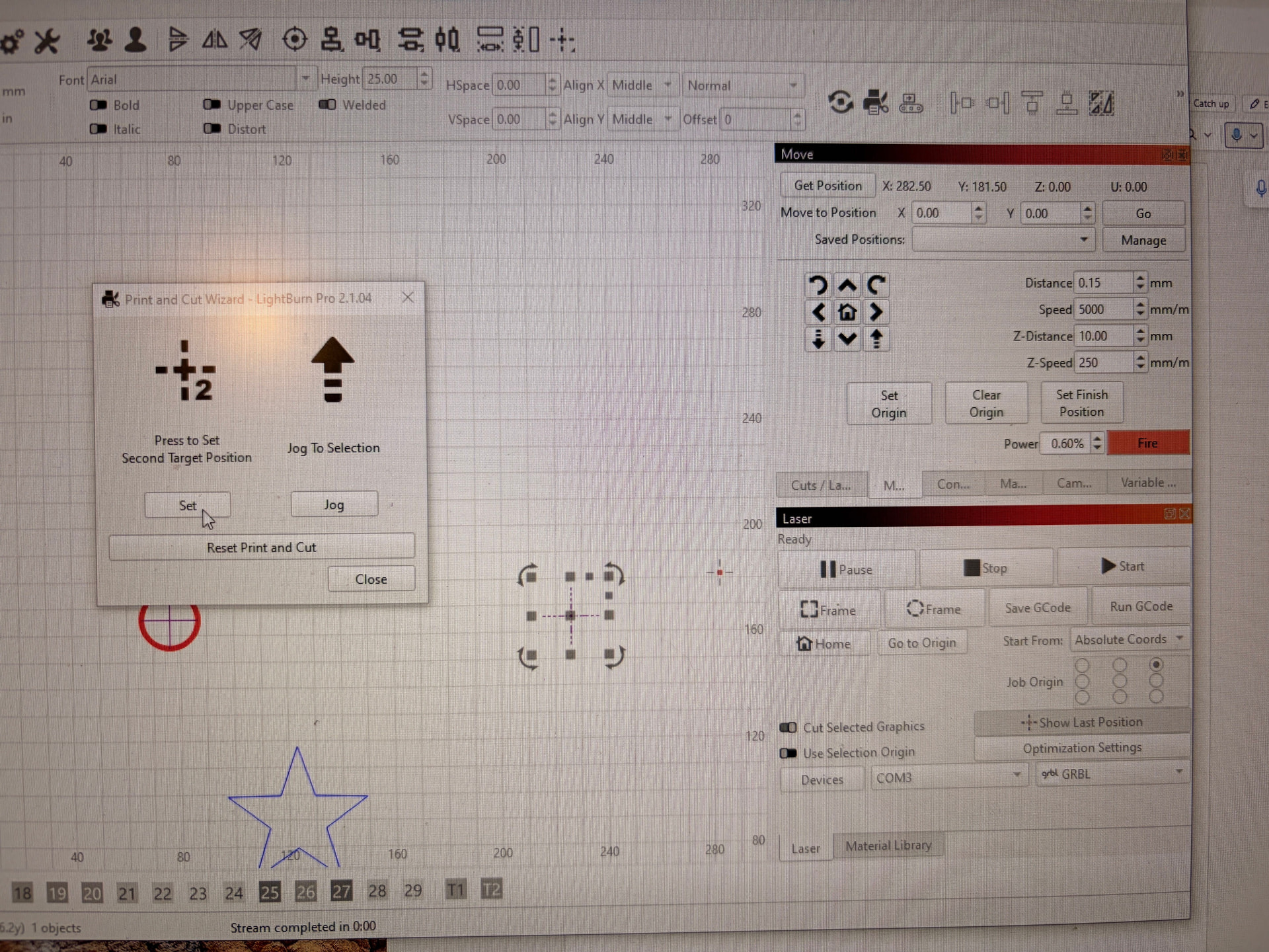

8- I then jog my laser above mark one as precisely as humanly possible
9- same for maker #2
10- I select Align (no upscale) I tried both methods - same results.
11- I select the square around my design and my design itself (Note that I’m not selecting the crosses to ensure the framing is not taking into account the + in the corners)
10- i run the framing and, I would assume the framing would run along the bottom part of the + signs that are sitting on top of the square corners, but already, that’s offset.
It’s like something applies an offset in the Print and cut and I can’t for the life of me get two engravings on the same spot on both sides.
If I engrave a marking on the wood, home in every time and then fire the engraving, the engraving will be exactly at the same spot every time. So it’s not a precision issue. I’ve tightened the belts, although this wasn’t not an issue. It really seems to be with the Print and cut process.

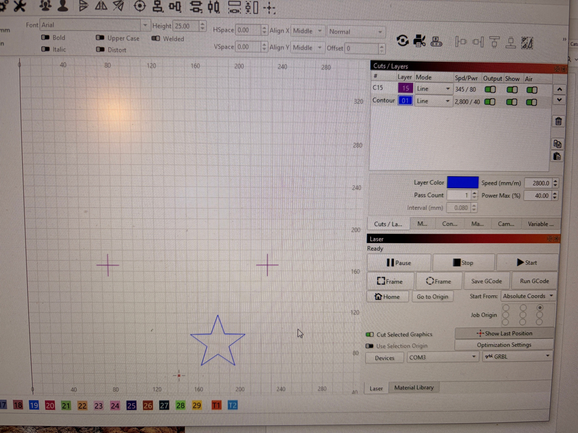

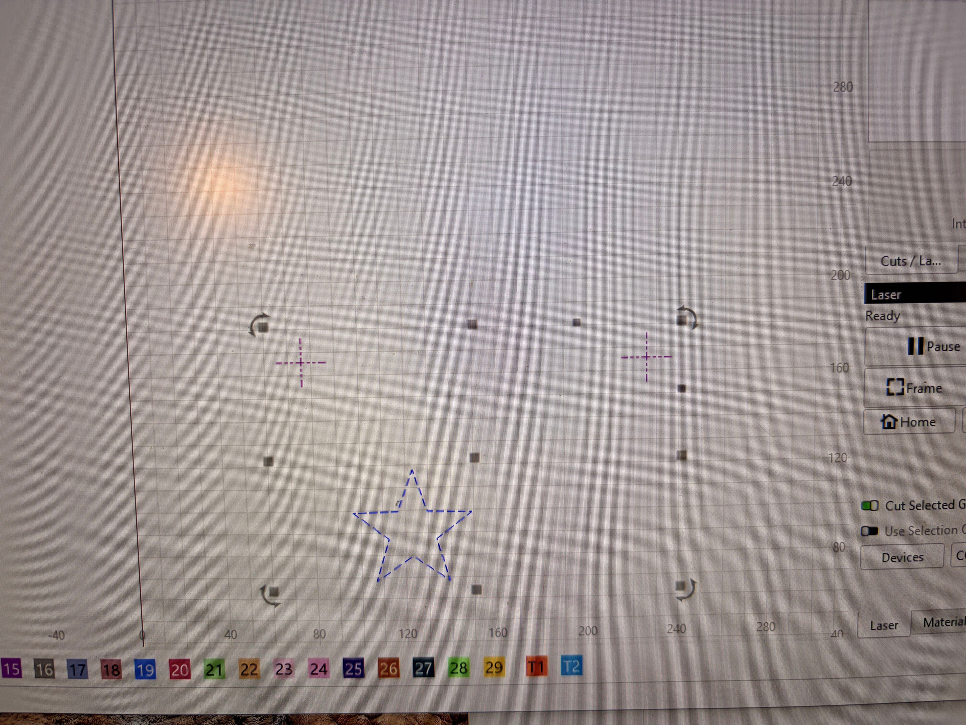

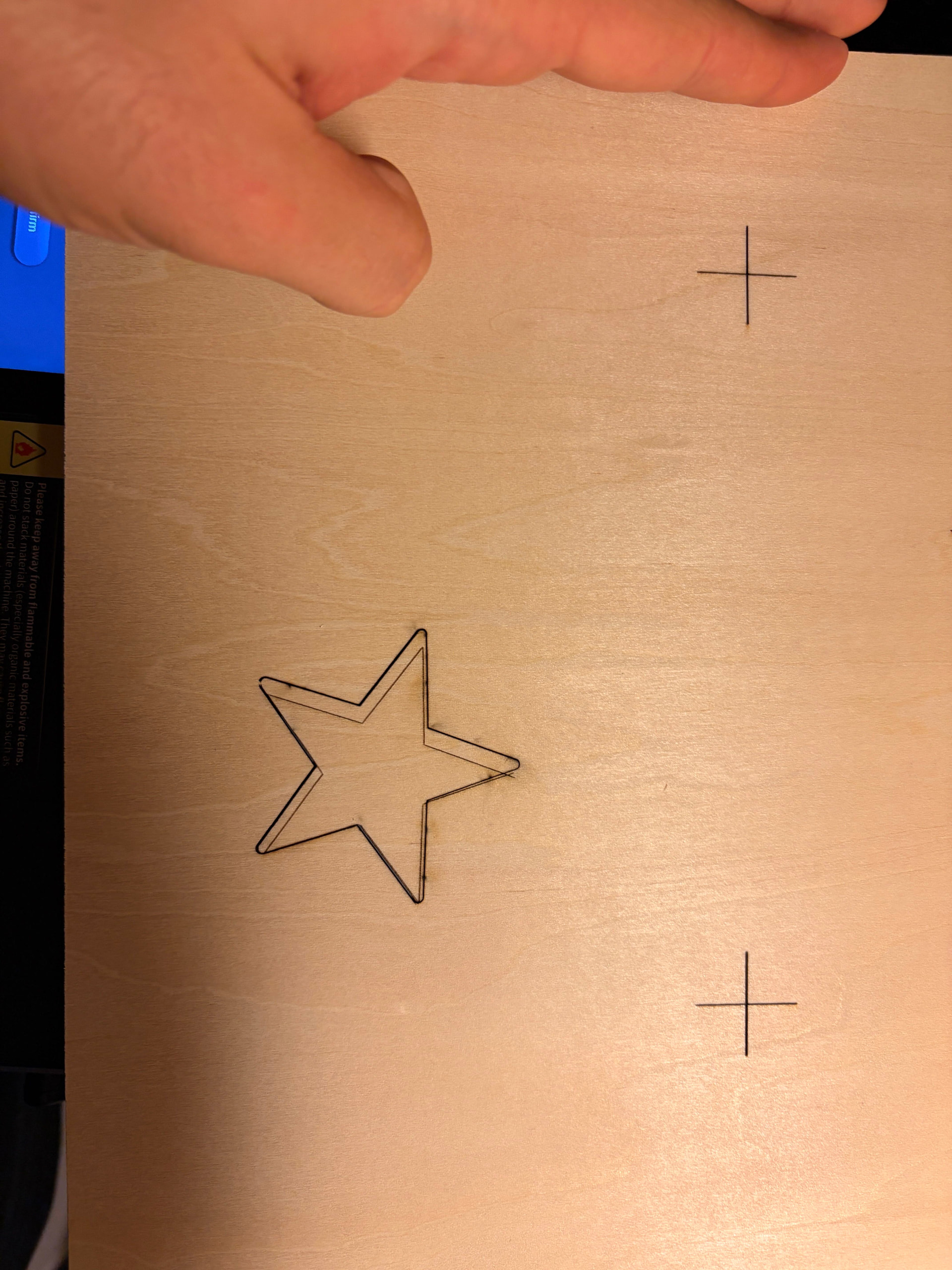

Here’s my process with a much simpler test:
so here i made a very simple test file
Engraved it on first side
Now, I flip everything in lightburn mirrored
Flip my wood sheet
Set the Trackers with the Print and cut wizard
both align options are giving me an offset
Everything looks good so far
And there’s the offset. It’s like that every single time
Sorry I wish I could put more screenshots, but there’s a rule that prevents new users from uploading more than 4 images.
Could anybody assist? This is driving me absolutely crazy !
Im using the Pehcda 20W if that changes anything.
Thanks in advance
