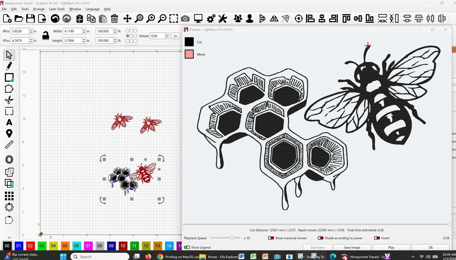

Yes, in the preview window all looks good.

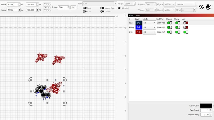

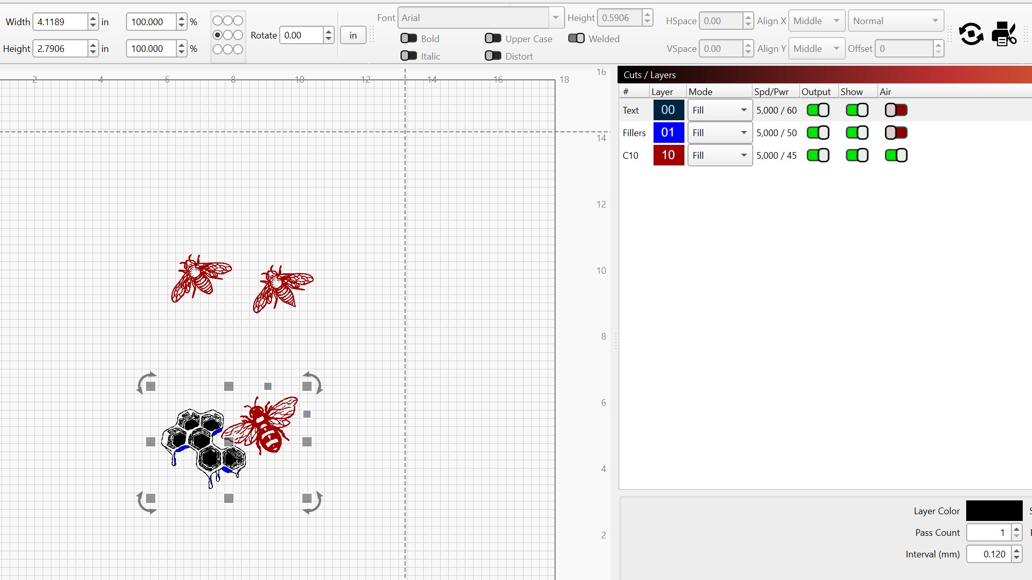

Neither choice works on mine. Did a Log file (attached), but I see nothing helpful there, I also included the .lbrn2 file, which I also suspect will not be helpful.
What can I provide that will be helpful?
LightBurnLog MLH.txt (1.4 KB)
Honeycomb Traced MLH.lbrn2 (775.2 KB)
