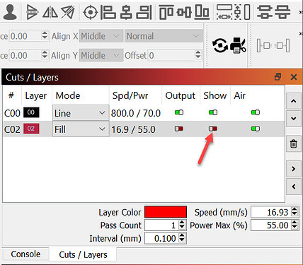

If you want to not send the whole Workspace to your customer you can turn off layers you don’t want to show in your print, Simply turn-off Show in the Cuts / Layers window and print it.
I just tested this with Microsoft Print to PDF and it worked as expected.
Cut Selected Graphics didn’t Print just the Selected Graphics - I’ll check to see if there’s a way.

If I turn off “show” for one ornament, it turns it off for all of them.
