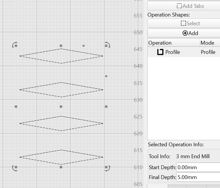

just downloaded the new ver MillMage Core 0.8.01-RC-3 @ 204e2b7 Qt6.5.7 and could not create a new operation, tried profile and pocket

i opened a file with no operations (with simple design), then clicked new operation, selected tool and parameters and then clicked ok, but nothing is showing up in the operations window.

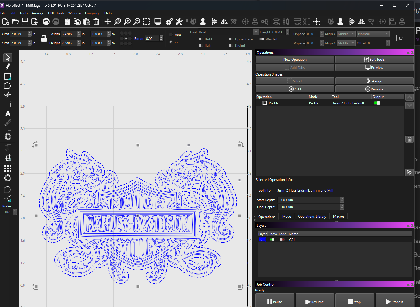

I’m on Windows 11 and had no issue making a profile and a pocket op.

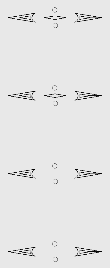

DIAMOND_INLAY_VER_7a.mage (28.8 KB)
I can replicate this with same file, whether shapes selected first or not, on second MillMage window with the same Tools library as the first window, if this helps.
no_operation.mp4.txt (838.6 KB)
This is odd, if I create similar shapes fresh second window I can create an OP.

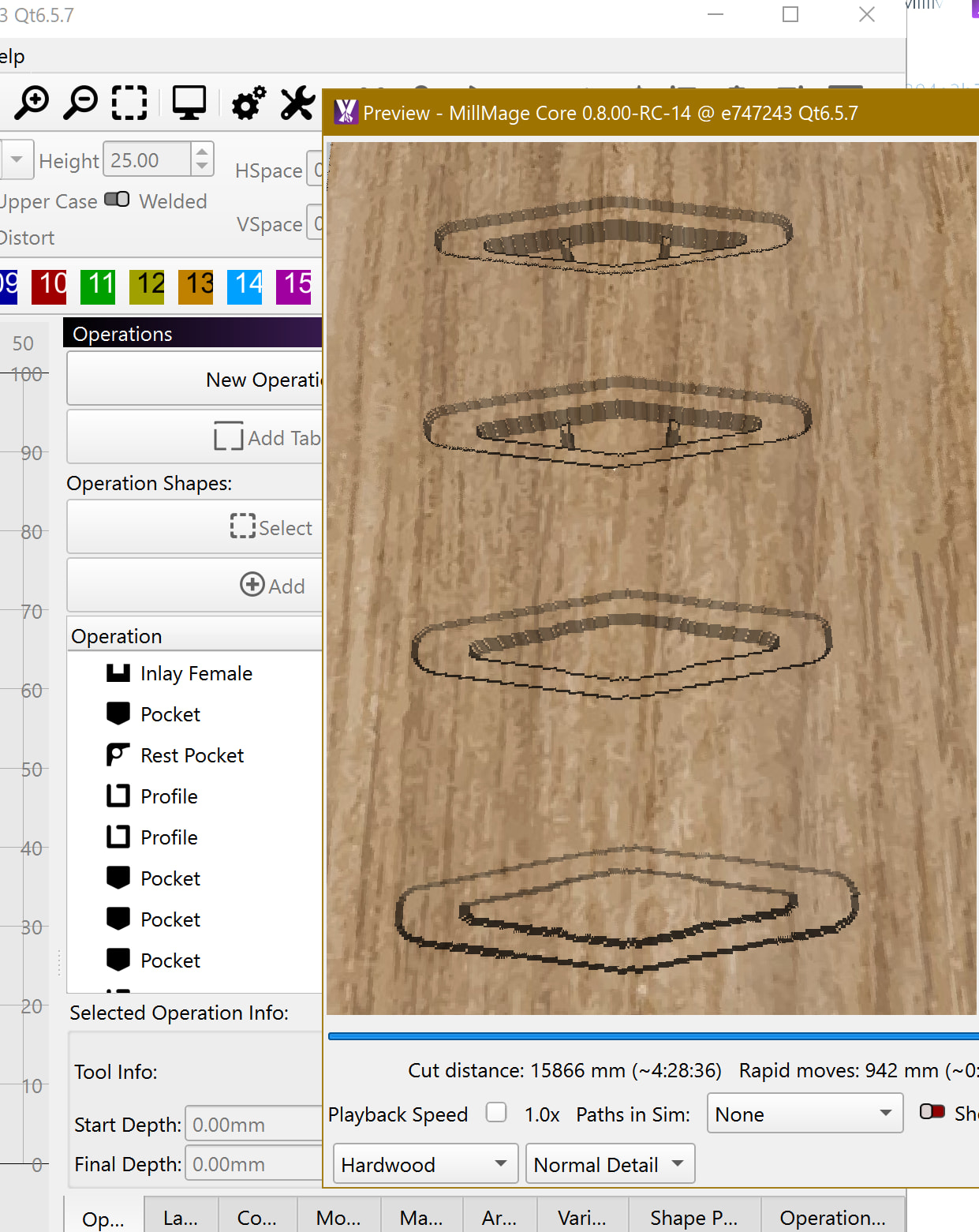

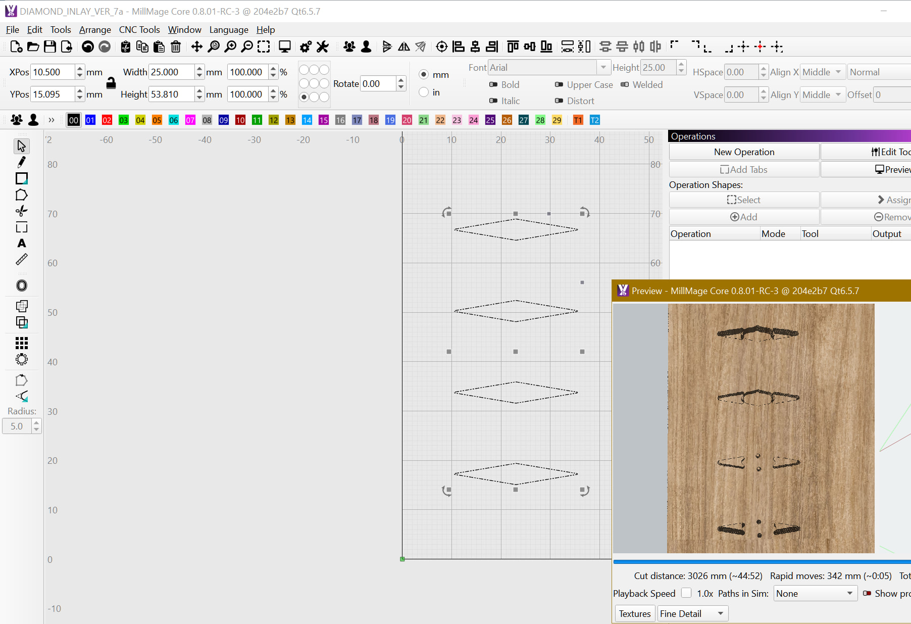

I can do a preview with your file without OPs showing:

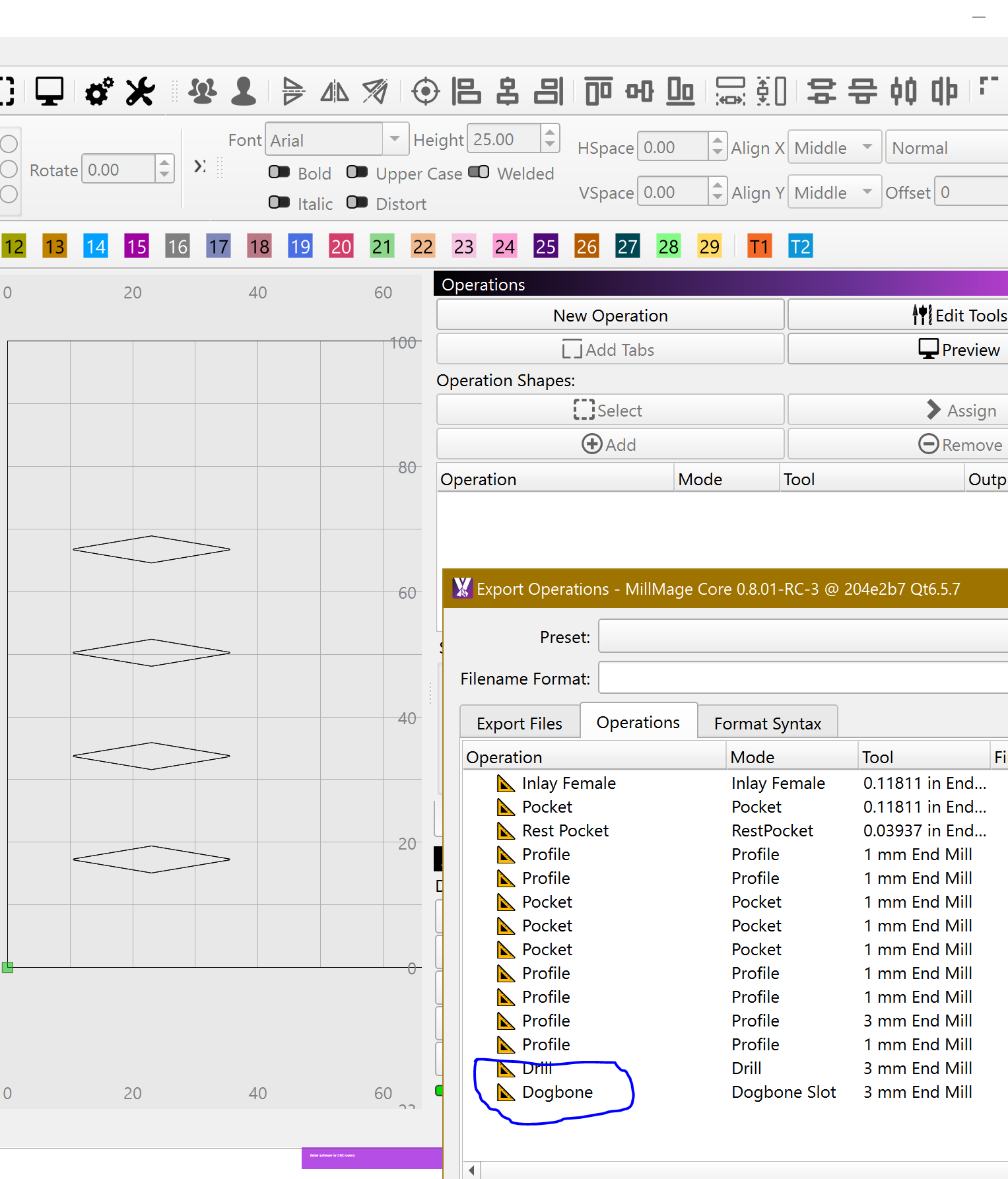

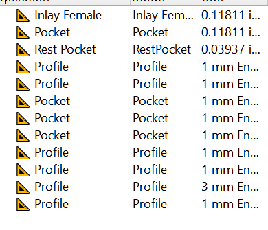

So you have the following operations set:
Why they didn´t show in the OPs window??
Have you created your file with MillMage RC-14?

just a question for you; how did you get that list with operations set listing?

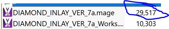

The size of your file (3 times more):
Worth an investigation…

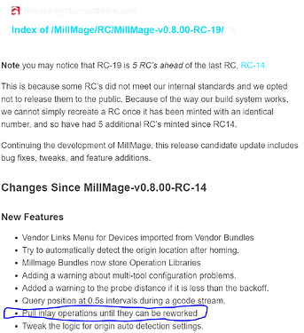

Sorry but I believe this:

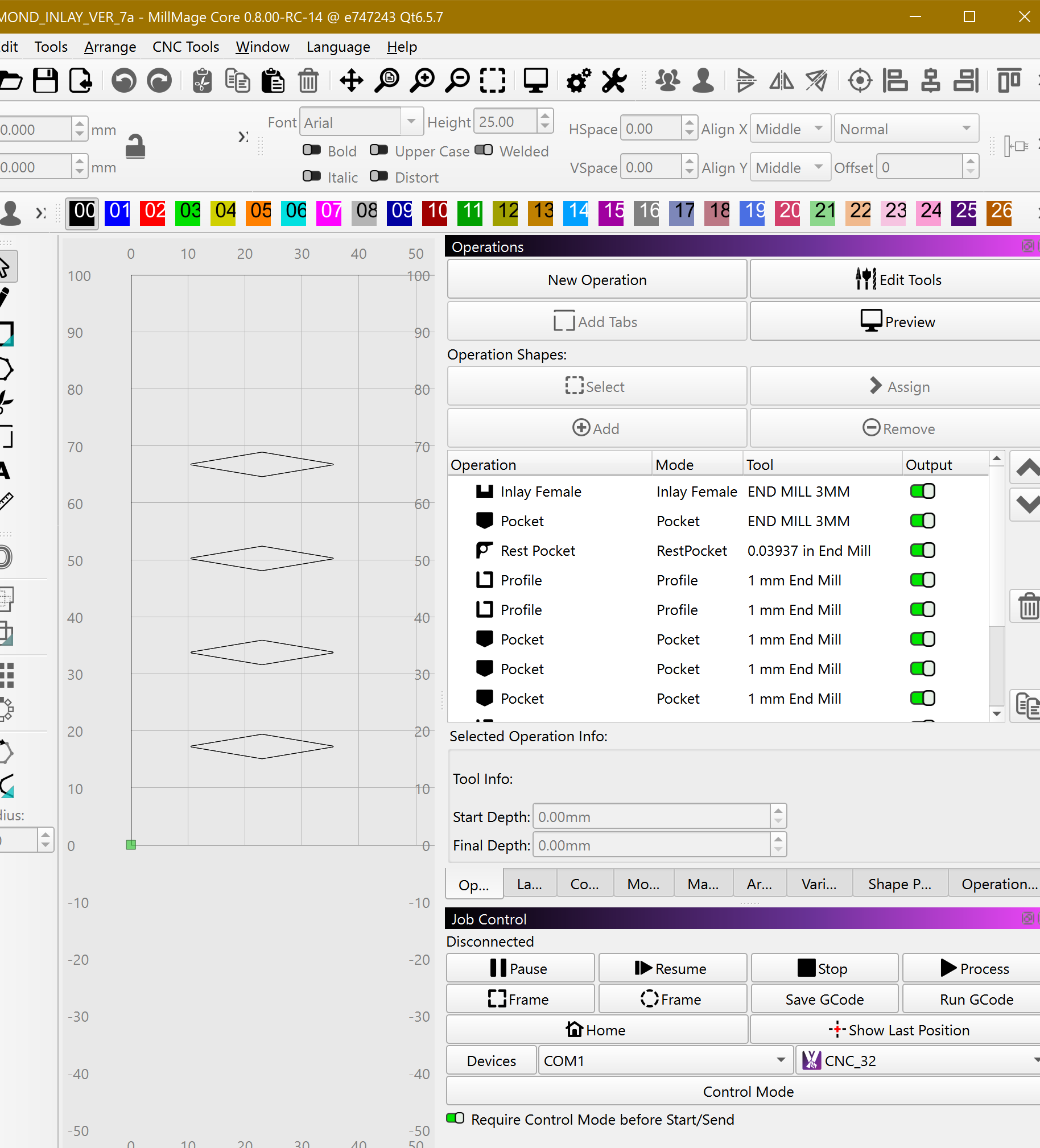

Collides with this (MillMage 0.8.00 RC-14):

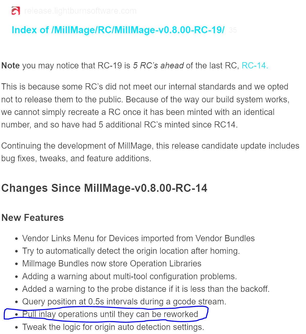

And this:
For the list of the operations:
With 0.8.01 RC-3 I added 2 more operations without none in the Operations window:
You found a bug.
