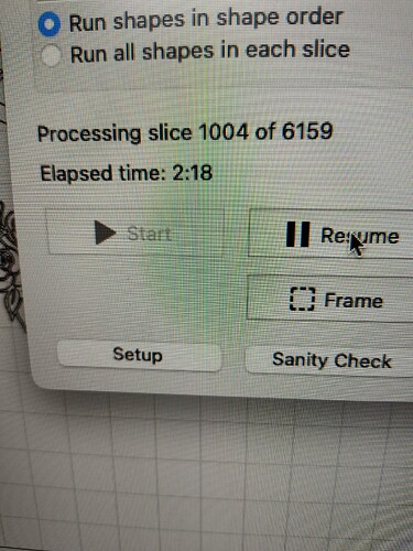

I have a bunch of .svg files that I use on my CO2 laser and XCS with no problem but when I import them into Lightburn and try to use them with my fiber laser they import as 4000 individual lines. I tried grouping them but when I try to engrave it, I have to wait for it to process all 4000 lines. I have lightburn, a mac laptop, monport 50w fiber, attempting to engrave a tumbler. Software set to chuck and rotate. After 20 minutes it still had not finished processing all the lines. I just exited out

Have you tried to BOOLEAN WELD the image? See if you can select the enitre object and Un-group it all the way back to single items (ungroup as far as it will go…)
Then select the whole thing again and instead of GROUP, use this button:
So I ungrouped as far as it would let me and then clicked that button you have highlighted. Then tried to run the engraving again and it went from 4001 slices to 6159 slices and as you can see from this photo it would take around 12 minutes to process all that. I even tried to reload lightburn and import the file again to start fresh.
Sorry I can’t help you more, the difference between fiber and diode lasers has me stumped.
