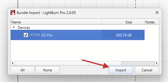

If you also have the 150mm lens, you can use my device profile.
Download this file, drop it into LightBurn, and select “Import”
Gweike_G2_Pro-30W-150mm.lbzip (192.5 KB)
Then, make sure it’s selected here

Its here?
Dont find the file.
The import button in the Devices window can be used too.
The easier way is to simply drag-and-drop the .lbzip into the workarea of LightBurn and click the import button in the window that appears. (as illustrated earlier)
Your screenshot shows that you are using version 0.9.24. You’ll need at least version 1.7 in order to talk to the BSL controller in the Gweike!
I installed the trial version 2.0 and it detected it. I also installed the BSLcad file, and it set the X and Y coordinates correctly, in my case 110.
