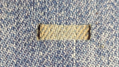

I have a problem with the engraving in filling, I have a black mark at the end of each stroke and this results in the fabric being cut when I just want to mark it (see photo).
I can’t find the cause and the correct setting in LightBurn.
my problem
problème

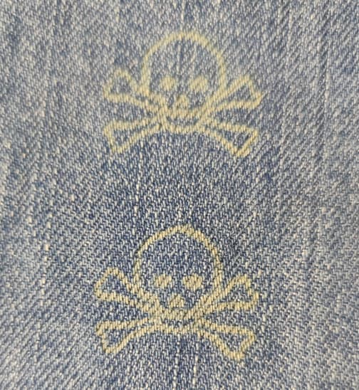

what I would like
gravure jean's

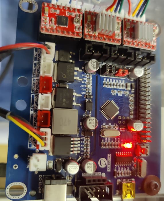

the controller on my control board is in :
my card

FYI: this is a table designed by me, not a commercial model.

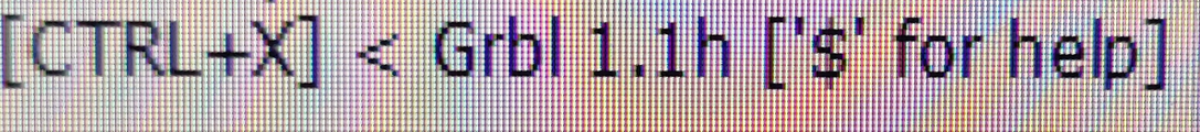

Does not matter. It is the controller board that needs to be recent, and it looks like yours is running GRBL 1.1h, which is fairly recent. I am pretty sure the plain GRBL will work just fine. Don’t sue me if I am wrong.
$30=1000
$31=0
$32=1
you been served! :rofl:
