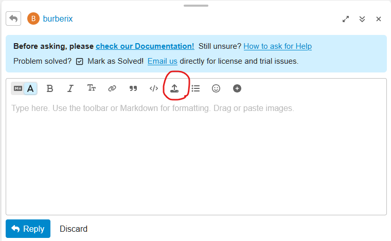

how do I do it?
Just use the “Upload” button to attach your PDF file.
strong textIt won’t let me attach PDFs
Try appending “.TXT” to your file to get around the forum limitations on uploaded file types. For example “myfile.pdf.txt”

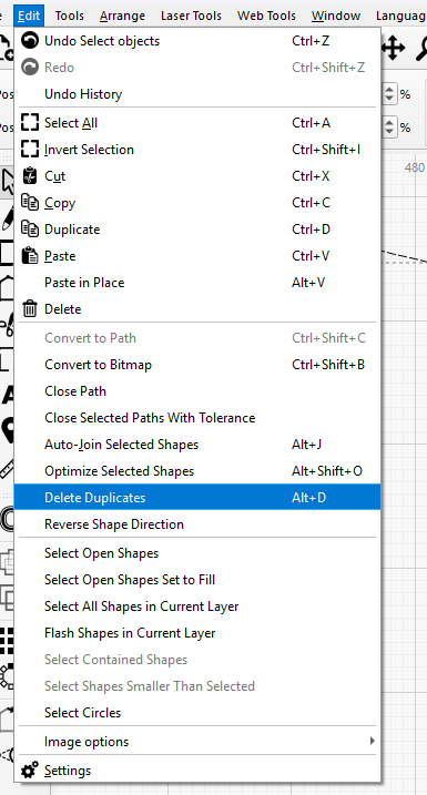

Try this:
  1. Select all.
  2. Ungroup.
  3. Delete Duplicates:
  4. Confirm deletion:

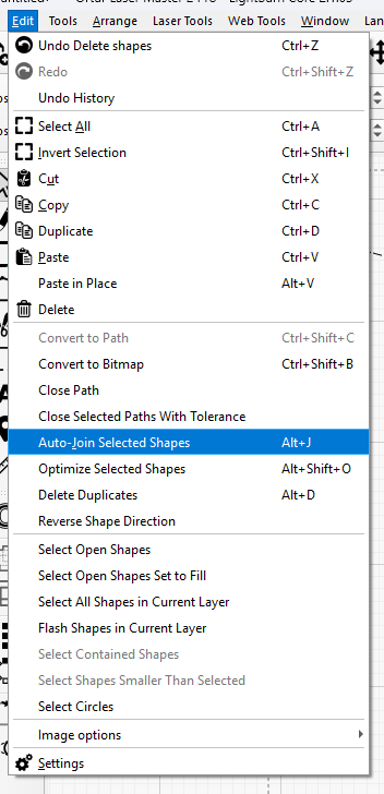

  5. Select all.
  6. Auto-Join Selected Shapes.
Hope this helps.
