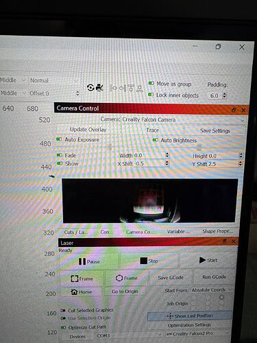

Hello, I have problems calibrating the Creality Falcon 2 Pro camera, I updated to the LG version 1.6.00 and when I try to calibrate and use the pattern at the bottom, the photo that shows lB does not match the image of the camera, (takes wrong the photo) please support.
The captured image isn’t meant to represent a normal image overlay. Don’t consider what the image looks like and focus only on the score.
Additionally, the screenshot you’re showing is for Image 1 which should have the calibration pattern positioned in the center of the capture, not the bottom. Be mindful of the position as to match the requested position.
The image its only example, the point is"if you see in the left the image its fine" but when i capture the image its wrong ( no appear correctly)
Is this causing a problem beyond a distorted captured image? If not, then my previous reply holds. Disregard what the image looks like and rely on the reported score to indicate if you’re making good progress. Continue until the calibration process is complete.

Ok I try.I finished the calibration, I aligned but when I go to test with engravings to verify the exact squareness. it not good
for example: Maria is not good if compare with ths position of lightburn and a i see the real postiion are diferent.
I modify X Shift and Y Shift (Maria is good now)
But X not. is not align. it that why i can engrave a little thing
What types of scores did you get during lens calibration?
Also, how far off is the burn compared to the overlay for Maria?
If you are within a couple of millimeters here’s what I’d suggest:
