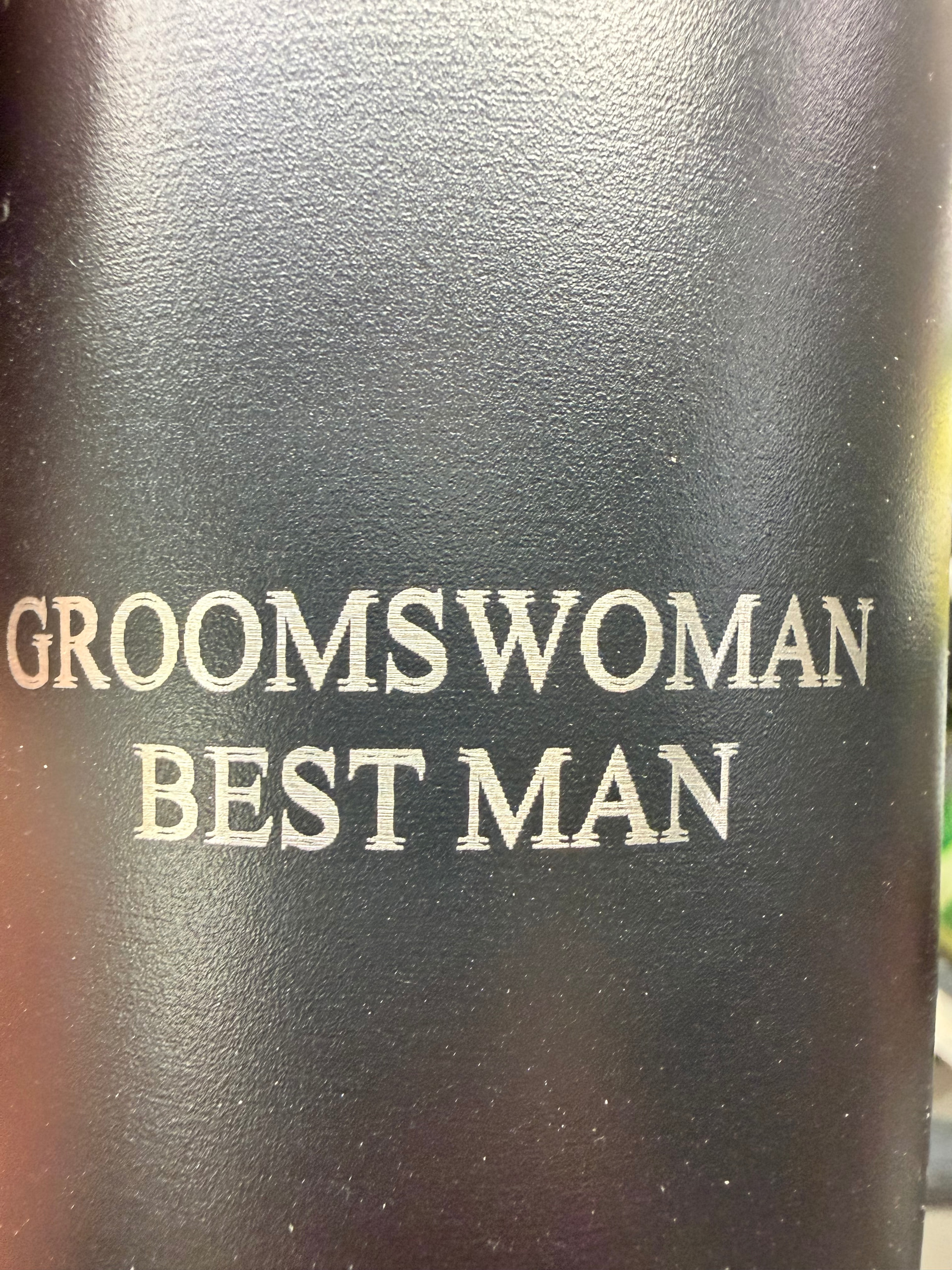

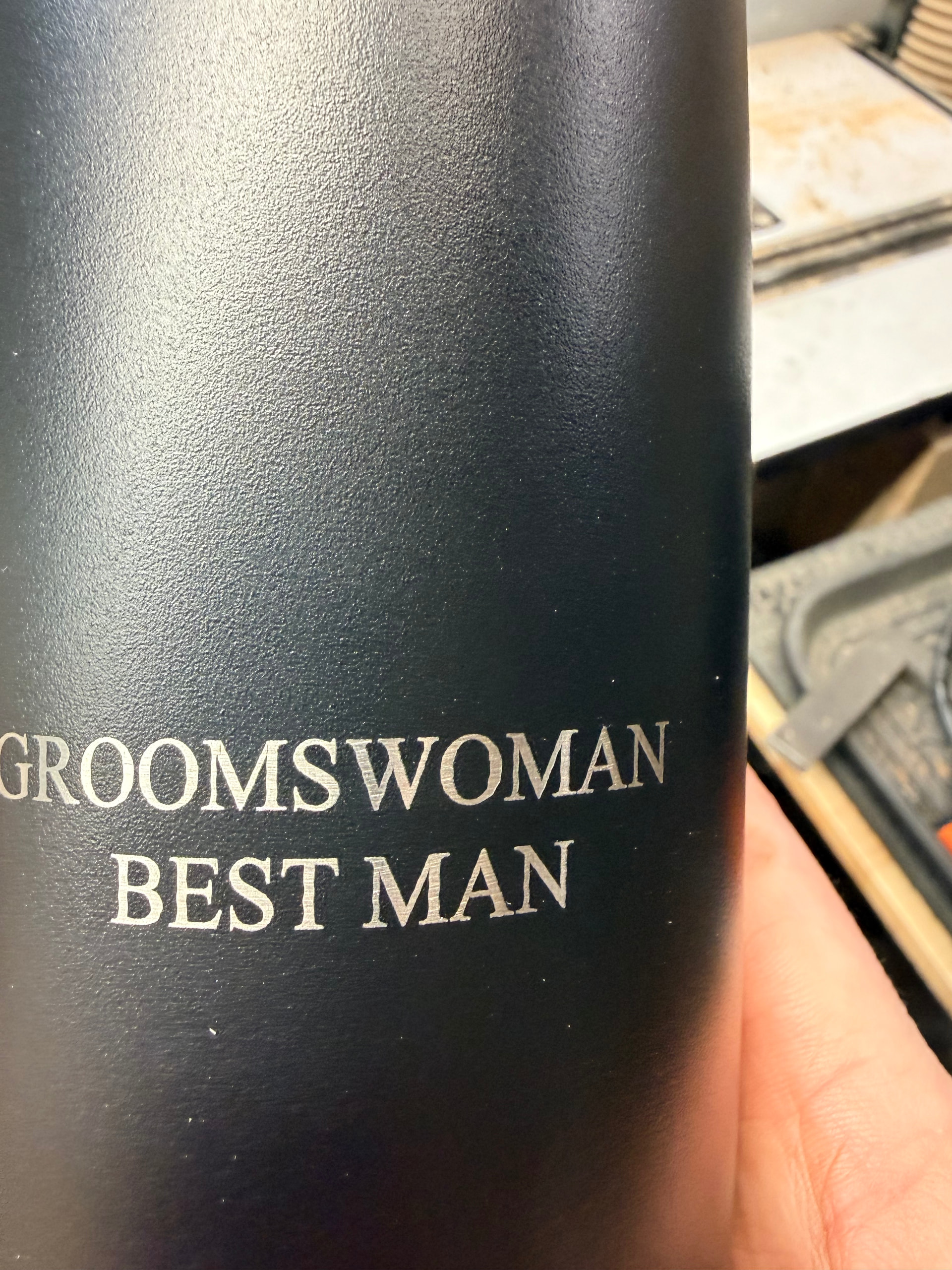

I can’t get my CNC mounted Jtech laser to engrave properly without making it painfully slow. I’m getting this odd result where it look as if it’s shifted. This is on the CNC axis not the rotary. I’ve tried overscan up to 8% and as low as 0 which has its own issues. The only thing that seems to fix it is dropping the acceleration on the CNC to 200mm/s, CNC is capable of 1500mm/s. Painfully slow at this acceleration rate.

Back to the doubled image…
  1. Assuming the double is along the Xaxis and it is rotating the Yaxis.
  2. You have backlash in the Xaxis.
  3. You have Bi-directional turned on.
  4. If you turn off bi-directional, it goes away.
  5. You have a loose coupling or pulley on the Xaxis drive.
If you have screw drives instead of belts, it has to be the motor to screw coupling.
Don’t just tighten the set screws. Rock the shaft back and forth to find the bottom of the flat on the shaft.
It really looks like the laser is actually turning off in the areas that are doubling on then points. If you look at the O’s there’s also a small section that isn’t getting engraved.
I don’t think this is a hardware issue on the CNC as I don’t see anything out of the ordinary when carving. It’s an Altmill so is ball screws and linear guides. I had this thought as well and went to an excessive amount of overscan (15%) which should rule out a coupler issue.

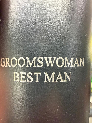

A closer look reveals the M is painted in two positions, one coming and one going. See the image…
Turn off bi-directional so it only burns in one direction.

So far I’ve found nothing. I’ve tested X movement with a dial indicator and it’s within 0.01mm for accuracy of movement and direction changes. Checked couplers, checked ball screw nut is tight in gantry block.
In the meantime I’ve applied a 0.2mm line scan offset and it works well in bidirectional.
