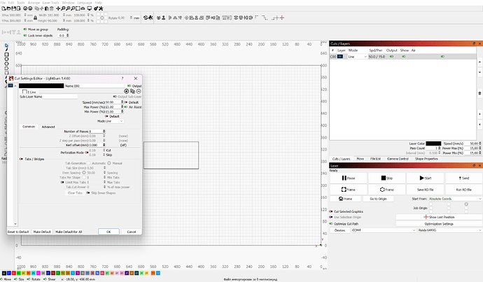

First, can you confirm that the laser head on your machine homes to the bottom-right? That’s how you have LightBurn configured.
Second, let’s remove USB from the equation. Try this:
  1. Create a simple rectangle in LightBurn
  2. Set layer to Line mode. with moderate settings for the layer: 50 mm/s, 15% power
  3. Push “Save RD File” in Laser window and save to a file
  4. Transfer RD file to USB drive
  5. Plug USB drive into controller and run the file from the panel
Does this work or are the symptoms the same?
I tried loading the created .rd file into the laser
I copied the file to a flash drive, then inserted it into the USB connector of the laser. writes invalid file and unknown file. The laser machine cannot open the file.
There are two USB connectors. One is for USB cable for connection to computer. The other is for UDISK (USB drive). Did you insert into UDISK port?
Also, can you upload the .RD file here for review? You may need to add a .txt extension to the file to do so.
yes, I inserted into the second usb udisk time. about expansion to change rd to txt. I will check.
Try a different USB drive.
How has the USB drive been formatted?
FAT32, the laser sees the .rd file, copies it to its memory, but it does not read it. changed the .rd extension to txt. laser doesn’t see the .txt file on udisc at all
It has to read it to copy it to it’s memory… What exactly are you trying to say?
Can you select the file from the console?
I selected udisc, the laser could not read to file, then I clicked copy to memory. That’s all I did, the file extension was .rd. the laser sees a file with the extension .rd but cannot read it

The file name have the simplest possible format:
  • No more than eight characters
  • A-Z, 0-9, hyphen, underscore
  • No spaces
All the fancy file names we’re used to just don’t work in the laser controller context. :person_shrugging:
