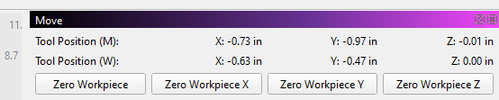

I have not had much experience with CNC or MillMage yet. A after I home my machine and jog the machine to the center of my material, I click to zero all axis, all axis show zero. If I jog off the center point when I click goto xy it returns to within about 3/4 inch of zero. It must be something I am doing wrong in MillMage. I dont seem to have the problem in gSender.. Any Idea what would cause this.

Once you Home, the Origin (Zero) is set for all three directions. After that, you should only change Zzero to be at the top or bottom of your material. You should be working in Absolute coordinates. Changing the Origin (X & Y) position means you have both experience with coordinate systems and a reason for changing it.

Thank You for the videos. I started them this morning. The first thing I noticed is that when I home my machine. It uses the distance the machine comes off the switches as the machine home position. It is never 0. Is this correct or is something set wrong.
Enter $# in the Console window to see if you have a G54 offset.
Do I need to change them to 0 like the rest
If you want 0,0,0 in the display. G54 X0 Y0 Z0 should do it. If not, then $RST=# in the Console window will do it for sure.
EDIT: Not all controllers go all the way to zero when homed.

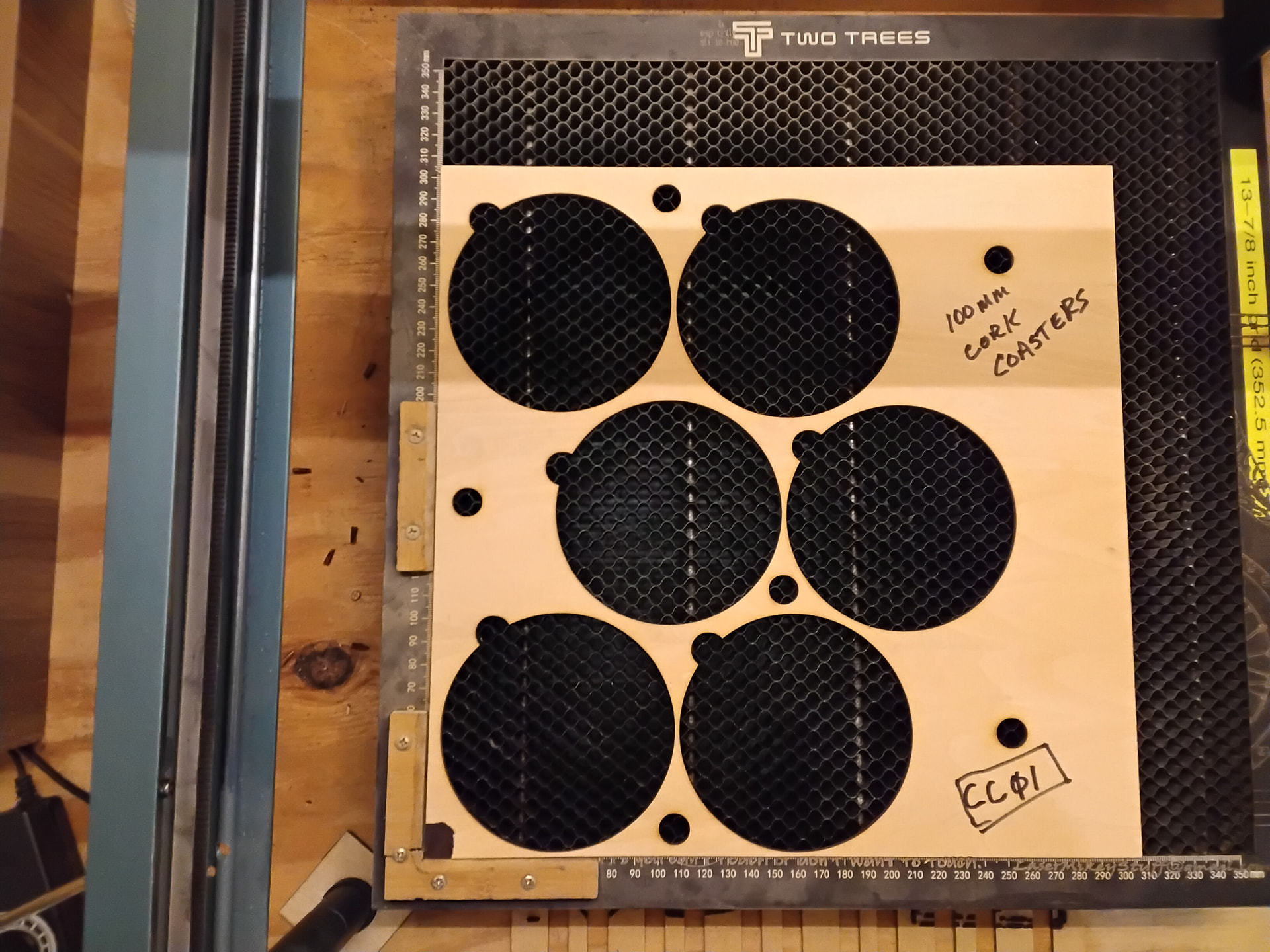

Tim, I had same issue. Zero as you did then jig where ever you want. After jogging always go home before telling it to go to XY zero. Works every time for me and then once I go back to XY I use current position not absolute position. Learned this trick in V-Carve and it also works in LightBurn
Or stay with Absolute Coords and have your design location match the jig location. Then there is no need to use a goto or set an X&Y zero after you Home the machine.
I use my part program to create the jig and then it always matches. I locate the jig in the front left corner of the honeycomb. I load the program, put text in the circles, load the fixture with product, and hit start. Of course, the laser frame and honeycomb must be secured so they cannot move.

I am not at my machine now so I cant really tell details now. I found that MillMage was sending wrong codes when I clicked xy zero. It would always go close to workpiece zero. It didn’t matter whether it was center or bottom left corner. . I finally figured it was off the same amount as machine home was from the limit switches. I found the correct codes online and put them in a macro. And it works every time. I realize it could be some setting I changed in Millmage but I am not sure where.
